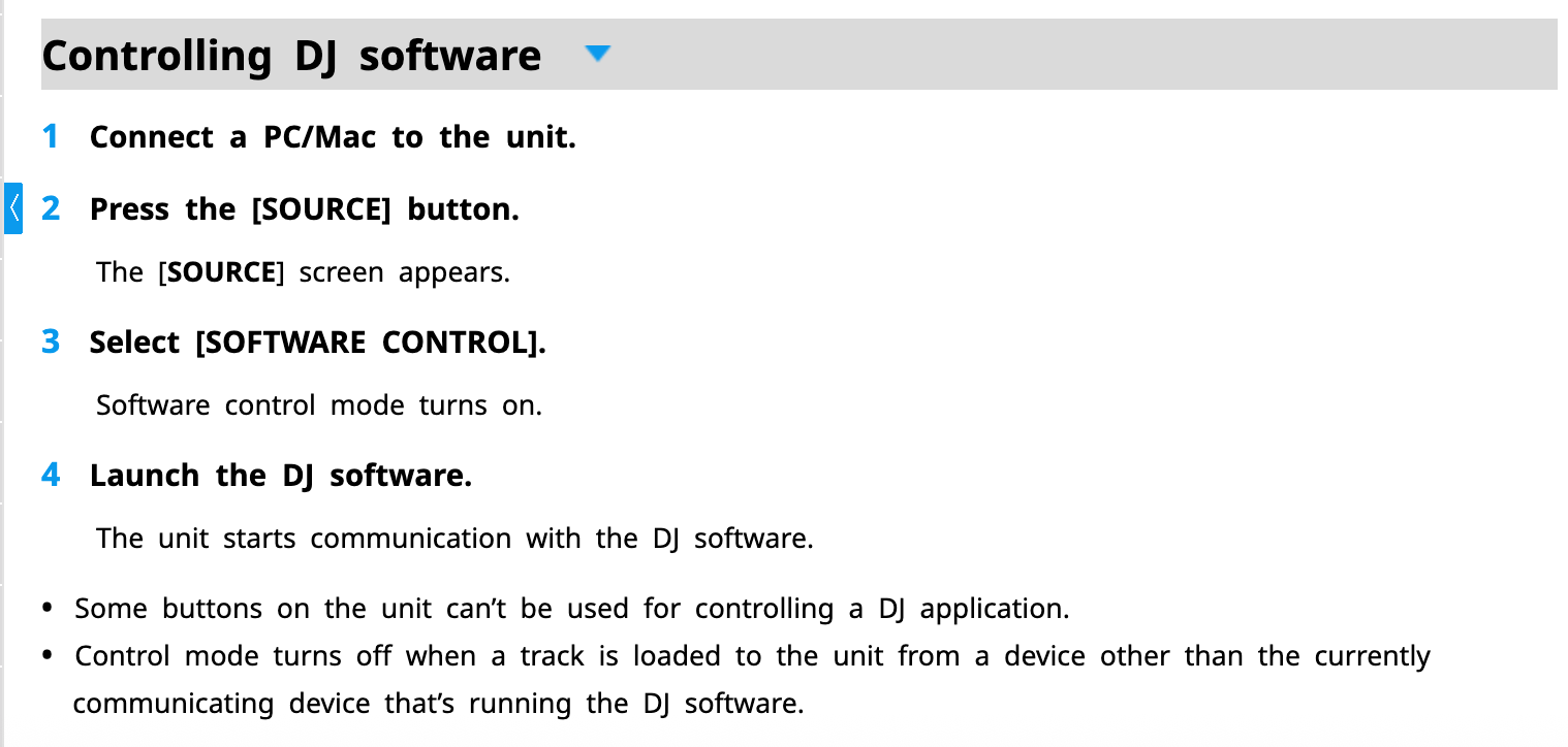

After pressing the [Source] button, is [Software Control] available?
from the CDJ-3000x manual
Of course I do this.
But djay decks never appeared.
