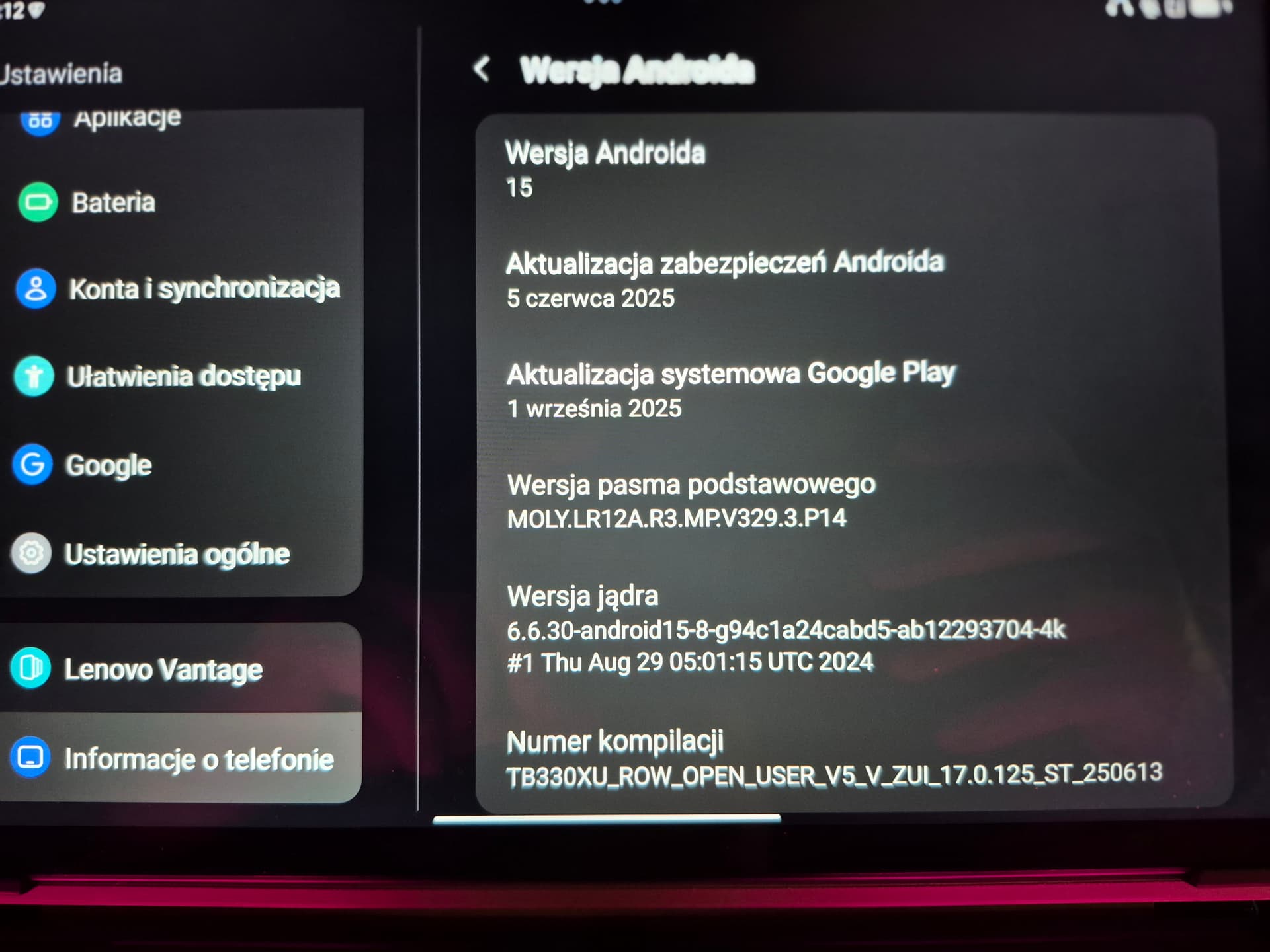

on V 5.5 with the last patch and the problem is still swimming SYNC when mixing, it helps to turn off KEY LOCK (blue note) please help, I have already reported the problem several times Slak_Jaw I checked various hubs and cables USB SYSTEM ANDROID 15 LENOVO M11 controller RELOOP BEATPAD 2 controller

I’ve tried lots of different Android tablets with djay over the years and the ones with Snapdragon processors seem to work the best with controllers etc. All the ones I tried with Mediatek or Exynos processors seemed to have various issues.
