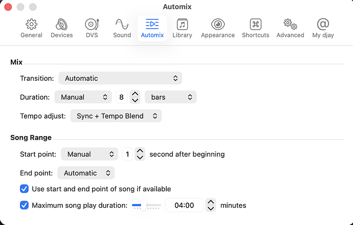

  2. Can you please also share screenshots of your Automix Settings? Thanks!

  2. In your Automix Settings, please try setting the Tempo adjust->Sync instead of Sync+Tempo Blend.
sync works fine without automix. issue fixed when changing to just sync, but now it doesn’t auto adjust the tempo of tracks back to 0. set it to automatic, and no-sync in automix issue returned
