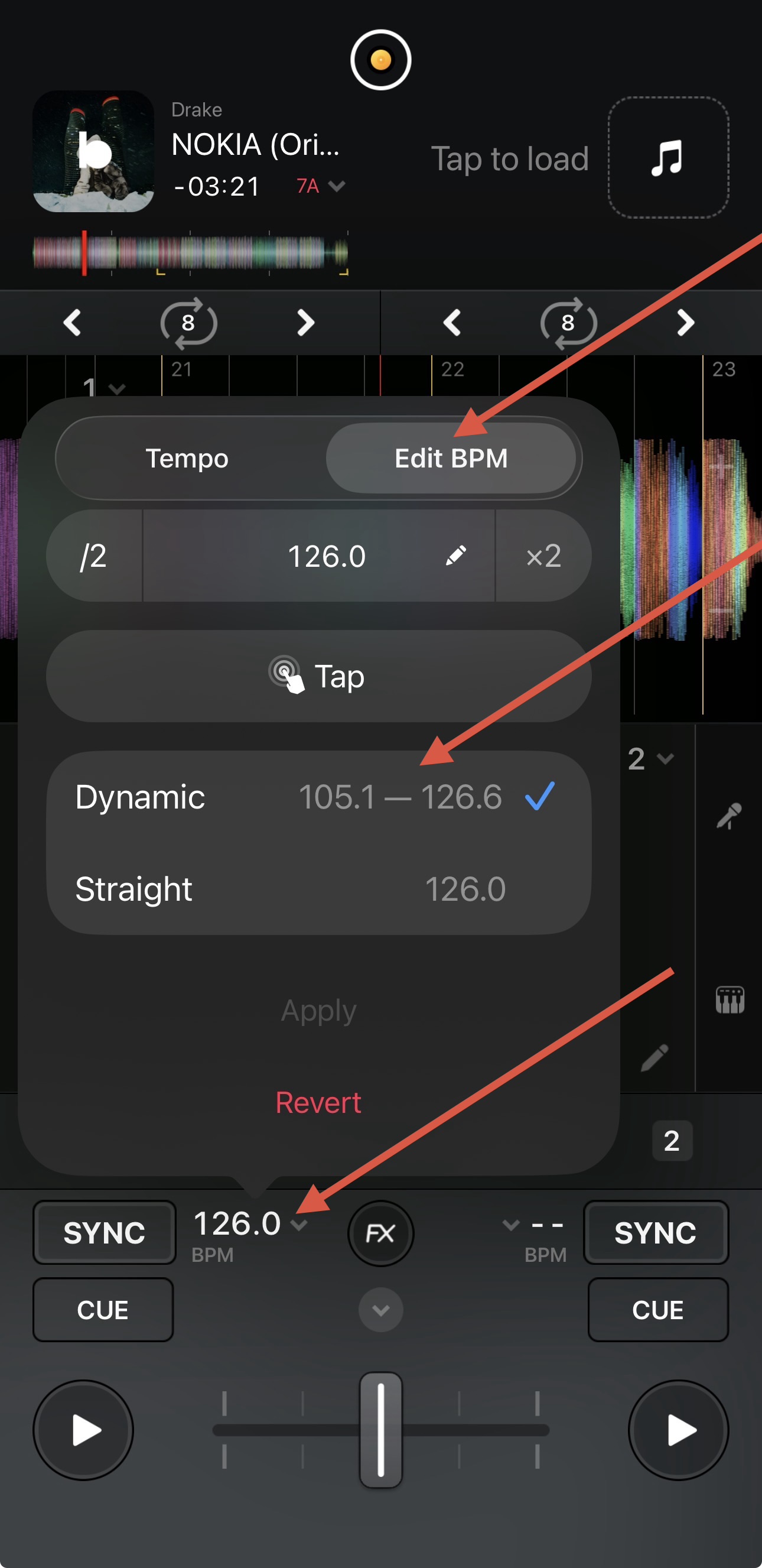

  4. Can you please check if the songs used in your video are Dynamic BPM or Straight BPM?

  4. Second track (Alice Merton) is dynamic (114.4-117.3), first is straight, and as I understand, problems are always with dynamic bpms, not only these tracks, but I had opportunity to film these
