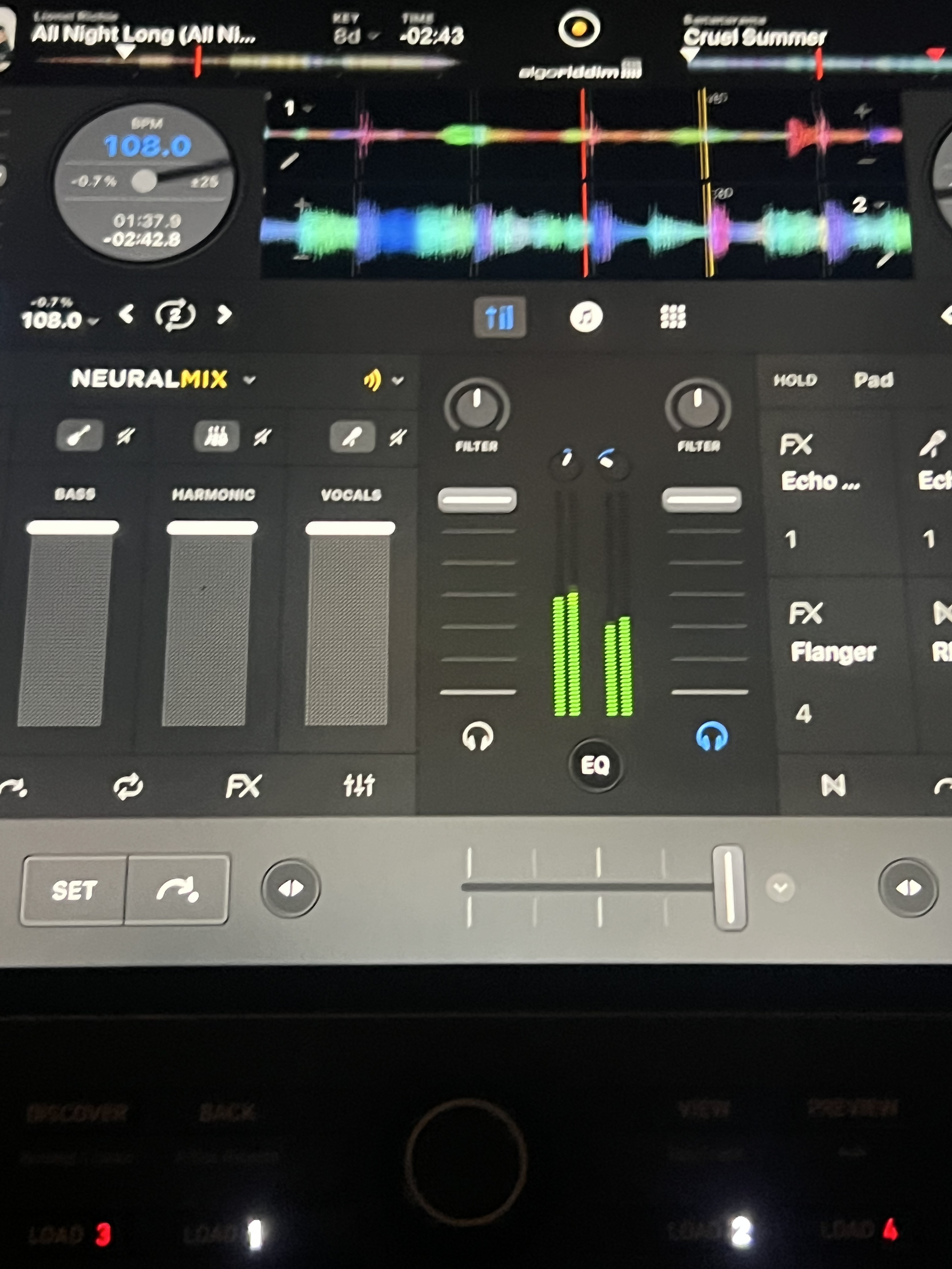

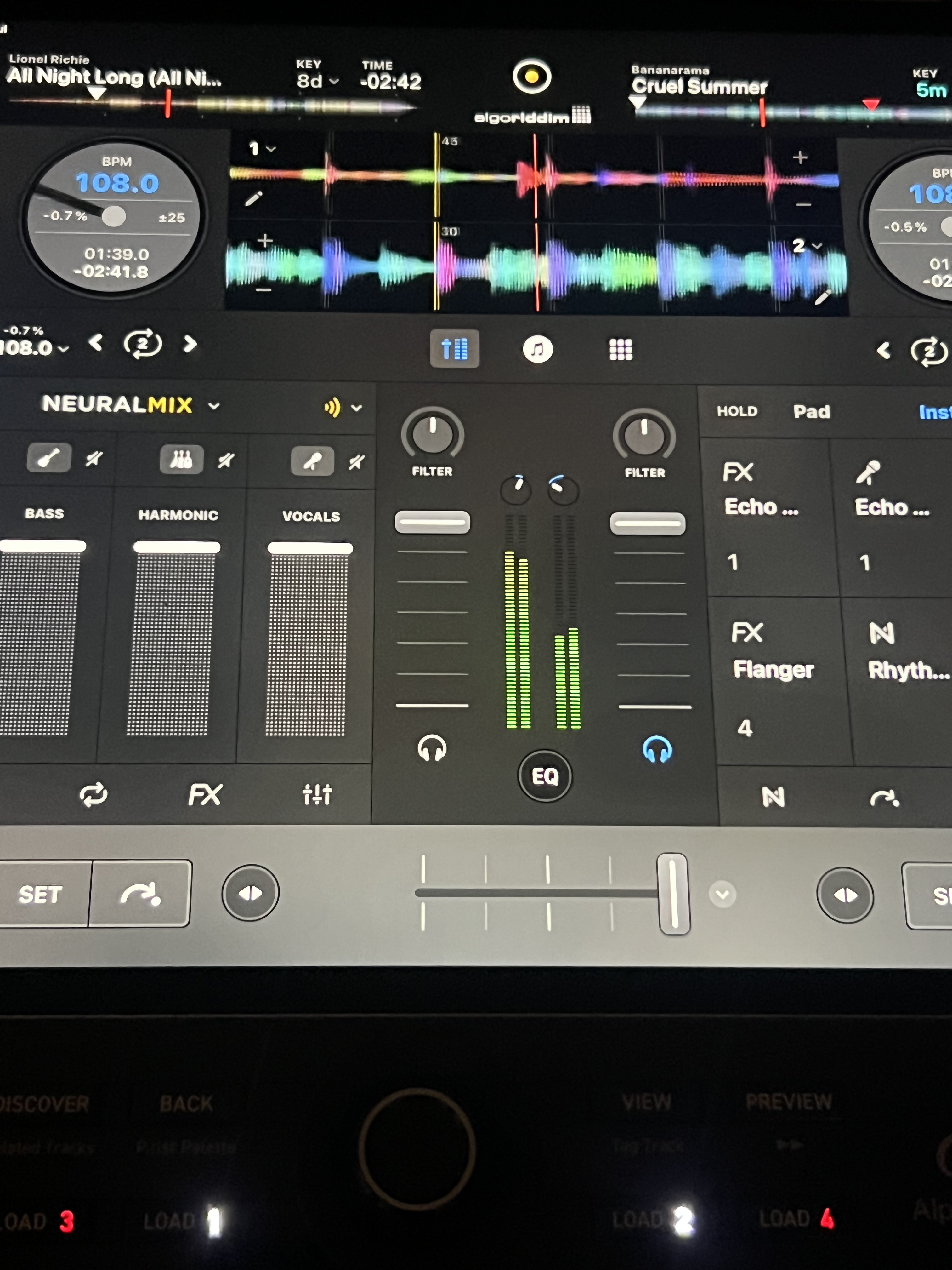

In the video I shared, Deck 1’s Gain knob was set very low, almost to zero — but during playback and especially during transitions, the volume was unexpectedly loud. This behavior is inconsistent with what I’d expect from that gain setting Auto Gain
:white_check_mark: Yes, I’ve been using Auto Gain in djay Pro.
:cross_mark: I also tested with Auto Gain disabled, and the volume jump still occurred — especially when transitioning from Deck 2 to Deck 1 using “Mix Now” or the manual crossfader. So the issue doesn’t appear to be caused solely by Auto Gain.Manual Gain Control
I did not touch the Gain knob manually during transitions in the video. I only adjusted it after hearing a volume spike to try and control the sudden jump. This confirms the behavior is not due to real-time controller input.

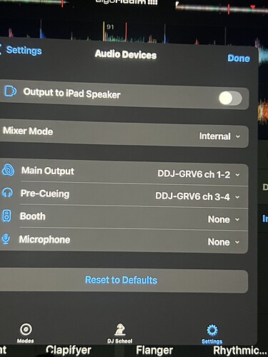

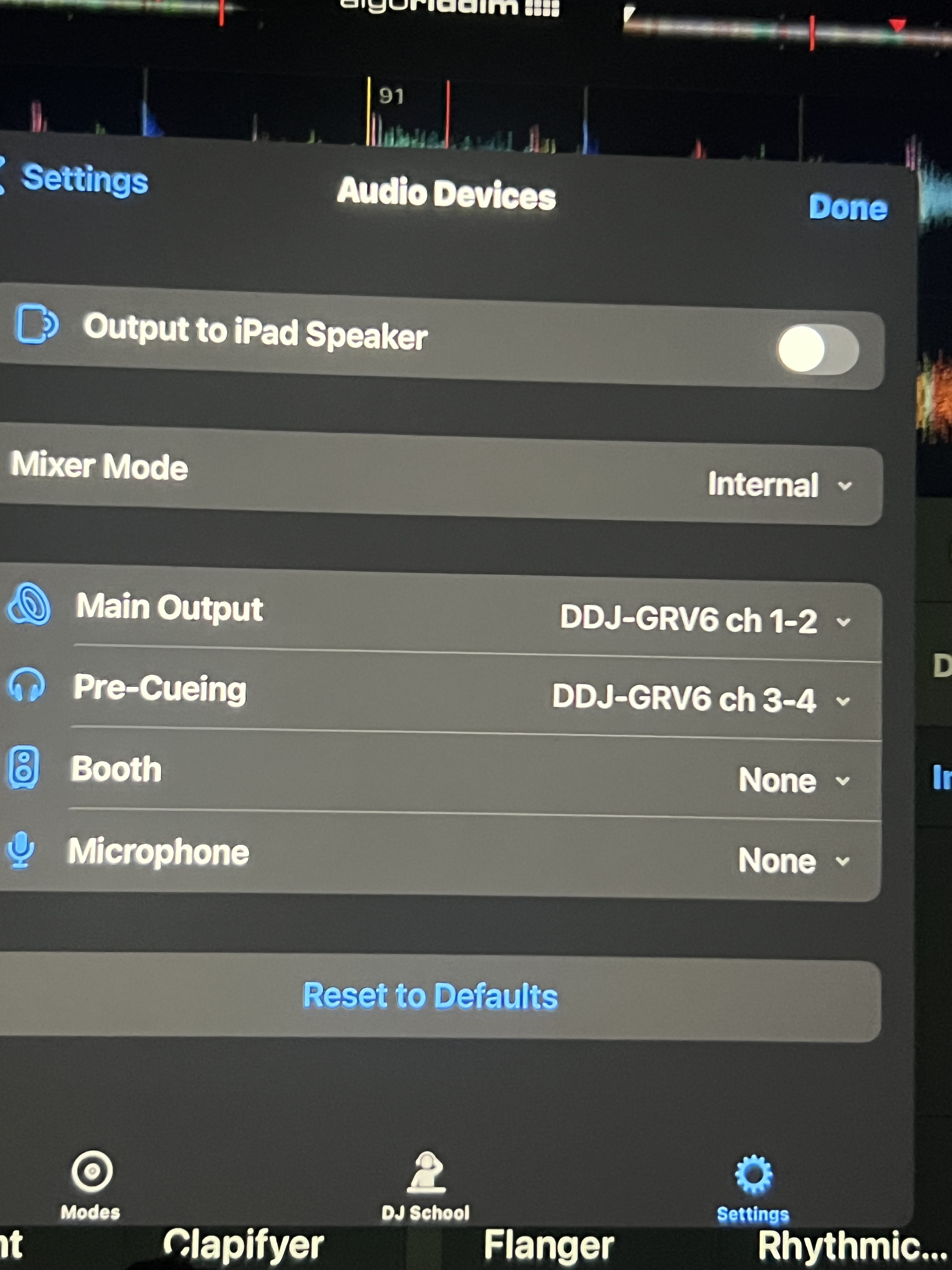

• Audio Device Routing:• Mixer Mode: Internal
• Main Output: DDJ-GRV6 ch 1–2
• Pre-Cueing: DDJ-GRV6 ch 3–4
• iPad Speaker: Disabled
• Booth/Mic: Not in use

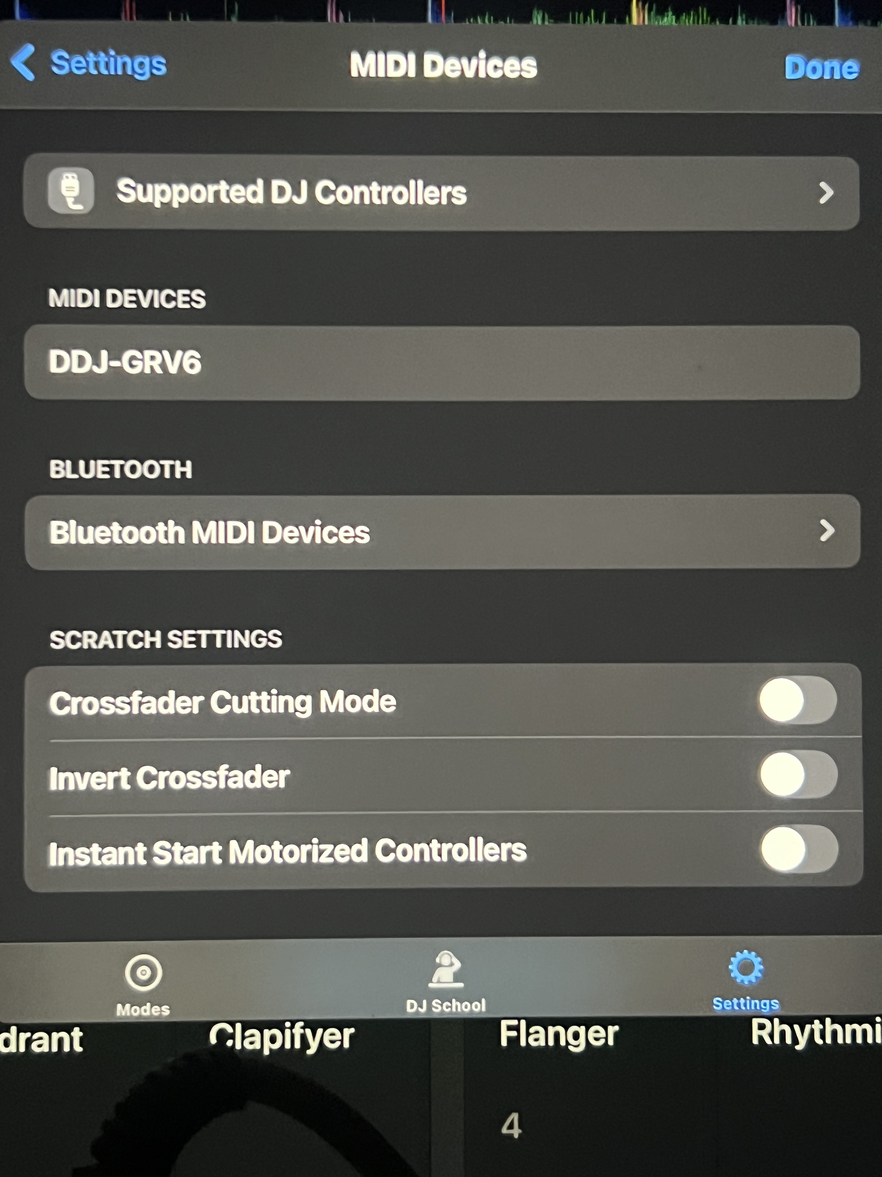

• MIDI Device Status:• DDJ-GRV6 fully connected and recognized
• Scratch Mode enabled, default FX settings used
