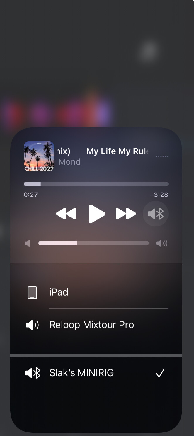

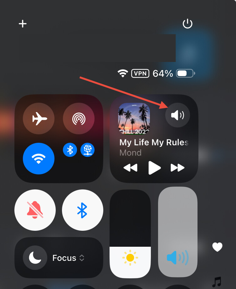

Hi @Lacoda, while djay is running and connected to your FLX4 via USB cable,
  1. Swipe down from the top right side of your iPad and select the speaker icon
  2. Then choose your Bluetooth speaker for audio output instead of the FLX4

My suggestion above assumes the FLX4 is connected to the iPad via USB, while the speaker is connected via Bluetooth. I would not recommend dual Bluetooth connections on iOS.
Yes. USB iPad flx4 and Bluetooth speakers. Thanks
@Lacoda, did the instructions above work then?
If I had asked sooner… I wouldn’t have missed the opportunity to use this great feature, thank you very much!
