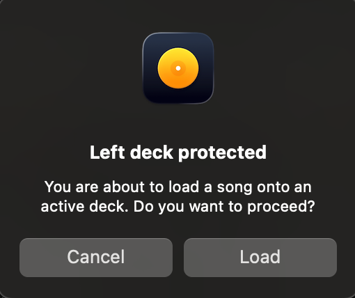

Cancel track loading message with controller
**YOUR SUGGESTION:
Id like to suggest that when prompted to load or cancel when trying to load to a track that is already playing, we should be able to use the controller to press cancel. Now we’re stuck with using a mouse or trackpad to press cancel. This can be a problem when performing live.**

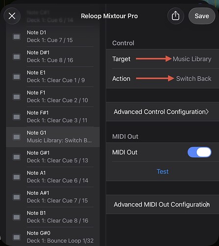

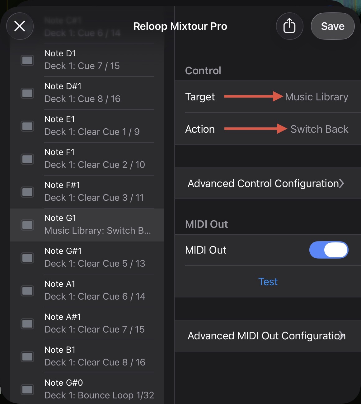

Hi @Johan_Rosenberg and @Michael_Wisniewski,
@STU-C is correct. I’m not sure how this is mapped on the FLX4, but you can easily custom MIDI map this to a free button on your controller (see details below). This will cancel the onscreen message.
Oops, I was referring to cancelling this error message.
@Michael_Wisniewski the Switch Back MIDI command should work to cancel this message. At least it does in my testing on iOS.
Couldn’t you just avoid the popup asking to delete or load a new track, with a warning that you can’t load a new track if the deck is in play mode? It’s like this on all software, something non-invasive.
