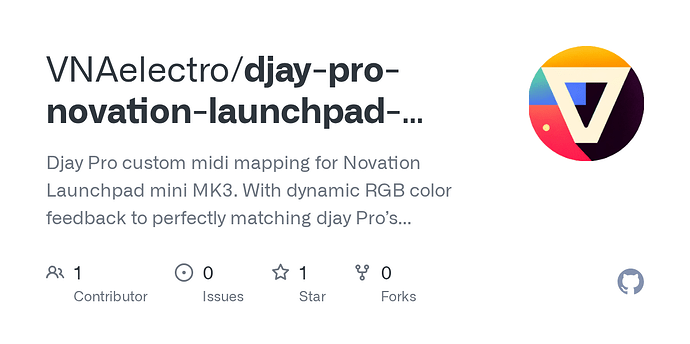

I’ve been diving deep into a fun project and wanted to share it with you all. Like many of you, I love djay Pro but wanted to expand my pad control without breaking the bank. I picked up a Novation Launchpad Mini MK3 and discovered something cool - you can actually get it to display your custom cue point colors dynamically!
The tricky part was figuring out how to make those beautiful RGB colors from djay Pro actually show up on the Launchpad pads. Standard MIDI mapping only gives you basic on/off states, but I wanted the real deal - proper color sync with my cue points.
After some XML file wizardry and reverse-engineering, I managed to do it! Now my Launchpad lights up with the exact same colors I’ve set for my cues in djay Pro.
If you’re curious about the setup or want to try it yourself, I’ve put everything up on GitHub with the config files and step-by-step instructions. Would love to hear if anyone else gives it a shot:
