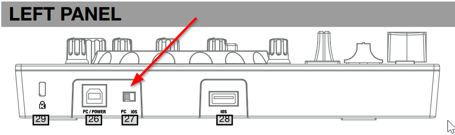

I have looked through forums and google but no luck. I have upgraded my cables and tried switching from IOS to PC with the little switch on the side.

  5. Connect your DJ controller to the USB hub using a high-quality USB cable (ideally with dual ferrites on either end). I recommend that you use the PC/Power USB-B port on the side of the Buddy. Make sure the switch is set to PC to match the USB port you are connected to.

I then unplugged the hub and plugged in the cable from the Reloop Buddy straight to the iPad and it acknowledged it right away after moving the switch back from pc to ios. So it’s not a cable issue and the hub is brand new.

I did it! I had the usb b cable plugged into a power adapter as well but you are supposed to plug the cable into the usb hub. I thought the hub and Reloop Buddy had to both have separate power sources but it turns out the RB gets its power from the hub too.
