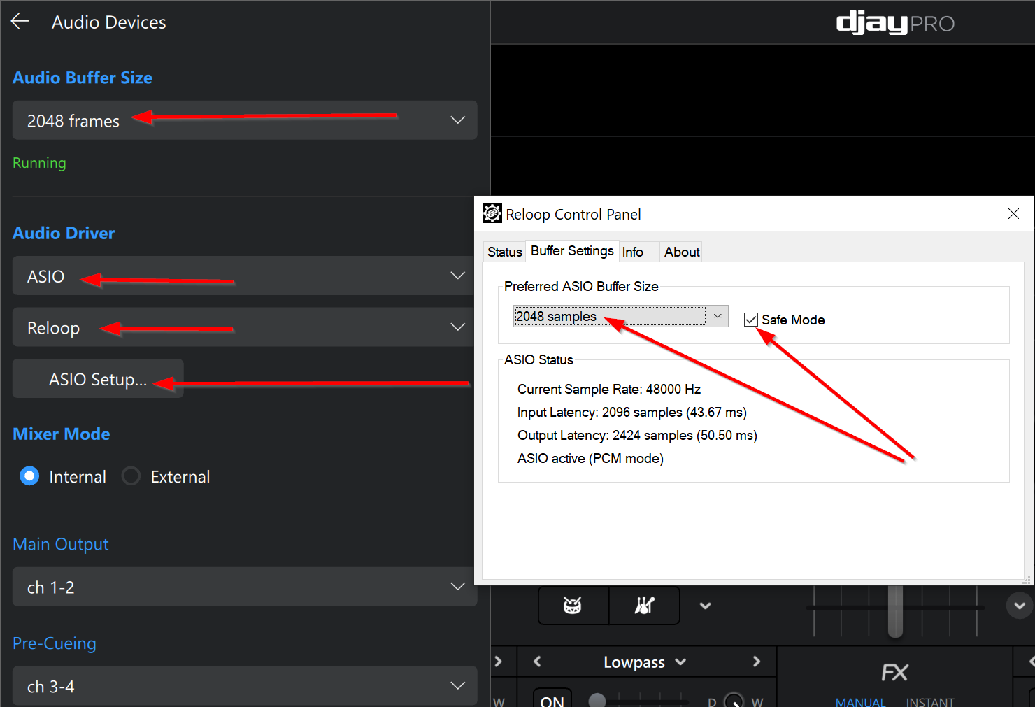

Hi @Pontus_Eliason, welcome to the Community! Sorry to hear you’re experiencing this issue. This really sounds like a hardware performance issue.
  1. I recommend that you use the ASIO Audio Driver that you downloaded from Hercules DJ.
  2. Start by setting the Audio Buffer Size to the maximum available. On my setup, this is 2048 frames. This will put the minimum load on your system, but will also result in the maximum latency.
  3. If available on your setup, select the ASIO Setup… to reveal additional options and make sure Safe Mode is enabled.
  4. Retest with these settings and if the crackling is gone, then try decreasing the buffer size and retesting until the crackling returns. Once you determine the minimum buffer size your system can handle, set is 1 or 2 levels above that.
  5. If you still get the crackling sound at the maximum buffer size, then I recommend you try a high quality USB cable with dual ferrites on either end - I personally recommend the Chroma Cables by DJ Techtools.
  6. Also, avoid using any low quality USB adapters or hubs in your setup if possible as these can cause problems as well. Direct connection with a single cable between your DJ controller and Samsung device is best.
  7. Please also make sure the T7 is connected to a reliable, properly grounded, power source (don’t use cheap power bars), with the supplied Hercules DJ power supply.

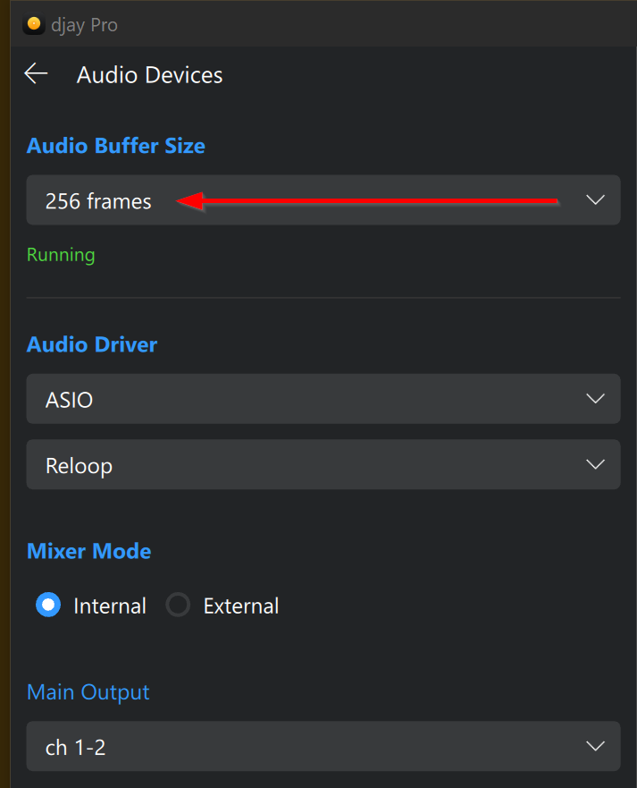

Hi @Pontus_Eliason, we believe we may have discovered the source of the issue. As a temporary workaround, please try setting the Audio Buffer Size to 256 frames and let me know if that helps. Thanks!

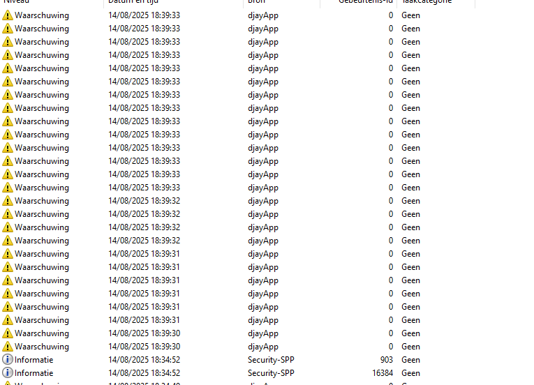

This happened to me too, ive been using djay a LOT and it just happened with this update.
Also, in event log you can see a ton of warnings from the DJay app now that I never got before.
Thanks for the additional info @mvz. Our team is aware of this and is working on a fix. In the meantime, the temporary workaround as recommended above, is to set the Audio Buffer Size to 256 frames. Do not try using other buffer sizes even if they are higher. The workaround requires the 256 frames setting. I hope that helps!
