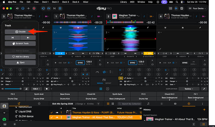

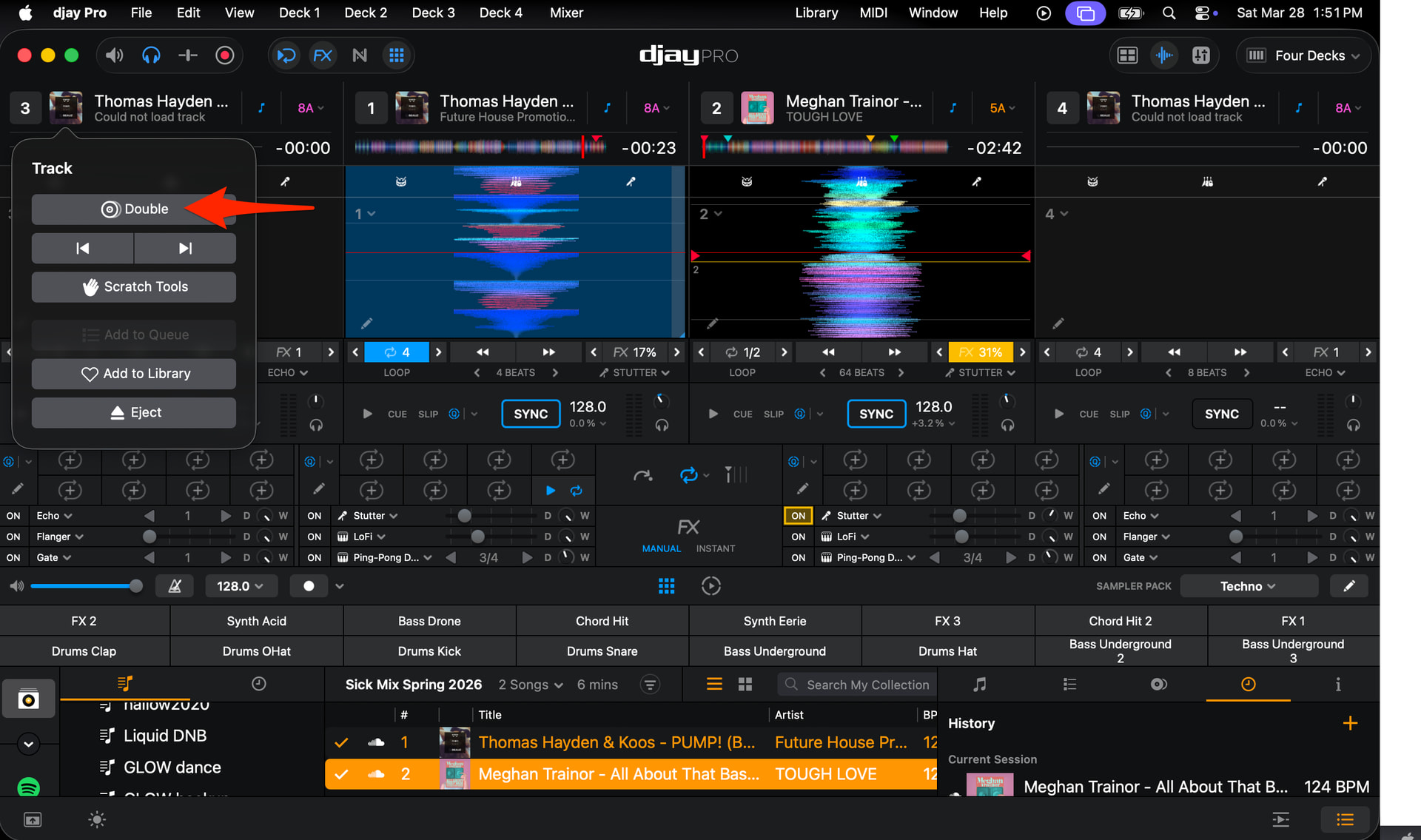

  • When Deck One is playing a loop or stopped with a loop selected for a SoundCloud track, and I try to create a double on another deck, it says “Cannot load track.”
  1. Load a SoundCloud track in the Active Deck in 2 deck mode. Play the track, select a 4-beat loop
  2. Switch to 4-deck mode.
  3. Click on the plus symbol or right-click on the album art icon at the top of the track.
  4. Select “double”.

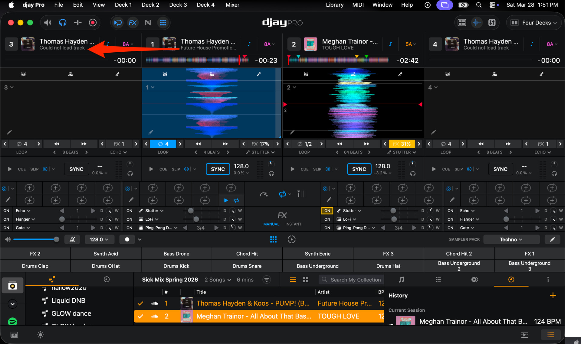

D) ACTUAL RESULTS:
  • Track title appears, underneath it “could not load track” message shows.

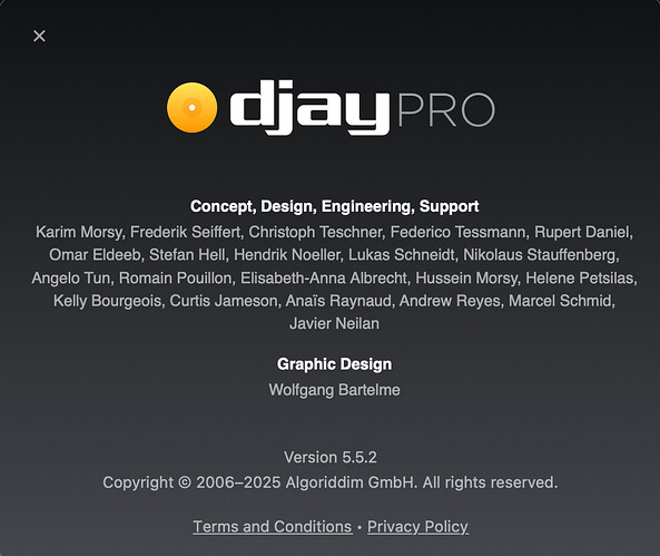

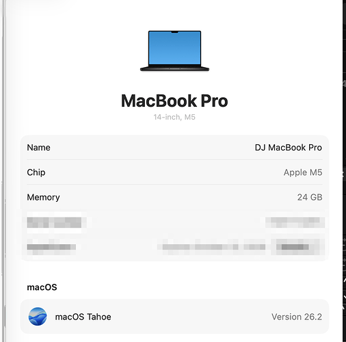

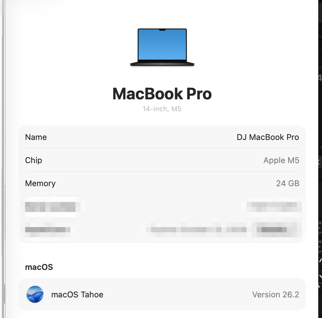

System info:
To note: creating doubles of local tracks works fine.This appears to only affect SoundCloud tracks.

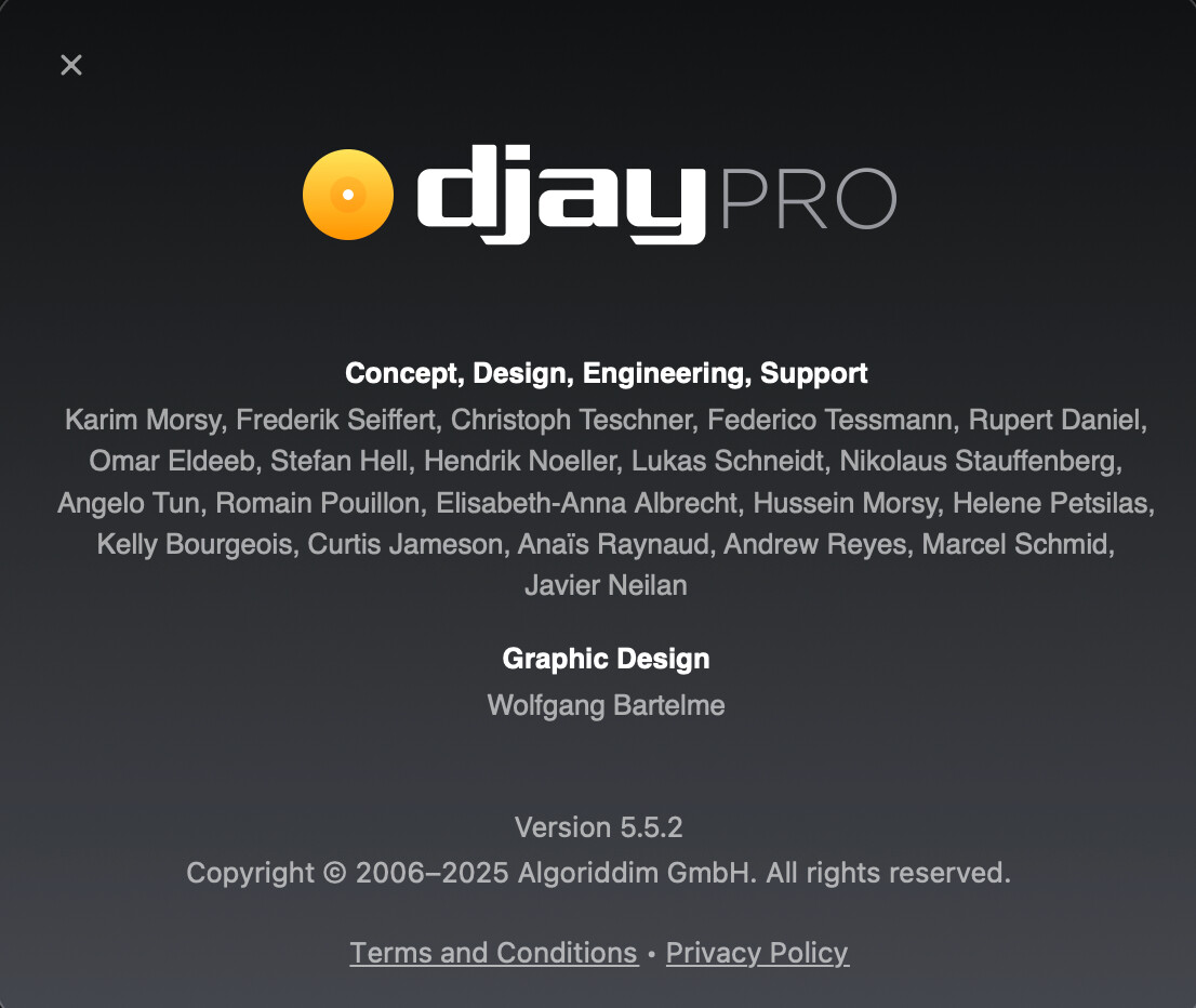

After update to v.5.6.1 and restart, the issue appears to be resolved.
