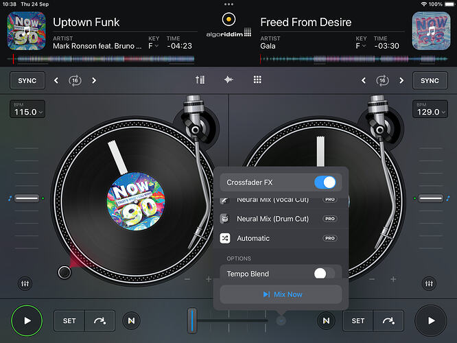

Recently, the crossfader FX are always activated for me after starting Djay on a current iPad Pro M4. This is not the case on an older iPad. I have not found a corresponding option in the settings, but maybe I just overlooked it. Can anyone give me a tip on this?

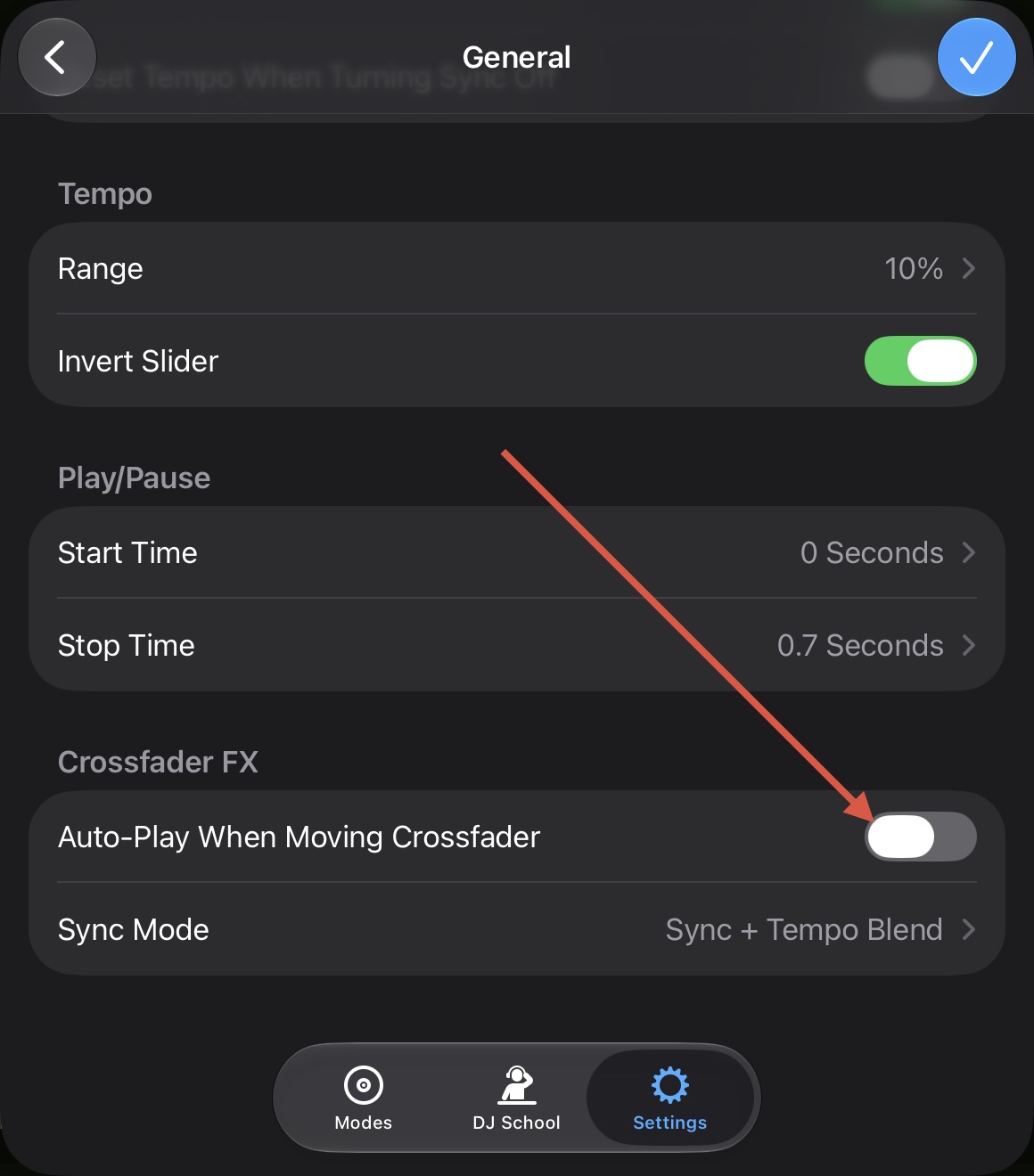

Hi @Chris_R, please navigate to the djay *Settings>General and disable Auto-Play When Moving Crossfader.

The crossfader FX are automatically activated when I start Djay. Even if I deactivate them, they are active again the next time I start Djay. What’s strange is that this is only the case on the iPad Pro M4; it’s not the case on the iPhone and an older iPad Pro.

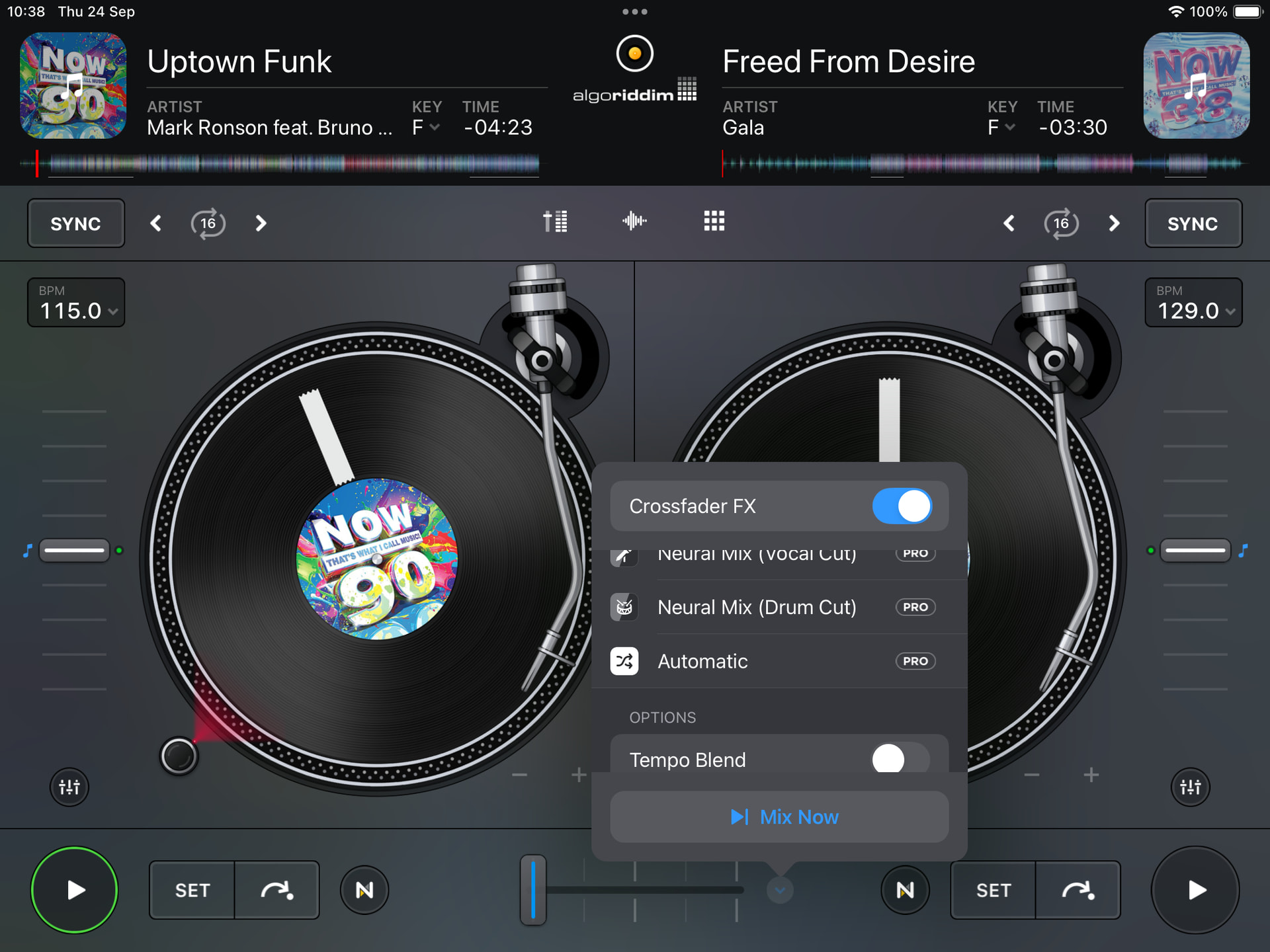

Crossfader FX turns itself back on whenever the app is restarted.
I don’t know how but its started doing this on my iPad from a few weeks ago.
I cant not have noticed this from months/years ago.
Hi @coffee_king, in the djay Settings→General→Crossfader FX please make sure Auto-Play When Moving Crossfader is disabled.
If this doesn’t work, please try updating djay to the latest version that was released earlier this week, 5.6.9. Thanks!
Hi
It seems that updating to 5.6.9 and adjusting that slider has now made it remember to not keep turning on Cross Fader FX. Thanks
