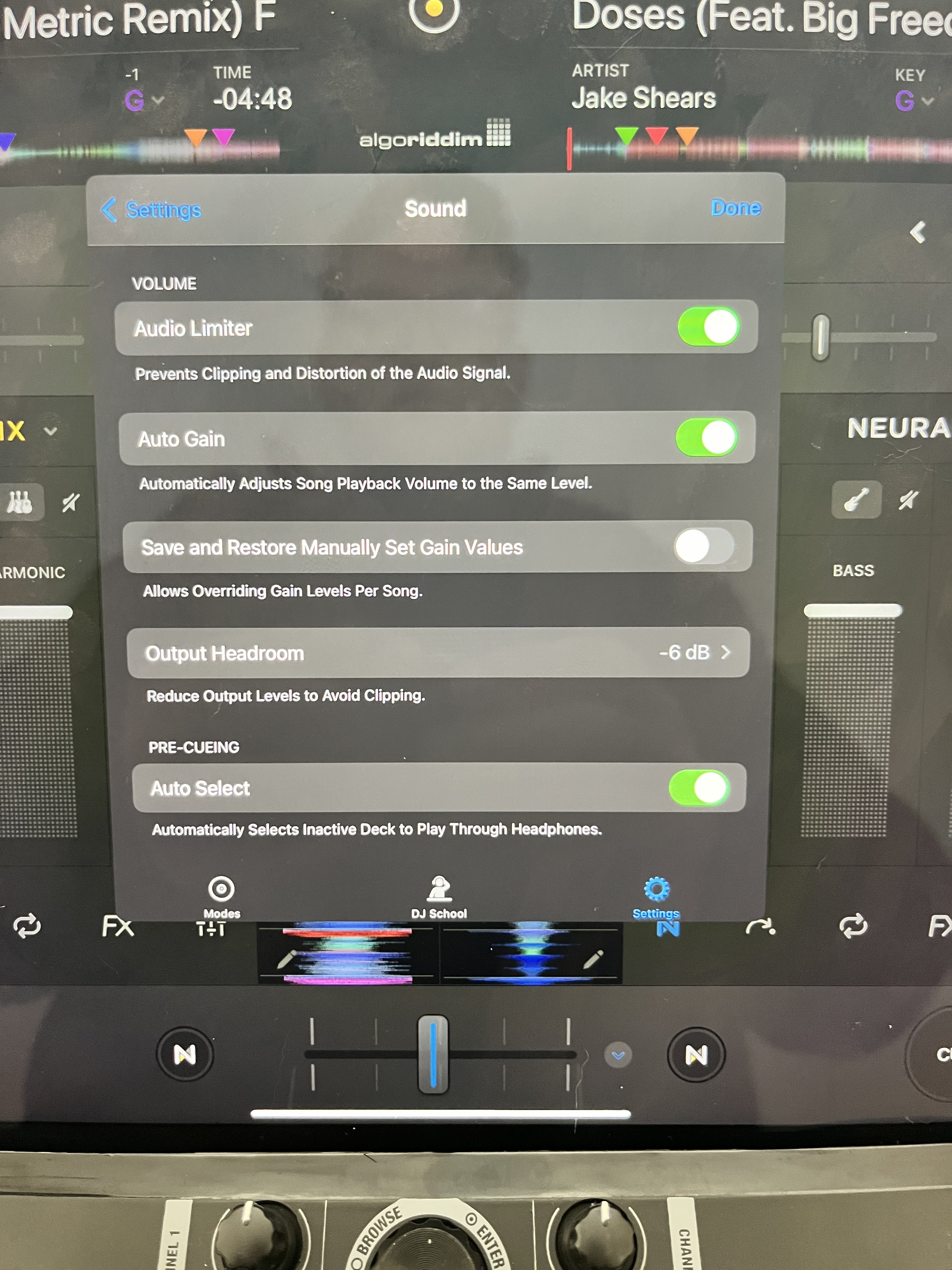

  3. In your djay Settings>Sound>PRE-CUEING, please turn OFF the Auto Select. Instead use the Headphone Cue buttons on the Buddy to manually perform your headphone cueing. I recall another user discovering that the audio level was rising when using Automix and this setting was on.

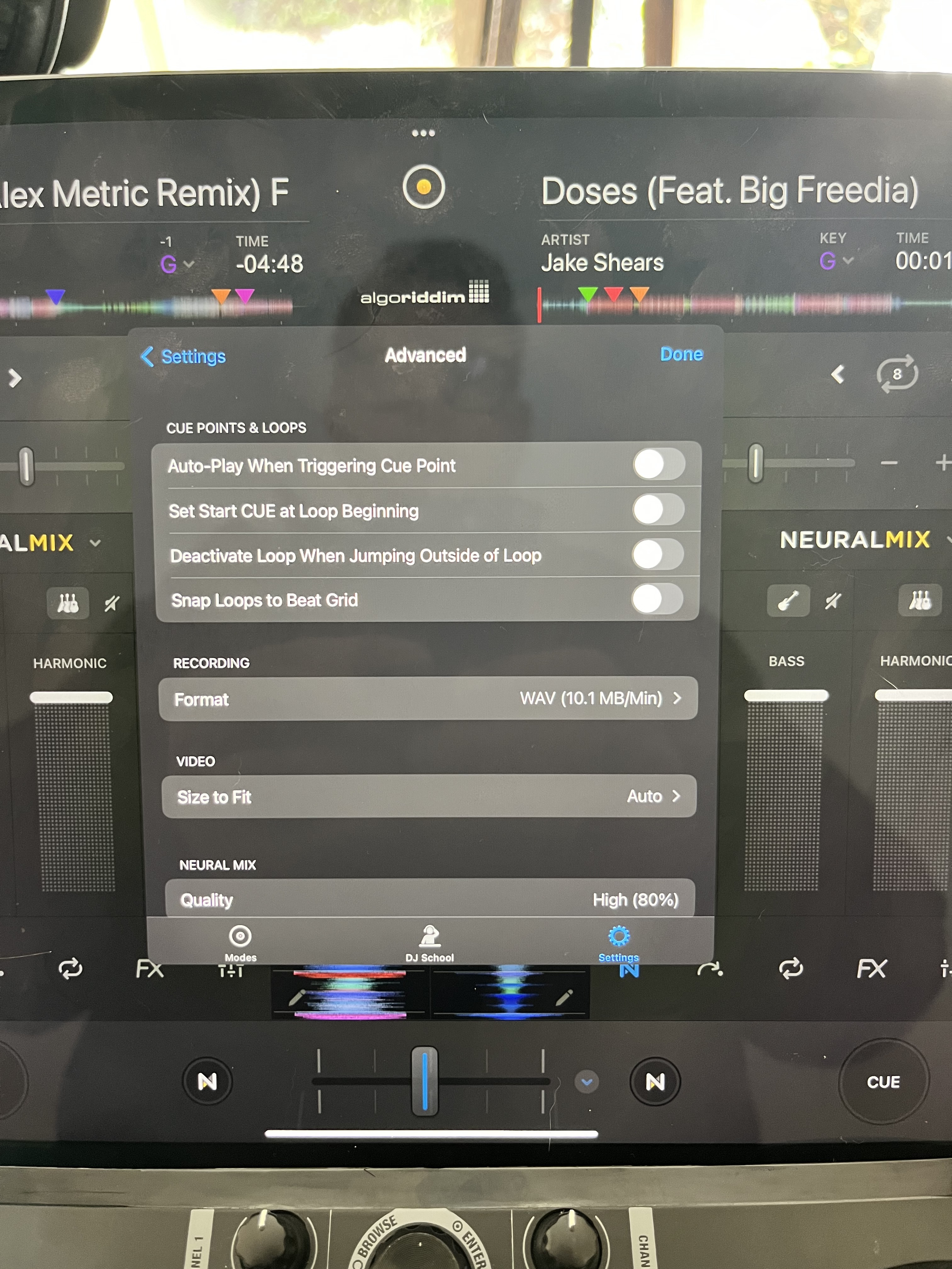

  4. As for the song jumping out of beat match when using Neural Mix, this can happen with older devices that are not powerful enough to hit 100% Neural Mix Quality settings. I see yours is at 80%. What happens in this case is it takes a bit longer for your device to process the STEMs separation in real-time. I’ve experienced this myself on older devices.
    a. The workaround is to force djay to calculate the STEMs separation when you first load a song to a Deck instead of relying on real-time separation.
    b. You can do this simply by moving any of the onscreen Neural Mix Volume controls or Neural Mix EQ controls when you first load a song. This will perform the separation calculations before you start playing the song so that djay doesn’t have to do it in real-time while the song is playing. I hope that makes sense.
