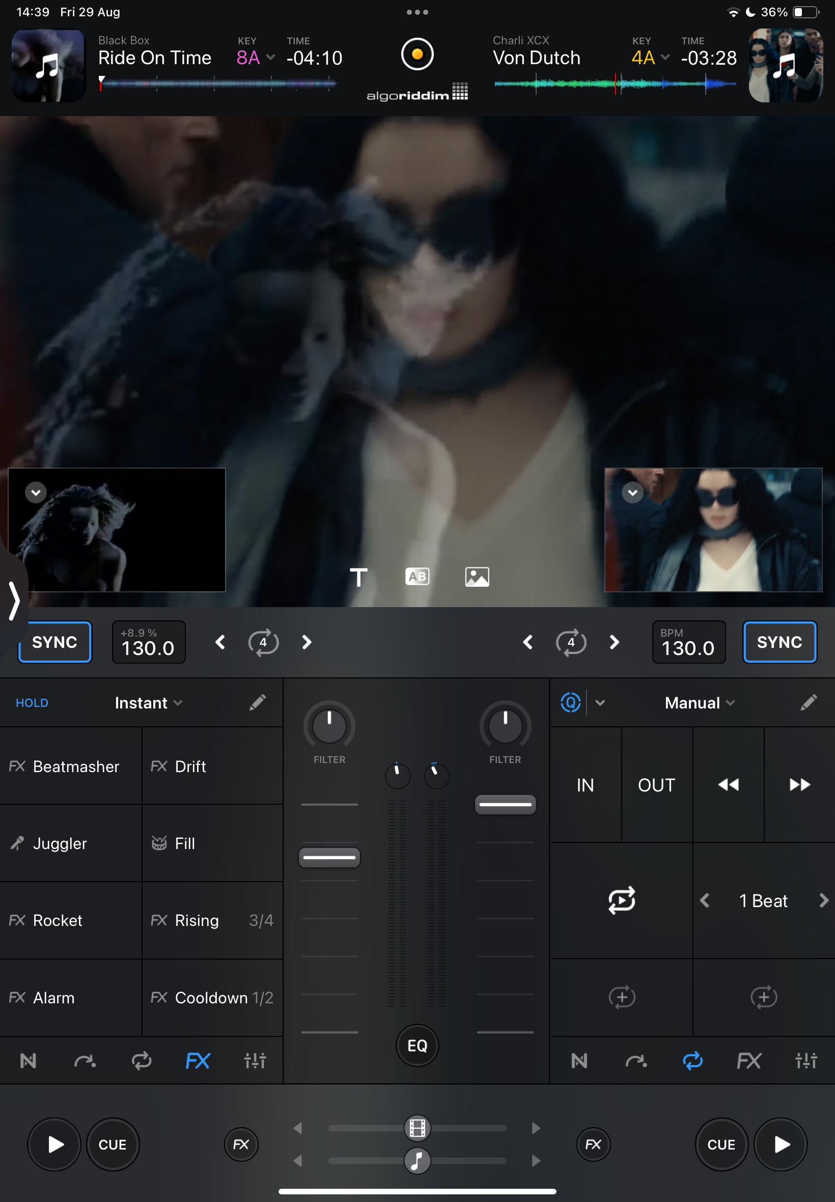

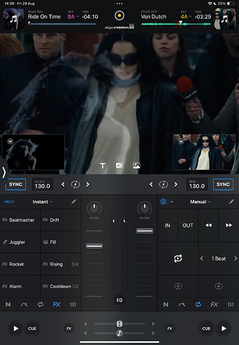

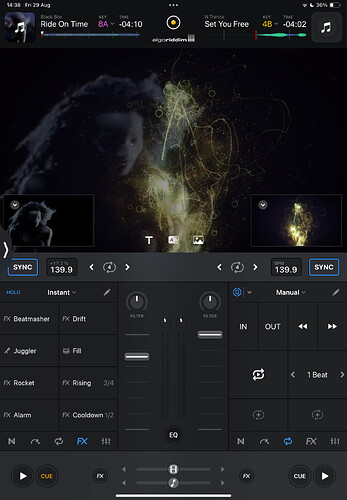

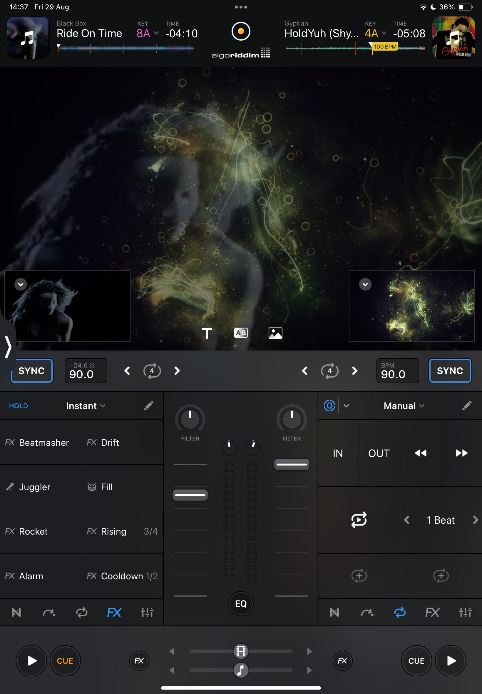

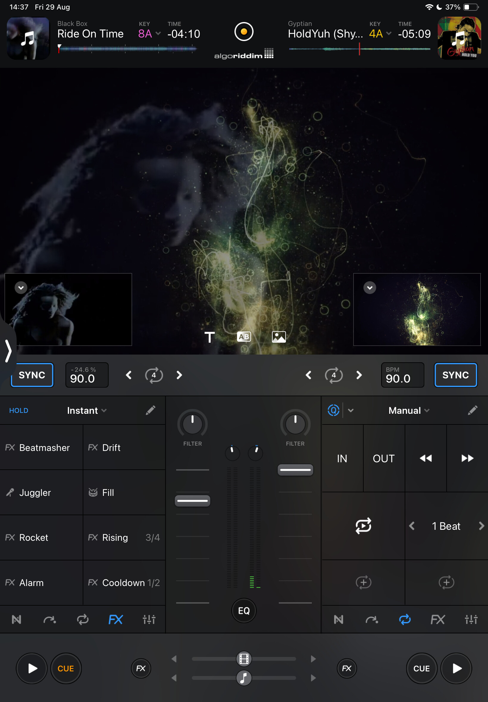

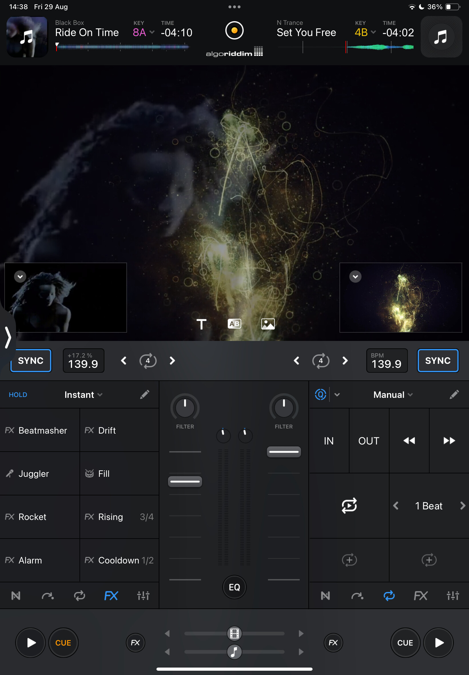

Pop a cue point in one the first vocal at 5.09
And it’ll get stuck at 5.08 and will always place it there.
A start cue at 4.02
Rewinds by a few frames to the start of the track
A 3.28 marker
Cues on a different beat at 3.29

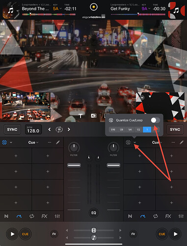

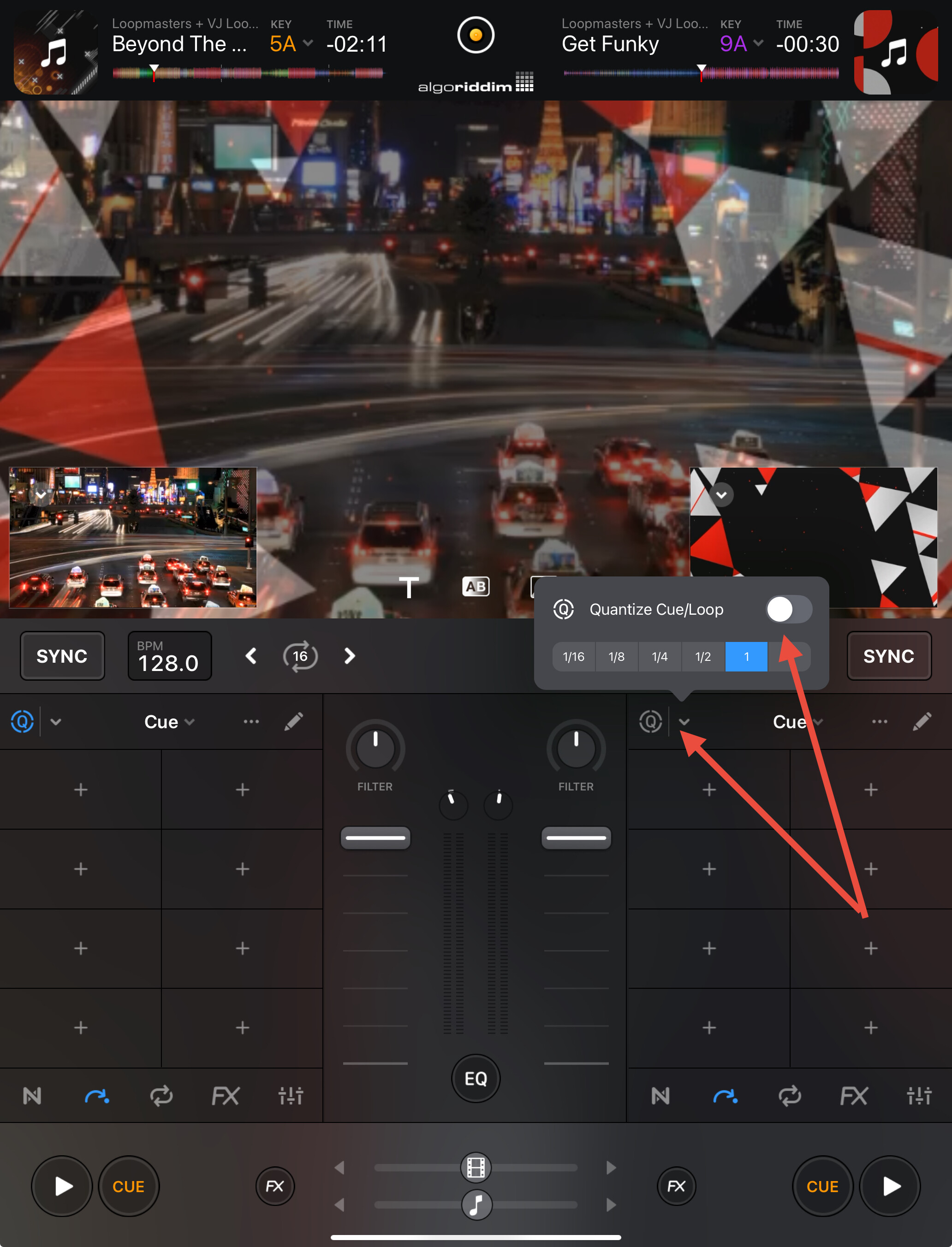

Thanks for the screenshots @djandrewmarston. Do you experience the same issue if you set the temporary cue in Classic or Pro Mode instead of in Video Mode?
Also, do you experience this with Quantize turned OFF?
Thank you! Lifesaver. The quantise cue (granted - hidden in loops) was the cause.
