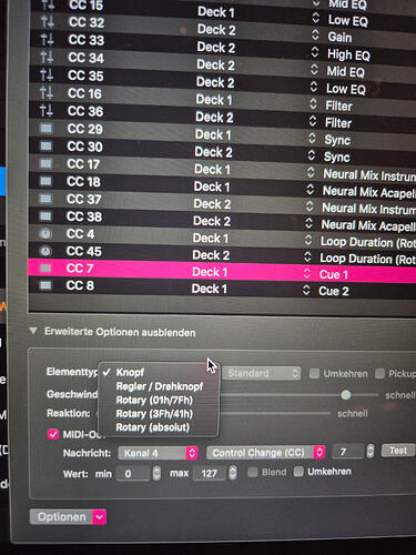

Hey there having troubles Midi Mapping my Traktor Kontrol Z2.
When I press the cue button on the mixer it acts like quantize is enabled meaning there is a big delay after pressing, when I hit the cue with Mac keyboard or directly on the screen there is no delay because quantize is already disabled!
I am shure if I could change the button type to something else it would maybe work somehow… hope anyone can help

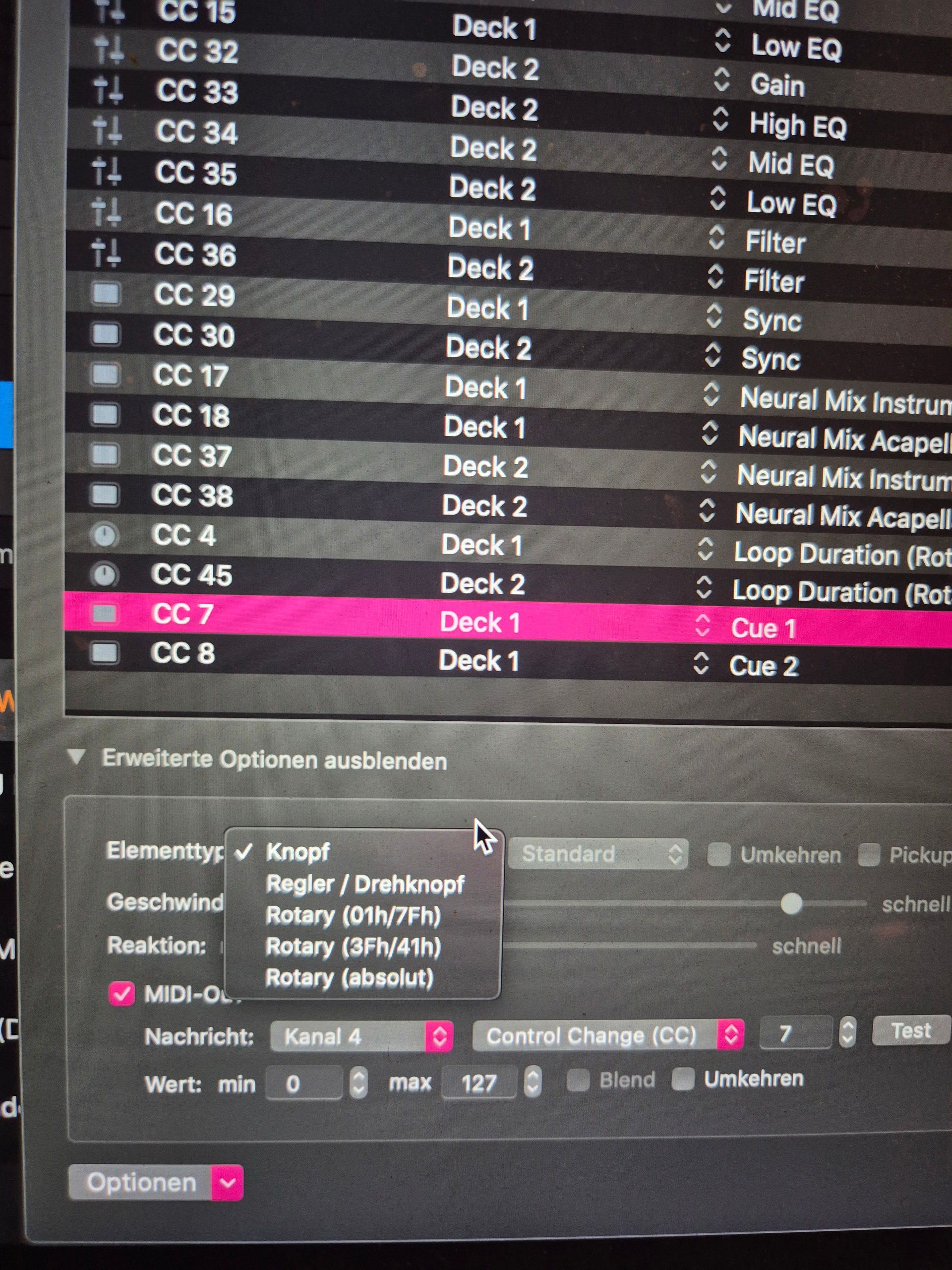

Hi @Cloony, welcome to the Community! Try setting this to Button instead of Knob.
It’s already on button, Knopf is just the translation from German…..
I don’t speak German, but it sounds like you have the button type set to Toggle instead of Momentary.
I found the solution :see_no_evil_monkey: I had to change the button type in the NI controller editor first, I was not aware! Thank you
You’re welcome @Cloony. Glad we were able to sort it out.
