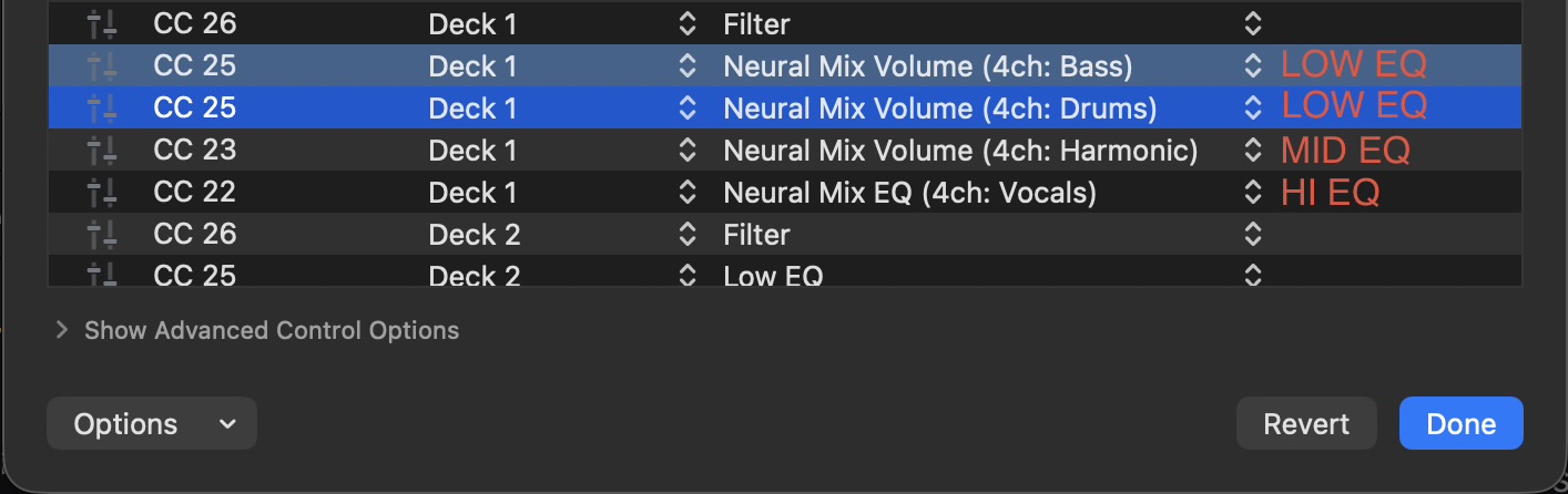

  1. If your hardware has a gain knob or filter that you don’t use, you can even map this to the 4th NM option.

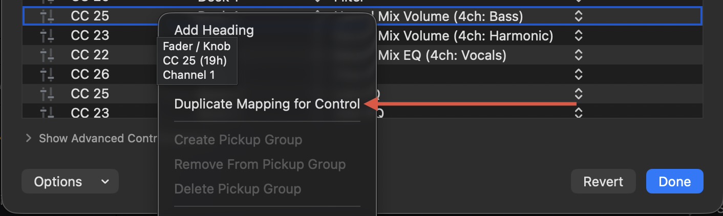

  2. Alternatively, you can use the R-Click menu option in the MIDI Learn tool to Duplicate Mapping for Control option to map both the Drums & Bass to the Low EQ knob.
thanks guys! knew you could change midi assignments but that dual assign is a game changer
