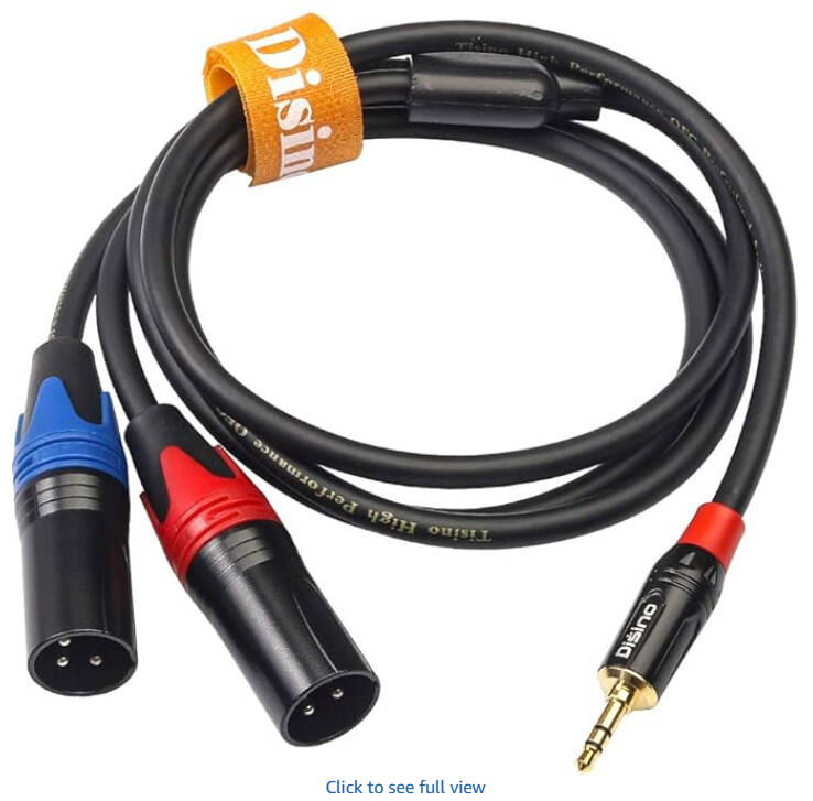

hello. to connect the DDJ flx2 from the mini jack with a speaker that has 2 channels XLR, do I need a dual XLR connector or a sinlge XLR connected to one channel? is there any mono / stereo issue?
Hi @Andres_Slullitel, welcome to the Community! When you say your speaker has “2 channels XLR” do you mean one is marked L and the other is marked R?
If so, you need a 3.5mm male TRS to Dual XLR Male stereo y-cable to get the full stereo signal into your speaker:
Here’s an example on Amazon: Amazon.com: Disino 1/8 Inch to Dual XLR Male Y-Splitter Cable,Unbalanced 3.5mm Mini Jack TRS Stereo to Double Male XLR Adapter Interconnect Breakout Patch Cord - 6.6 Feet/2 Meters : Musical Instruments
thanks for the prompt response!. it does not refer to L and R but to CH1 and CH2
You’re welcome @Andres_Slullitel. I would check the specs of your speaker then to determine if each channel is a mono or stereo channel. If they are 3 pin, then they are likely L/R mono channels - so the above cable is what you need. If they are 5 pin then each connector is likely a stereo channel (L and R in 1).
its 3 pin, so I assume is 2 mono channels. I will go with a 3.5mm mi jack to a single XLR
No @Andres_Slullitel, you actually need the y-cable that I shared above or you will probably lose half the signal.
