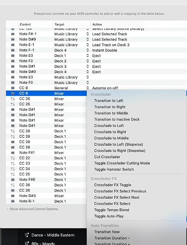

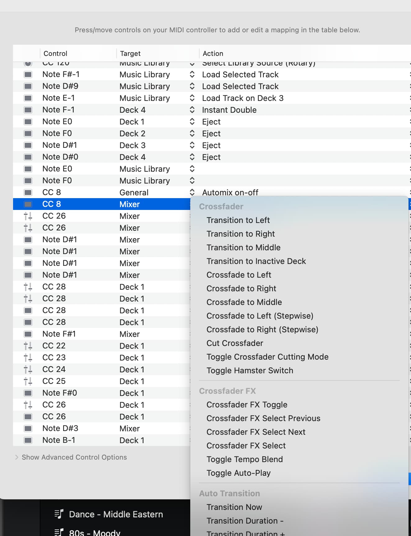

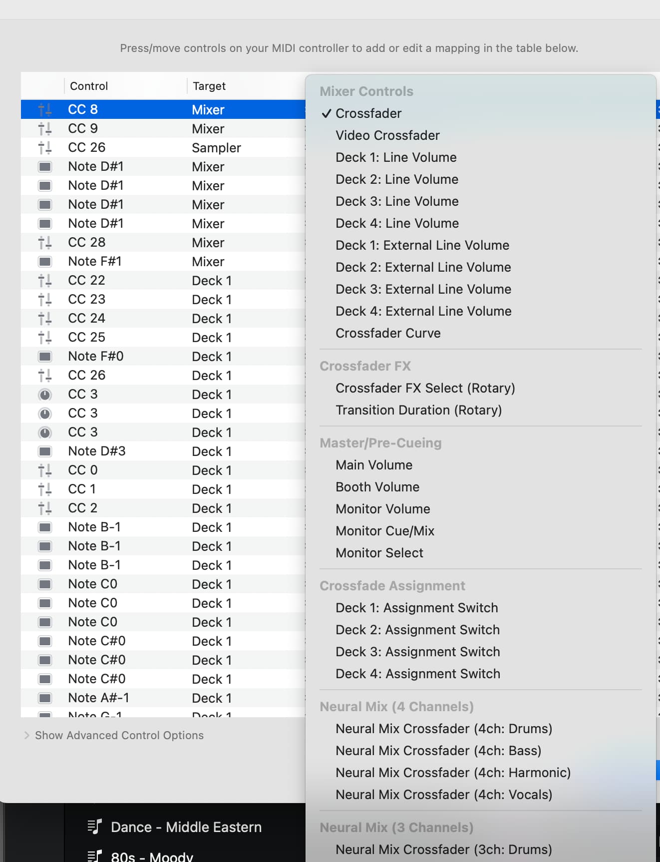

I ran into this issue and wish I had taken the time to read this thread before DELETING my crossfader midi mapping and now I can’t get it back, the midi mapping section called “Mixer Controls” is gone and I have no idea how to get it back. I could just revert to the default midi mappings again but I have hundreds of custom mappings that I’d have to recreate, any suggestions?
mixer controls shows up on default mappings:
if you have time machine enabled, you could revert back, before you made changes to your midi mappings.
also, always back up your midi mappings before you make drastic changes to it,

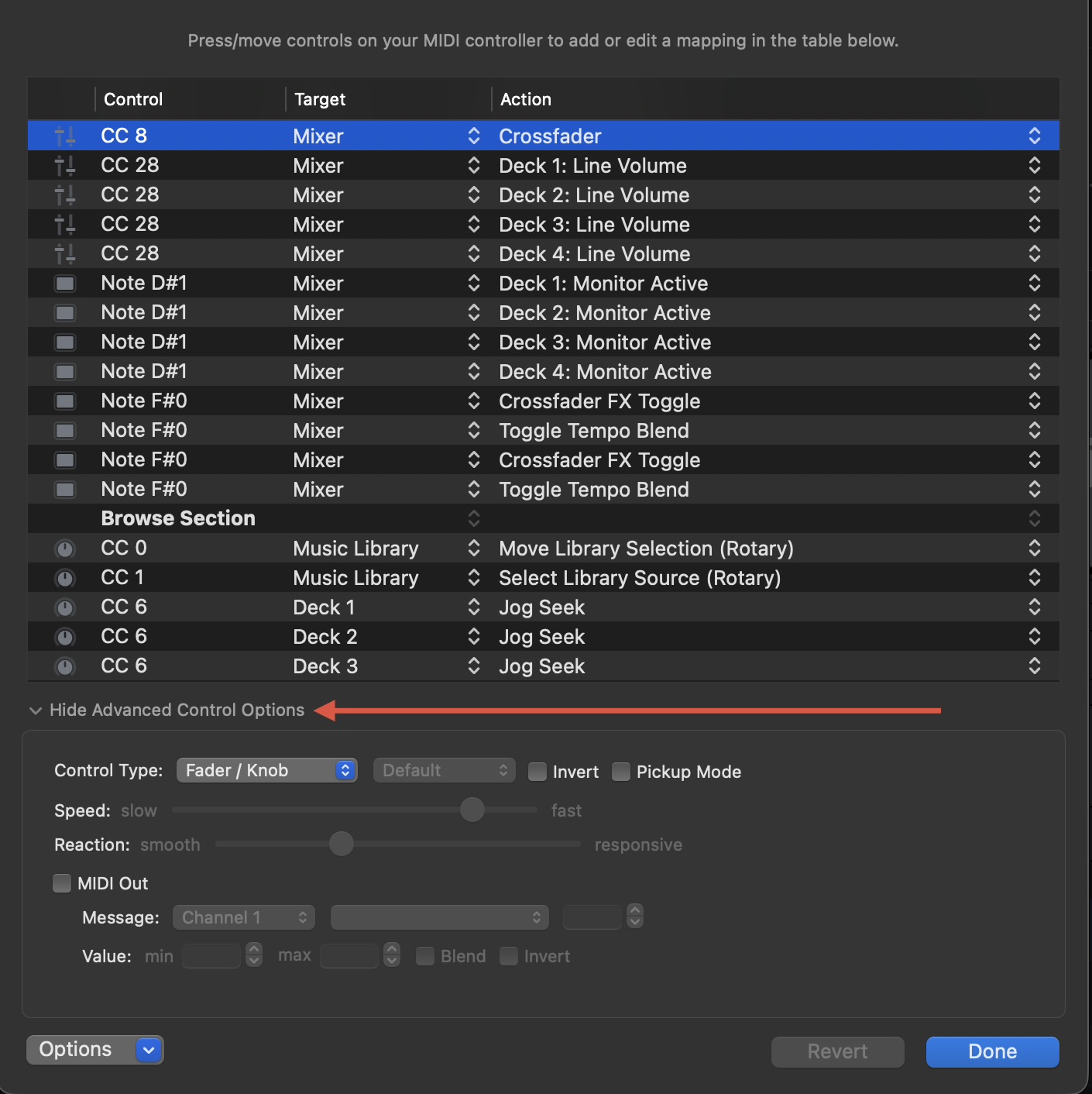

Hi @audiosymmetry, I recommend you check the Crossfader MIDI mapping settings in
the (built-in) mapping then recreate them exactly in your custom mapping. Be sure to expand the Show Advanced Control Options section at the bottom of the mapping window.
