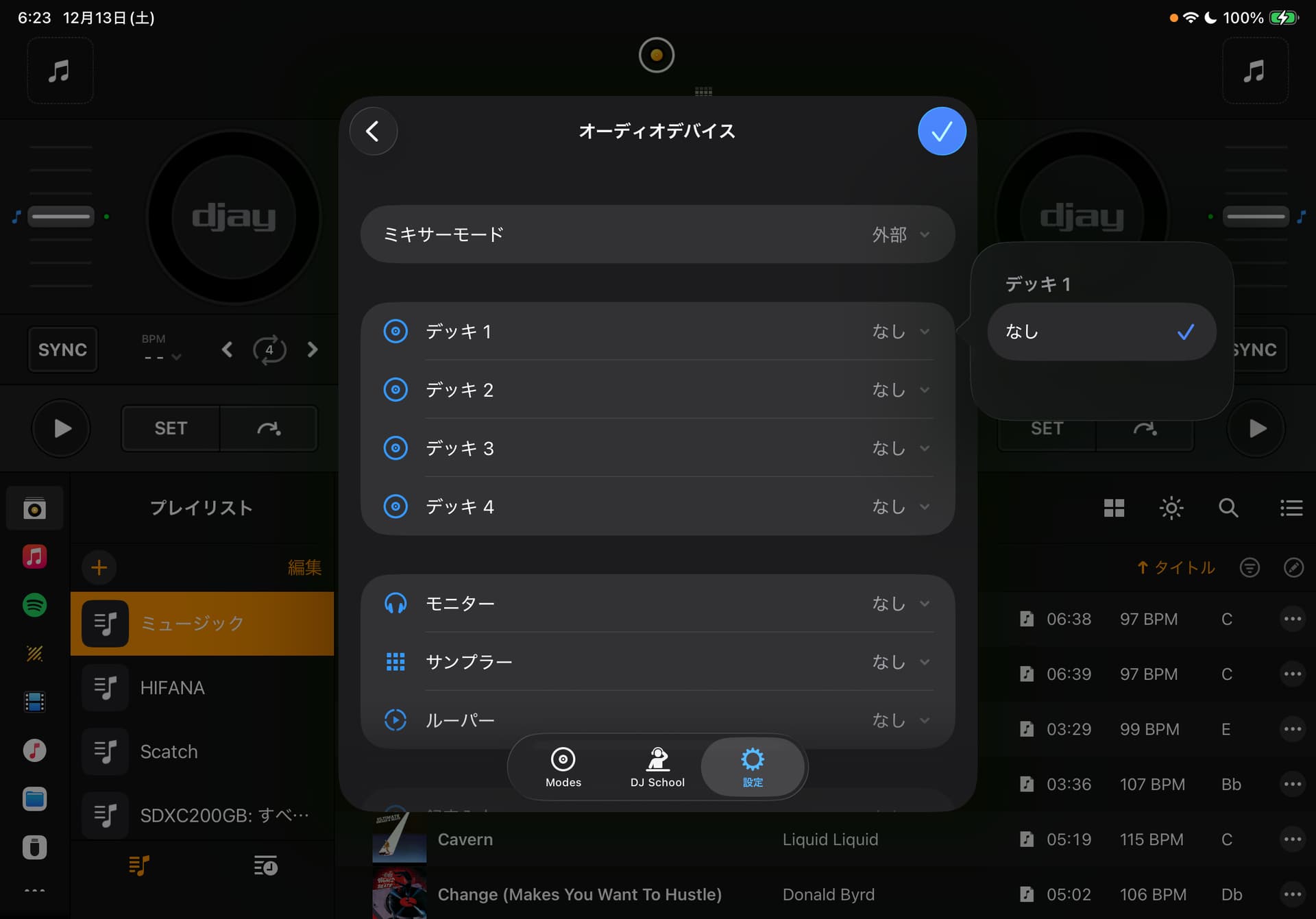

My iPad is not detecting the DJM-450(FW ver.1.07) interface.
I updated djay on my iPad(OS26.1) and connected it to the DJM-450 via a USB hub.
I rebooted both the iPad and the DJM-450.
Is there anything I should do?

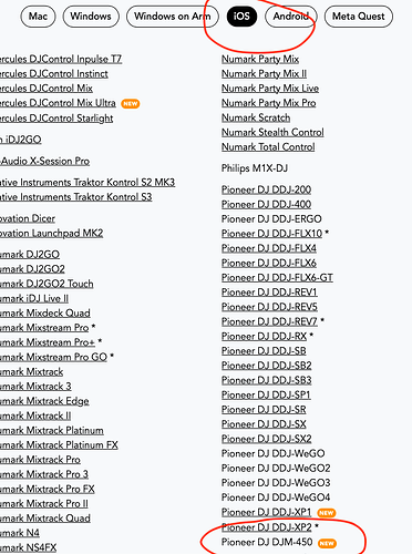

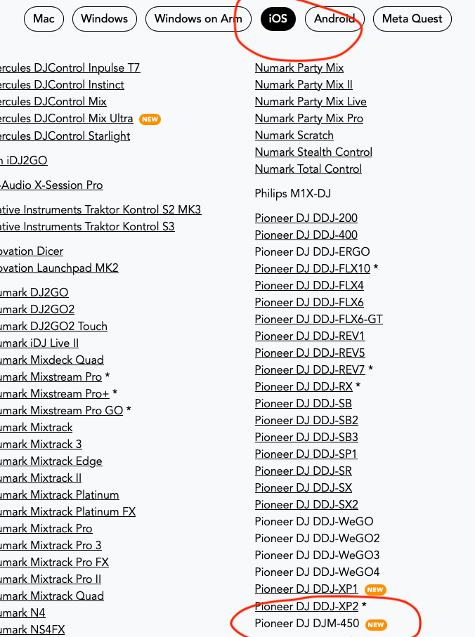

Thank you. I know about it, but official information and Algoriddim Staff says DJM-450 can be used with djay 5.6 DVS on iOS.
Now I’m guessing that’s incorrect information. But I’m asking because I want to use the DJM-450 without an audio interface box.

This was a mistake when we updated our website — the DJM-450 is unfortunately not class compliant, and therefore does not work on iOS.
This has now been corrected. Sorry for the confusion and getting your hopes up.
