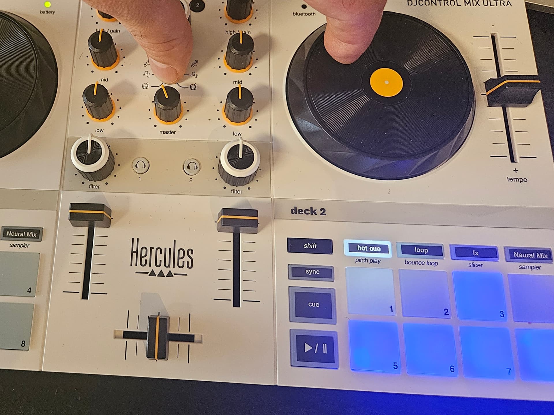

Hello,
Just to share the explanation of the problem. It was indeed a hardware problem.
Jogwheels are tactile. And in my case, they were faulty. To be sure, the technical support service asked me:
  1. press the jogwheel + neuralmix button for 5 seconds.
  2. the 8 buttons below become illuminated for an internal hardware test.
The top line allows you to adjust the sensitivity of the touch.
The bottom line should only flash when you touch the jogwheel.
In my case, even with a sensitivity of 1, the bottom line flashed without touching the controller. Until it stayed lit.
Conclusion, touch function failure. Return for exchange to Hercules. Apparently this is the first time they have faced this problem since the release of this model, so the R&D department will push the analysis.
In any case, thank you for your help,
Max
