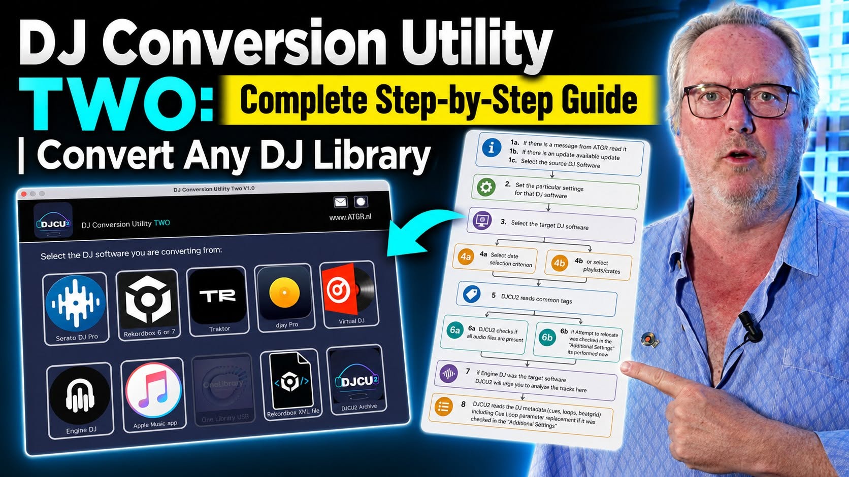

Our friend, @MixMasterG has posted a full tutorial on converting using DJCU v2
