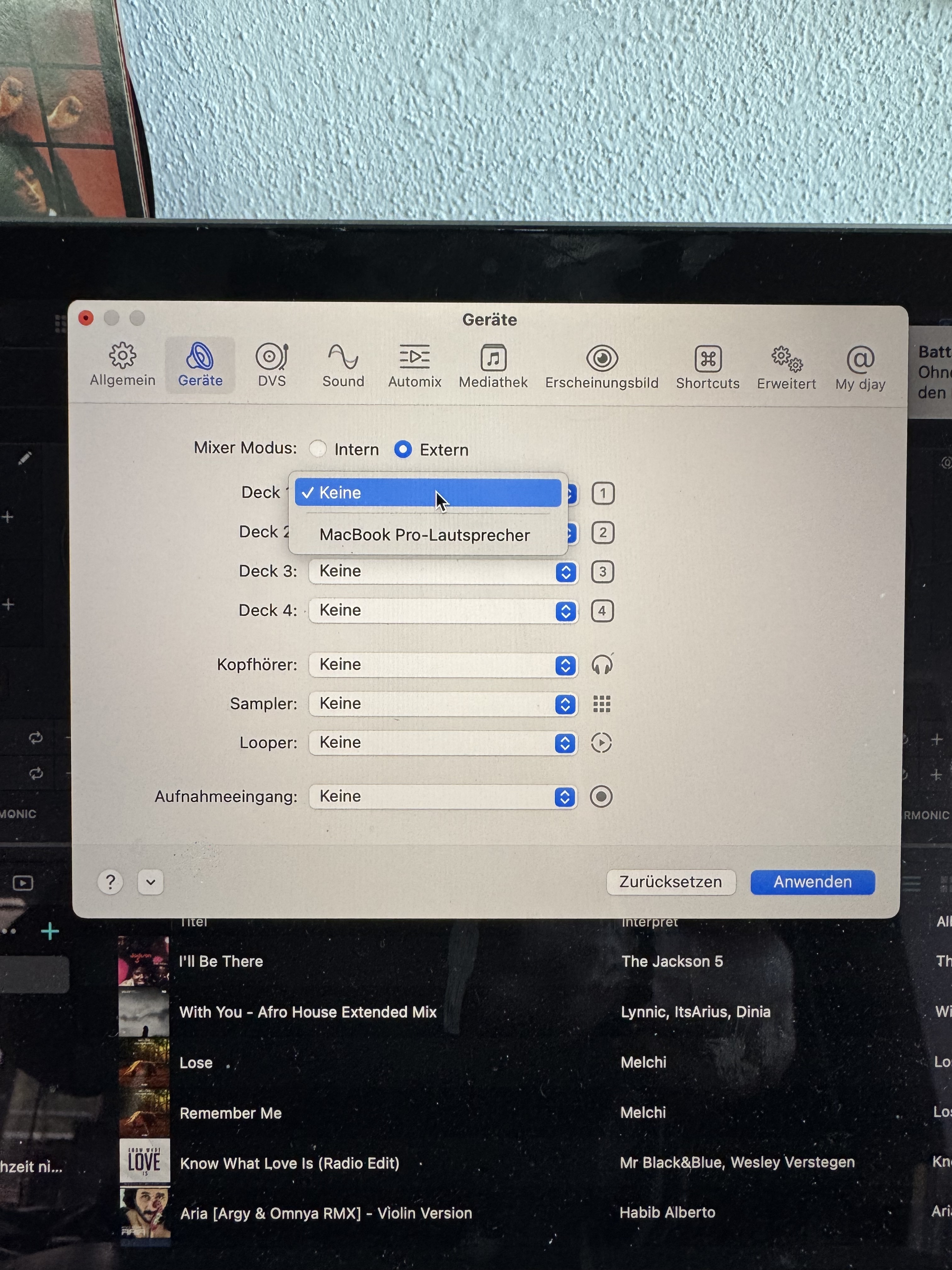

Hello.
Is the DJM900 NXS2 compatible with DJPro(533)
I installed the driver from pioneer website. In DJPro it is not possible to choose the mixer in external settings.
MacBook Pro MacOS sequoia!

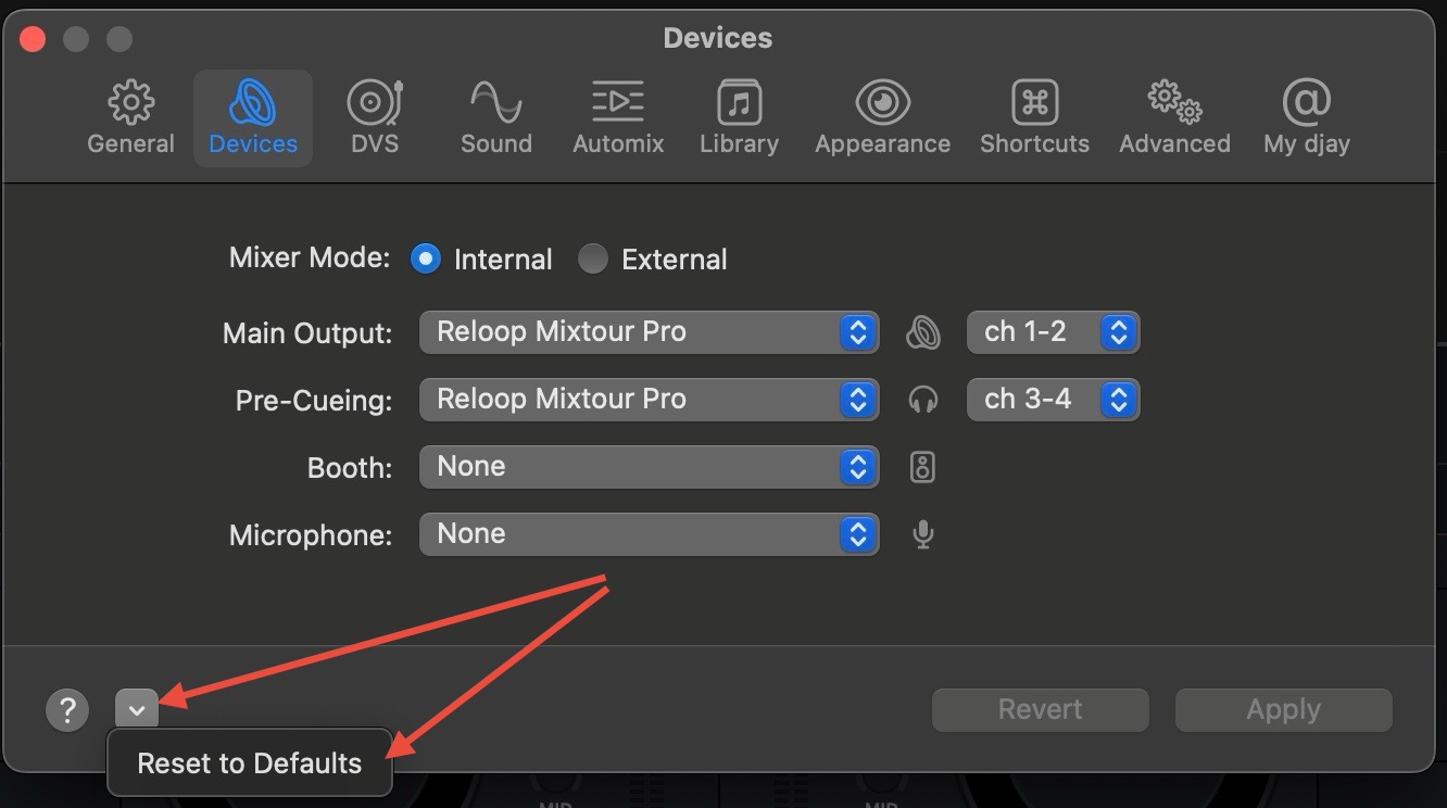

Hi @TTFresh, welcome to the Community! Yes, this hardware is supported on macOS:
  1. With the mixer connected directly via USB cable to your Mac, can you please share a screenshot of your djay Settings>Devices?
  2. While on this screen, please try selecting the drop down menu near the bottom left and pressing Reset to Defaults.

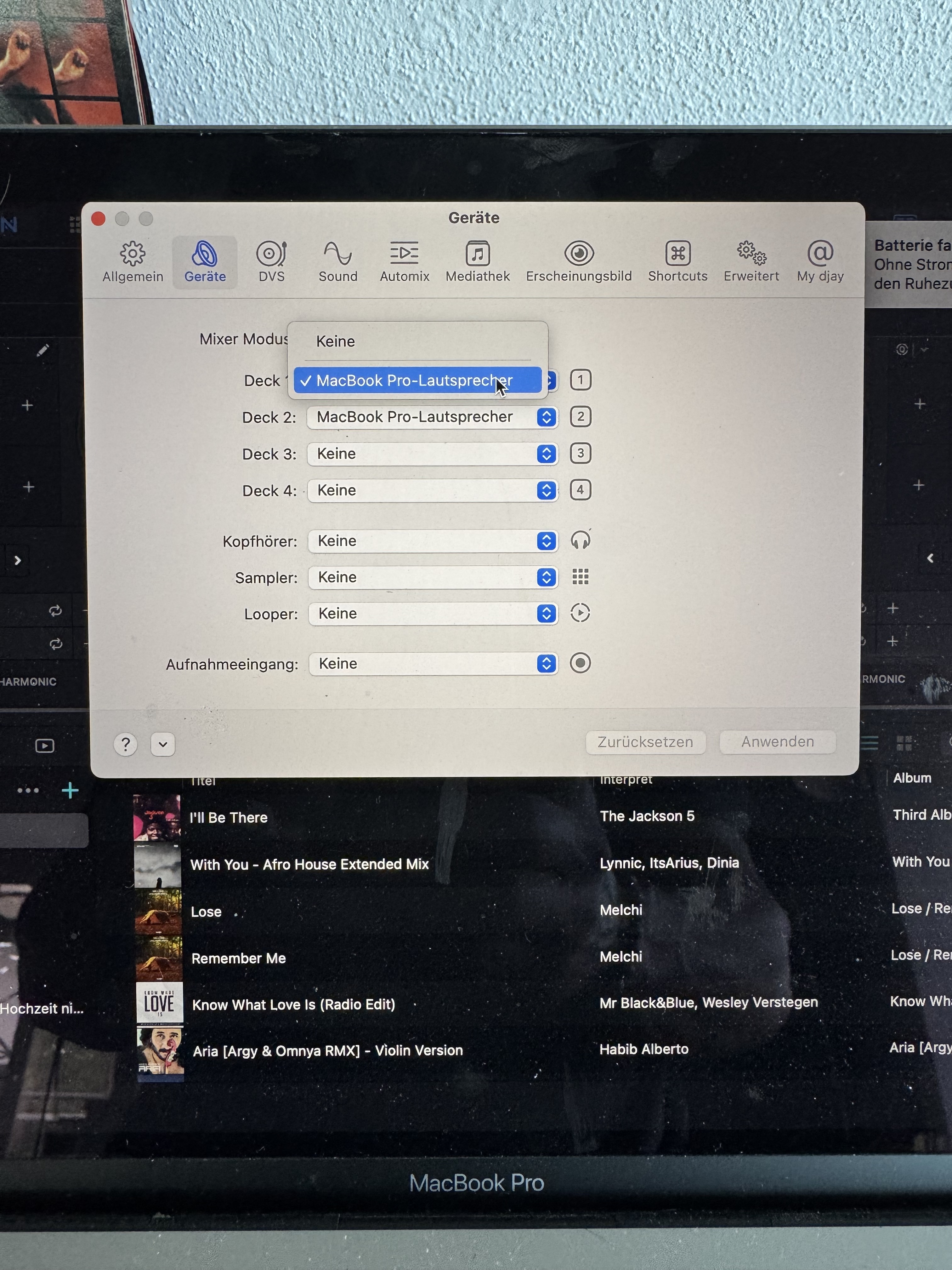

This makes no difference :thinking:
Good morning. I try that but no change.
The driver is installed and I updated the DJPro app before there was an error message from the driver but now it doesn’t appear.
Hi @TTFresh, thanks for the screenshots. What is this “Keine” audio device you are selecting? You should see something like Pioneer DJ DJM-900 as an option.
“Keine” means nothing to choose from. No device available. The driver is installed. It is the latest driver version from pioneer’s website.
The DJm900 should appear there. But don’t appear. :thinking::face_with_monocle::headphone:
