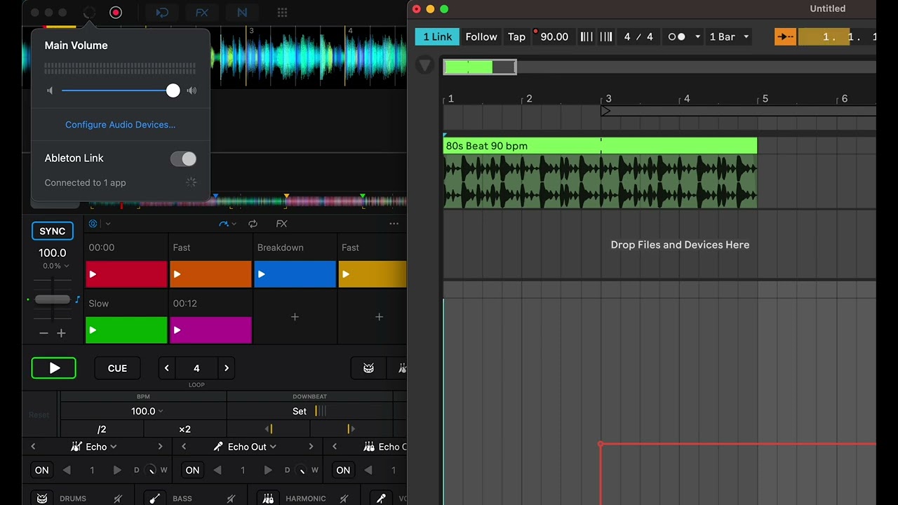

DJPro 5.1, MacOS.
Expected: when DJPro is playing and Link enabled, changes of tempo in the playing song should update the overall Ableton Link tempo when one of the DJPro decks is the master BPM source.
Actual: DJPro forces the playing song to whatever the starting BPM is by adjusting the pitch slider every bar.
Extreme example: Queen: Don’t Stop Me Now. https://youtu.be/cdLuld8qhAM

@Slak_Jaw I’ll refer you back to the video attached to the original report at the top of this thread. Here, no other software using Link was ever started (i.e. it stays at 'Connected Apps 0 in the link dialog), yet the pitch slider is moving all over the place - the track is syncing to some invisible external BPM source. This doesn’t happen with Link turned off but Sync still enabled.
