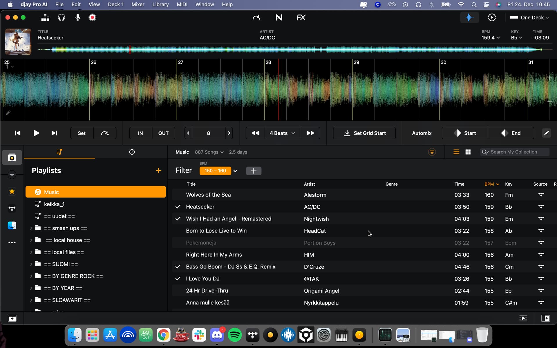

I was editing beatgrids, setting up bpms with 3.1.12…
So I doubled the beats and the song was shown on the 0-79 Bpm list…
Then I edited manually the ** bpm** to wrong value 158.9 and pressed the apply.
The song disappeared from the 0-70 bpm list… and was shown on the correct 150-160 bpm list.
Edited the bpm back to correct 159 bpm and now the bpm is correctly stored to the media library i.e after restarting the app:
I really would like that when using double/half and pressing apply, the value is stored to the medialibary correctly without doing this manual editing of the bpm value twice.
Idea for the fix:
  • I press the double/half bpm
  • this activates the apply button
=> if I press “apply” the bpm is stored to the medialibrary
=> if I don’t press “apply” the bpm is temporary value and only valid until the song is unloaded from the current deck
