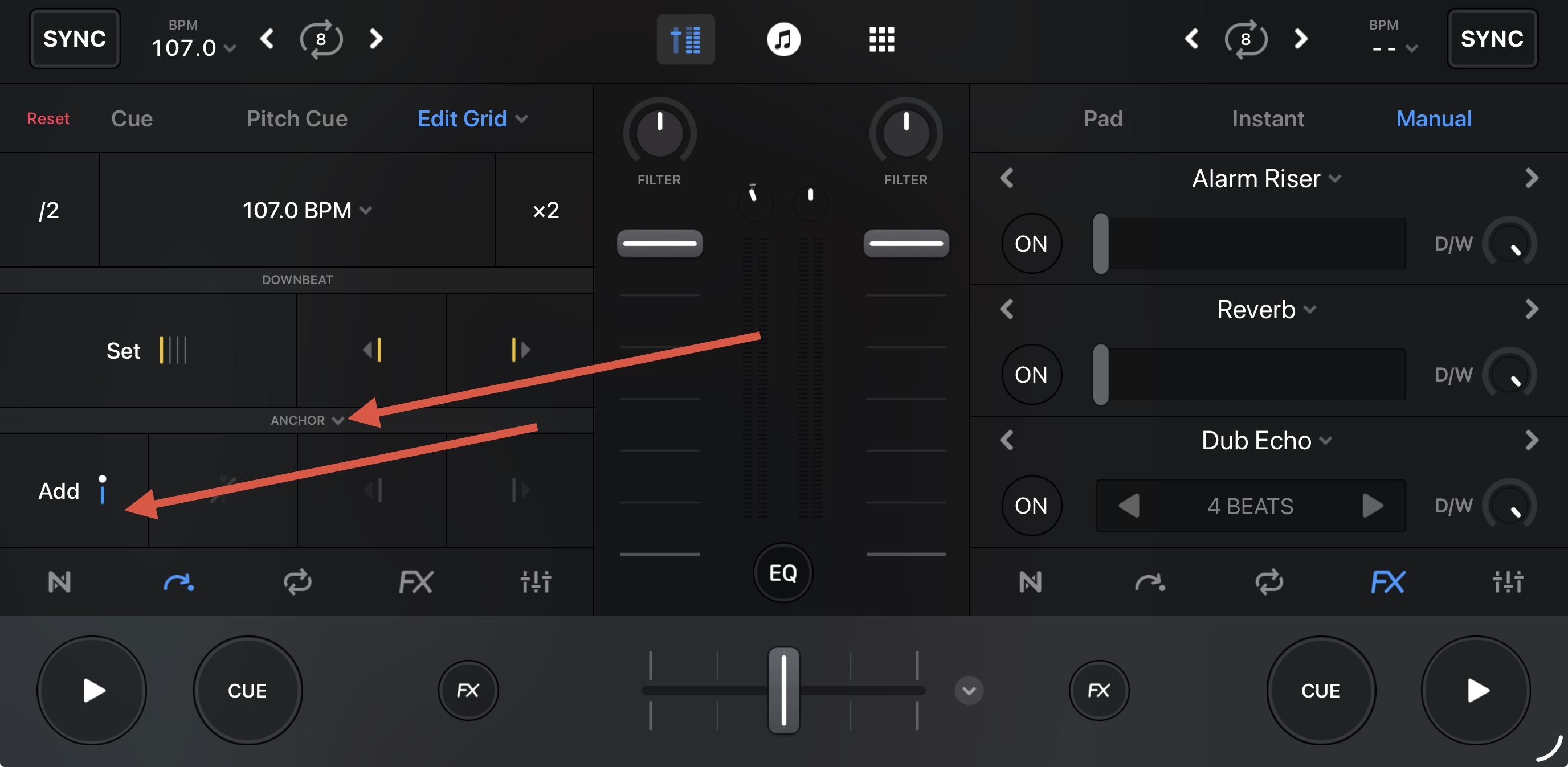

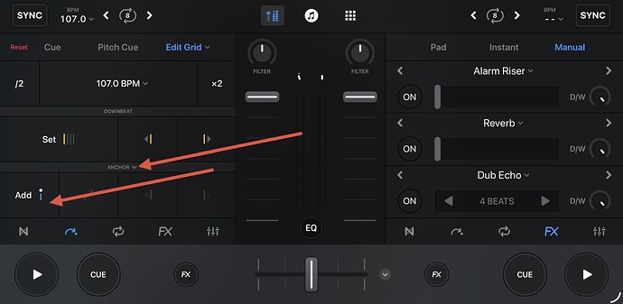

Hi @discoian, welcome to the Community!
  1. As @SamJam stated, you can set a new Downbeat where ever you like in the track.
  2. However, from you description, it sounds like what you’re looking for is Anchor Points. These are use for song with varying/dynamic beatgrids. Setting Anchor Points allows you to manually correct these if the Fluid Beatgrid system doesn’t automatically get it right.
Yes this is what I ment. I forgot the terminology :joy:
Thanks for clarifying @SamJam
Thanks guys, anchor points is exactly what I needed!
You’re welcome @discoian. Happy to help

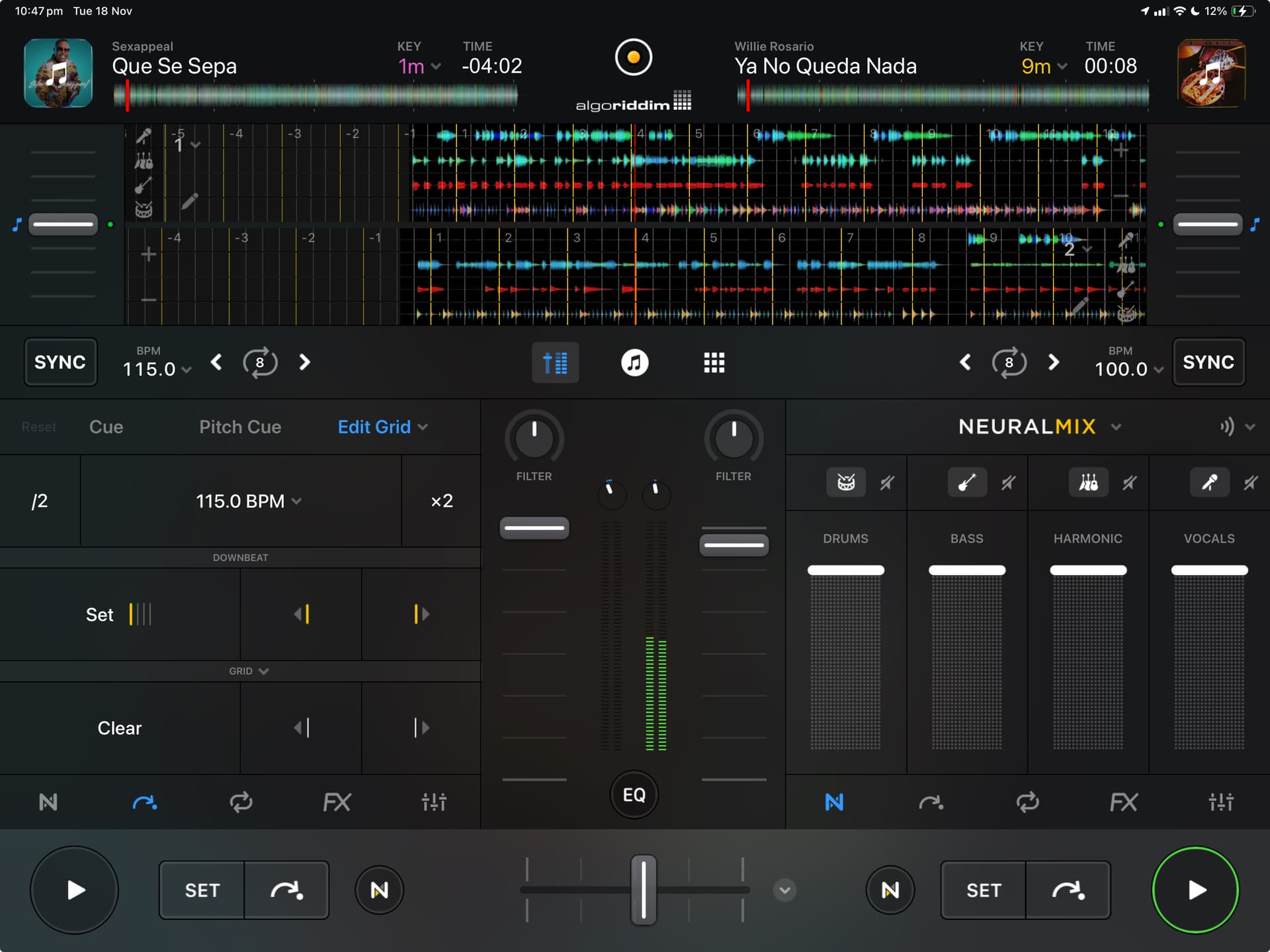

Couldn’t find the exact same problem, but this is close enough..
Problem: The analysis on the downbeat is off by a few beats. and it happened quite a fair bit.
My setup:
  • Ipad Pro 12.9 M1 512GB
  • IOS 18.6.2
  • Djay v 5.4.3
I understand i can adjust the new downbeat as per this post but I would love to know how do I set up the settings properly so it recognises the downbeat correctly, please?
Hi @PoyTB, there are no settings to change how the system recognizes downbeats.
