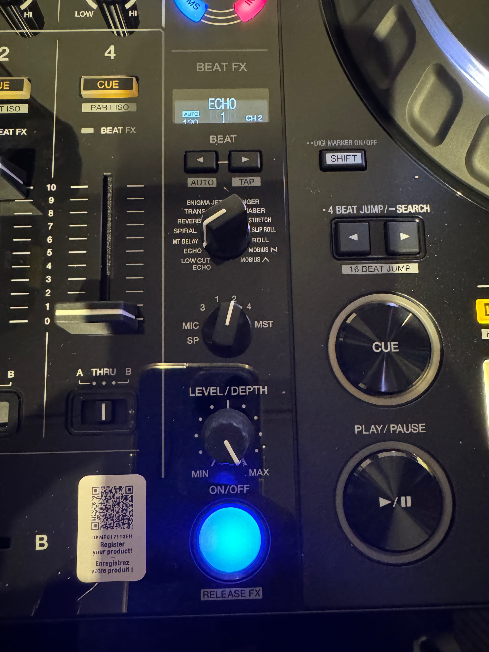

Just received my new FLX10 and coming from Mixon 8.
I am on the FLX10 I have these settings on the FX section.
Please watch this video to hear the issue. audio drop out.
FYI , the same thing happens when I use the iPad to turn on that effect. However, when I unplug the iPad from the controller, the problem disappears.

Hi @Nubium, this is not actually a dropout, it’s the delay behaving as it logically should.
  1. You have the Wet/Dry knob set to 100% wet, so when you activate the Echo you don’t hear anything at first, since you’re only getting the Wet signal and it takes that 1 beat for the delay to “fill up”.
  2. The quick fix is to set the knob to the middle instead of all the way to the right when using the Echo FX.
  3. The engineering team is looking into options to adjust the echo behavior in the future, but for now the 50% W/D should solve your issue.
I understand what you’re saying, however from a musical perspective, it doesn’t make sense for it to do that. I’ve done a lot of live sound, and used effects on a different lot of mixers, and none of them would behave like that. But thank you for your fast reply.
You’re welcome @Nubium
Hi again @Nubium, all common ways of implementing a delay in a live sound mixing setup don’t easily let you set 100% Wet 0% Dry - usually you get 50/50 at most. Either way, the dev team is actively investigating options to make this Echo FX behave differently. I’ll report back when we have more news to share.
