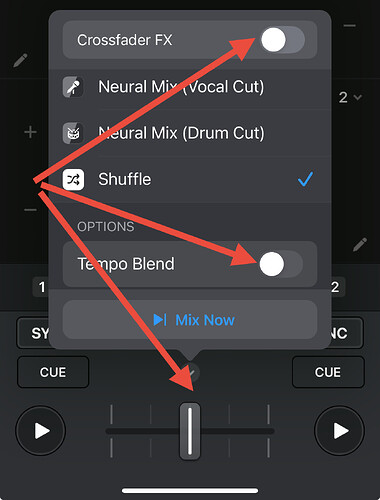

It sounds to me like you have Crossfader FX and Tempo Blend enabled. If so, please try turning these Off. If these are already off, can you please share a short video of the issue to help me diagnose the problem? Thanks!
