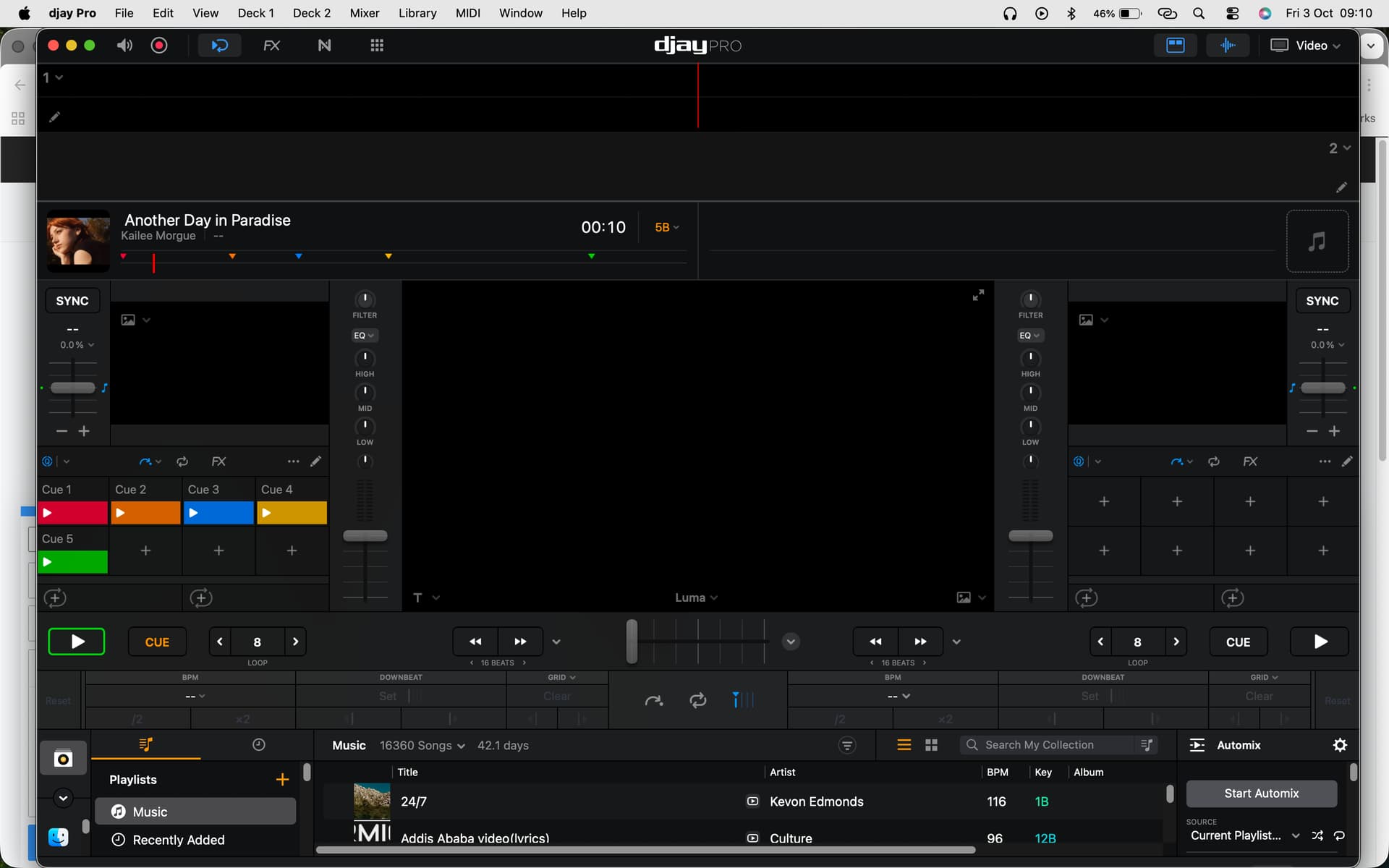

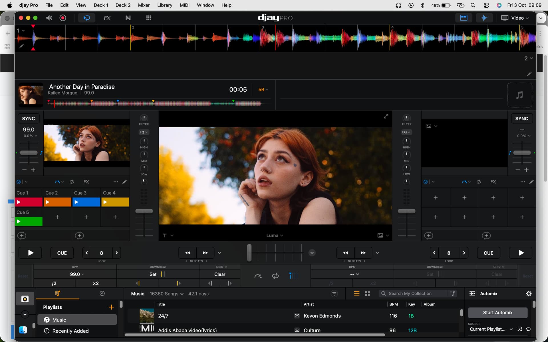

Drive Connected - song playing on deck 1
Disconnected, song lost sound and waveform after 10 second. Reconnected drive and re-loaded same song, nothing on deck other than this
