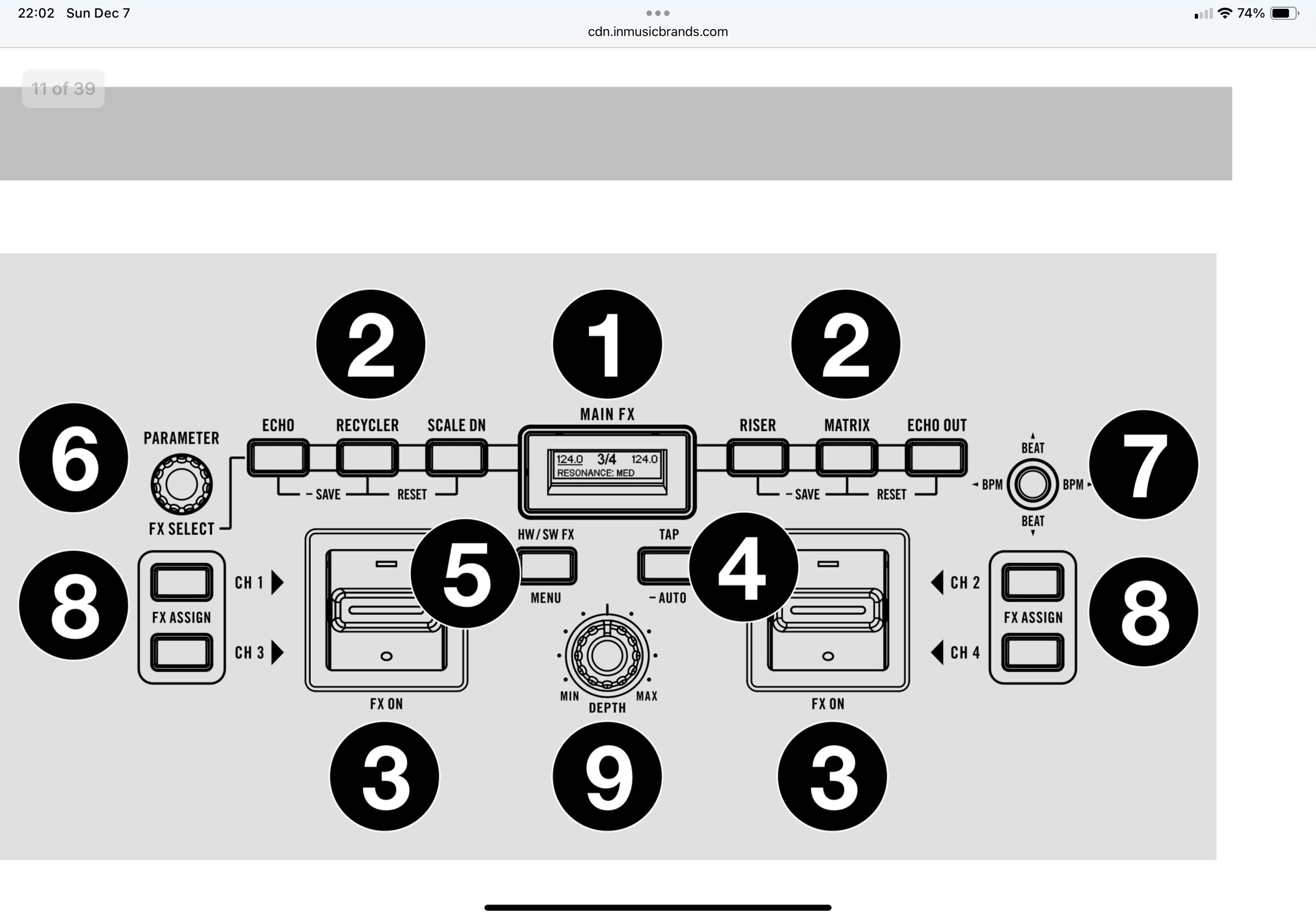

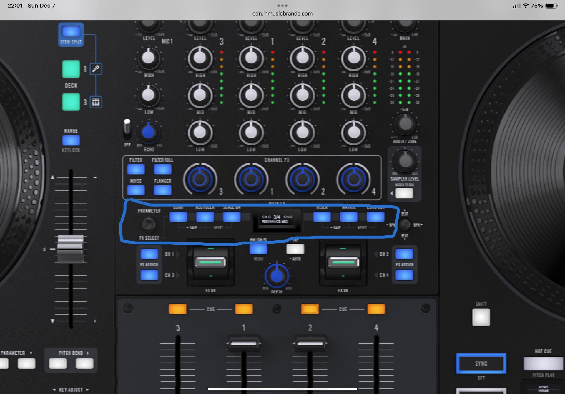

I have a couple of questions I’m hoping somebody can answer. The Software effects, circled below (Item 2 on the Rane manual) am I right in saying these are the 3 “Instant” effects you can change and select within the DJP software, not the pad effects but the 3 instant effects you can map to the NM instruments or all the track?

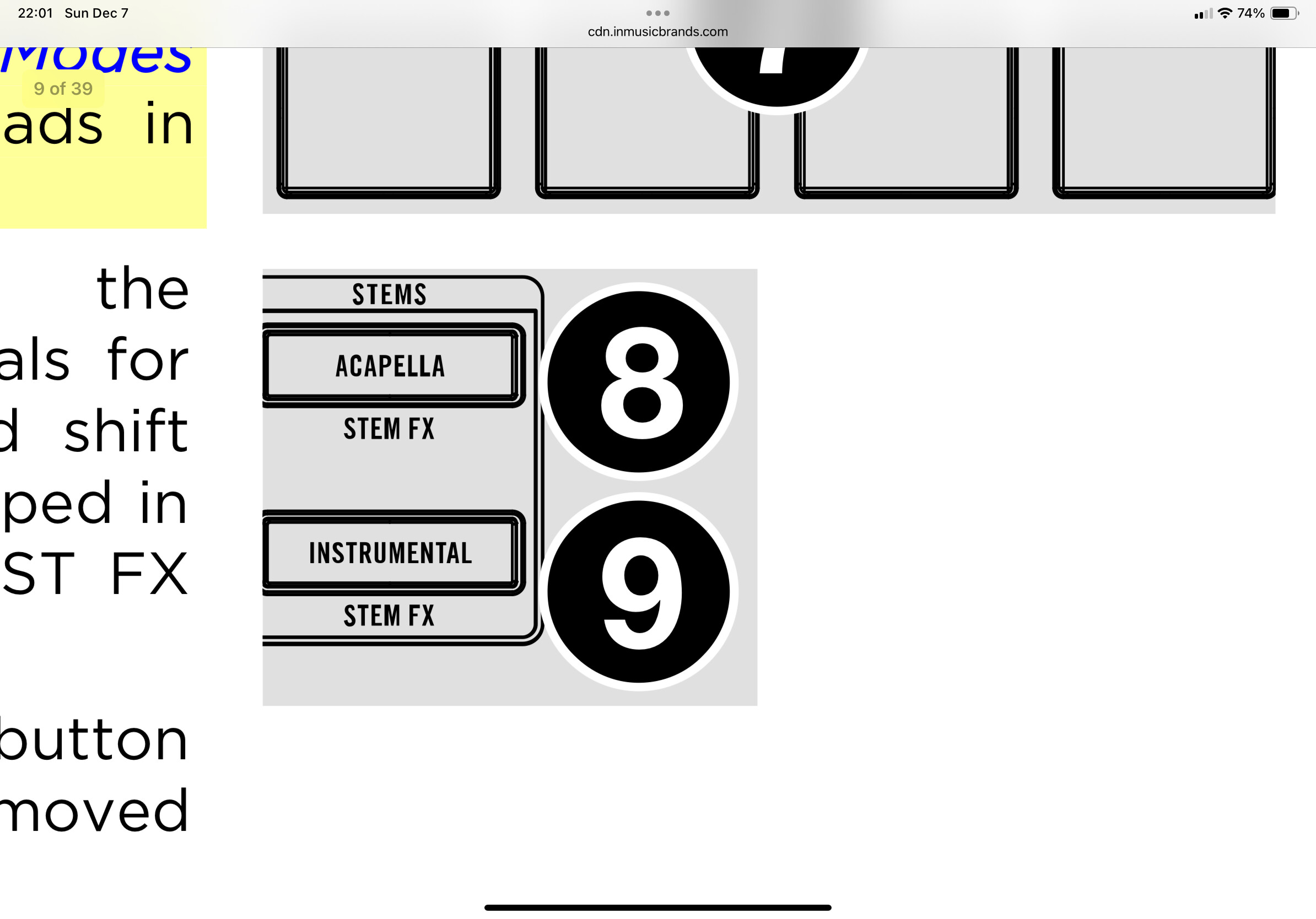

Also when you use the Stem Seperation, button 8 and 9 does the softwate default to 4 channel view or can you still use this feature whilst in 2 channel mode in the software. I’m presuming just with the 2 channel view so not seeing the individual wave files for the seperated vocal, say channels 2 and 4?

For the rane performer, you can use either the on board effects or the DJP effects. I actually really like the RP on board effects much better. The accapella and instrumental stems buttons work on the track the you have music assigned regardless of what channel it is routed to. You can also split the accapella to a separate track if you prefer. I hope this helps😊
Thanks for sharing @chisolmre01
Thanks for confirming this nd I presume you map the. To the six buttons I referenced above? and just choose between hardware and software?
Thanks again
Cuzer
Yes, you can assign the effects and parameters to each of the six buttons.
