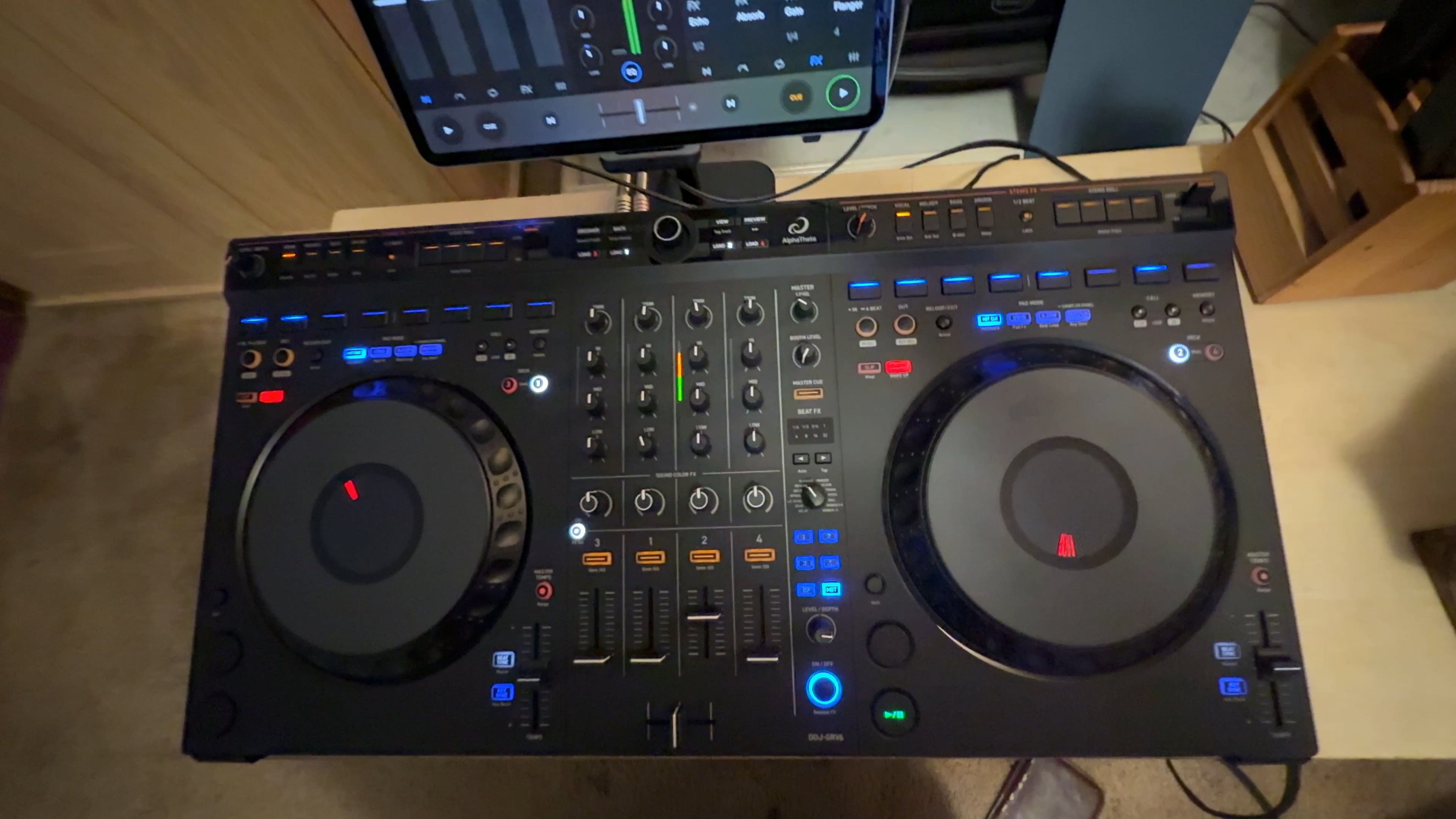

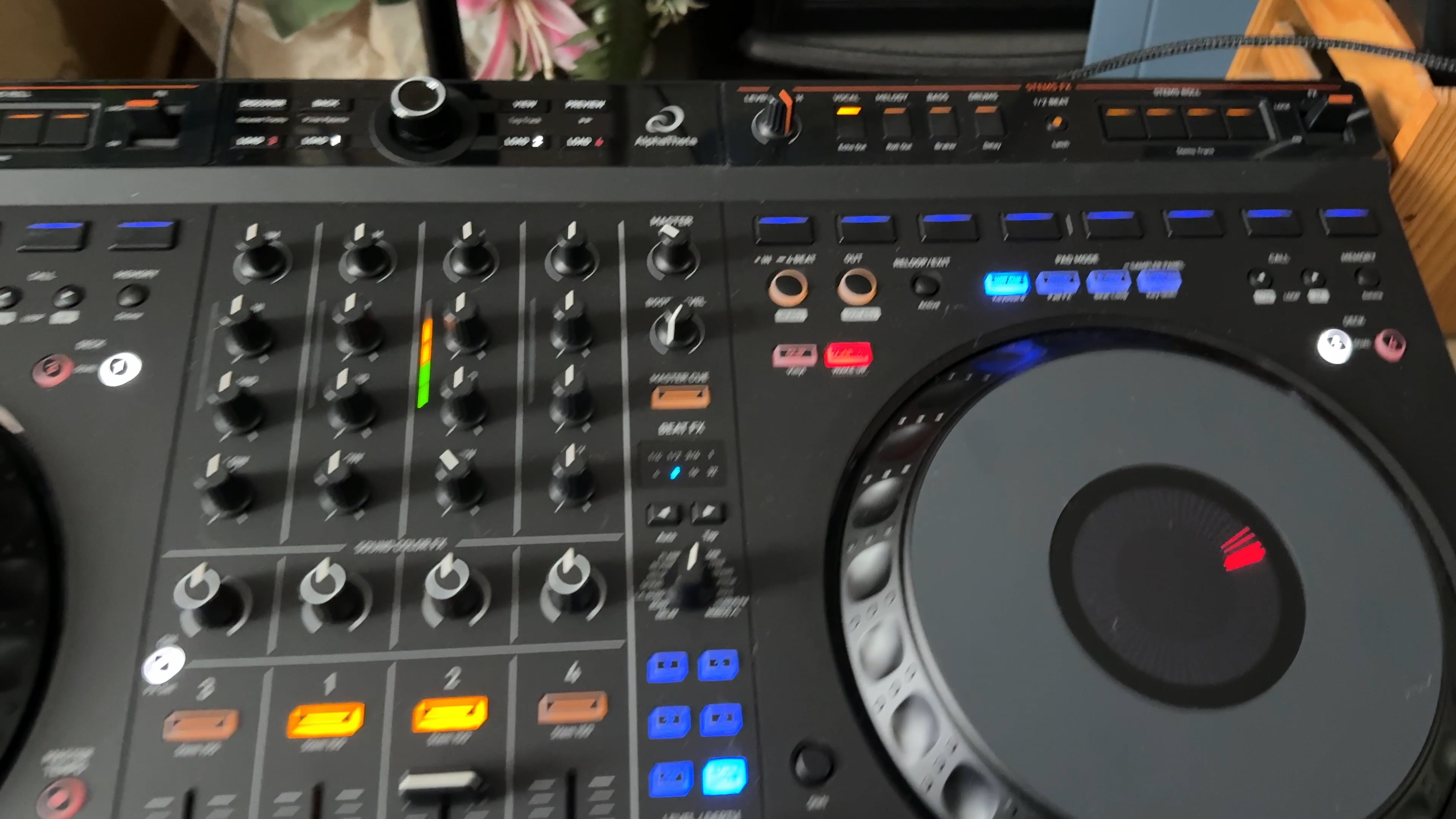

Summary of the issue:
The STEMS FX lock button state position is not being honoured / checked when changing tracks.
How to reproduce the issue:
- Load any track with vocals
- Click the Vocal button on the STEMS FX panel so it lights up
- Move the FX lever/switch to the LOCK position
- Adjust the Level / Depth dial
– All works as expected
- Load a new track
– What should happen:
— The vocals level change
– What does happen:
— Nothing
You need to move the the FX lever/switch away from the LOCK position, then move it back to the LOCK position again for the Level / Depth dial to work with the newly loaded track.
Video attached which will hopefully demonstrate the issue for easier repro

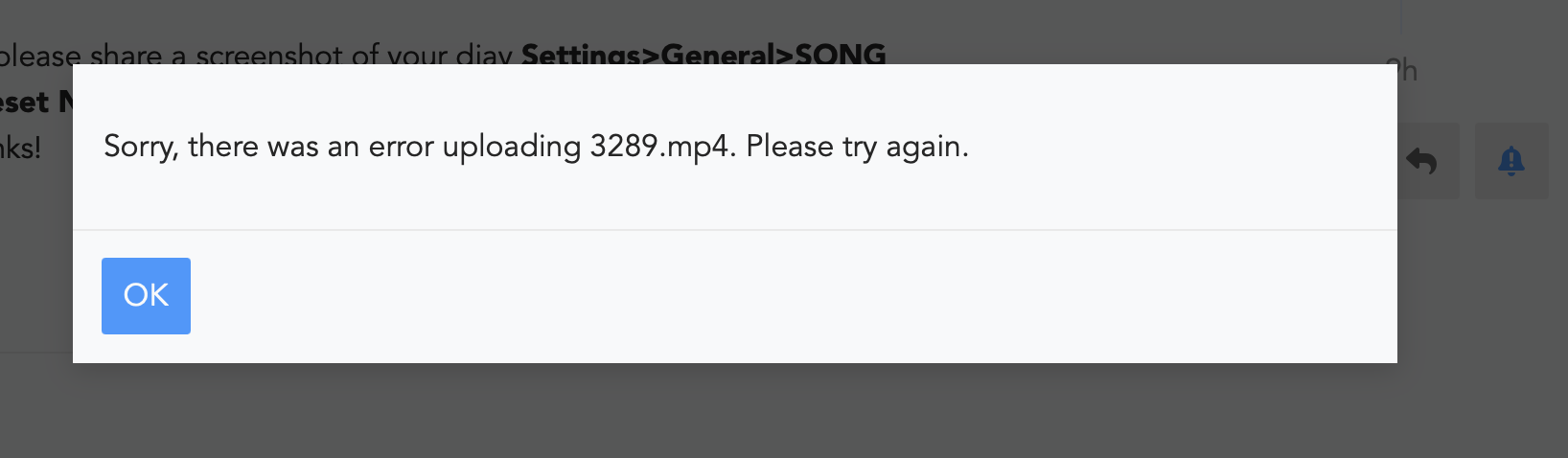

I tried, but the forum displayed an error:

Here’s a second video showing the bug with the Reset Neural Mix Controls setting off.
