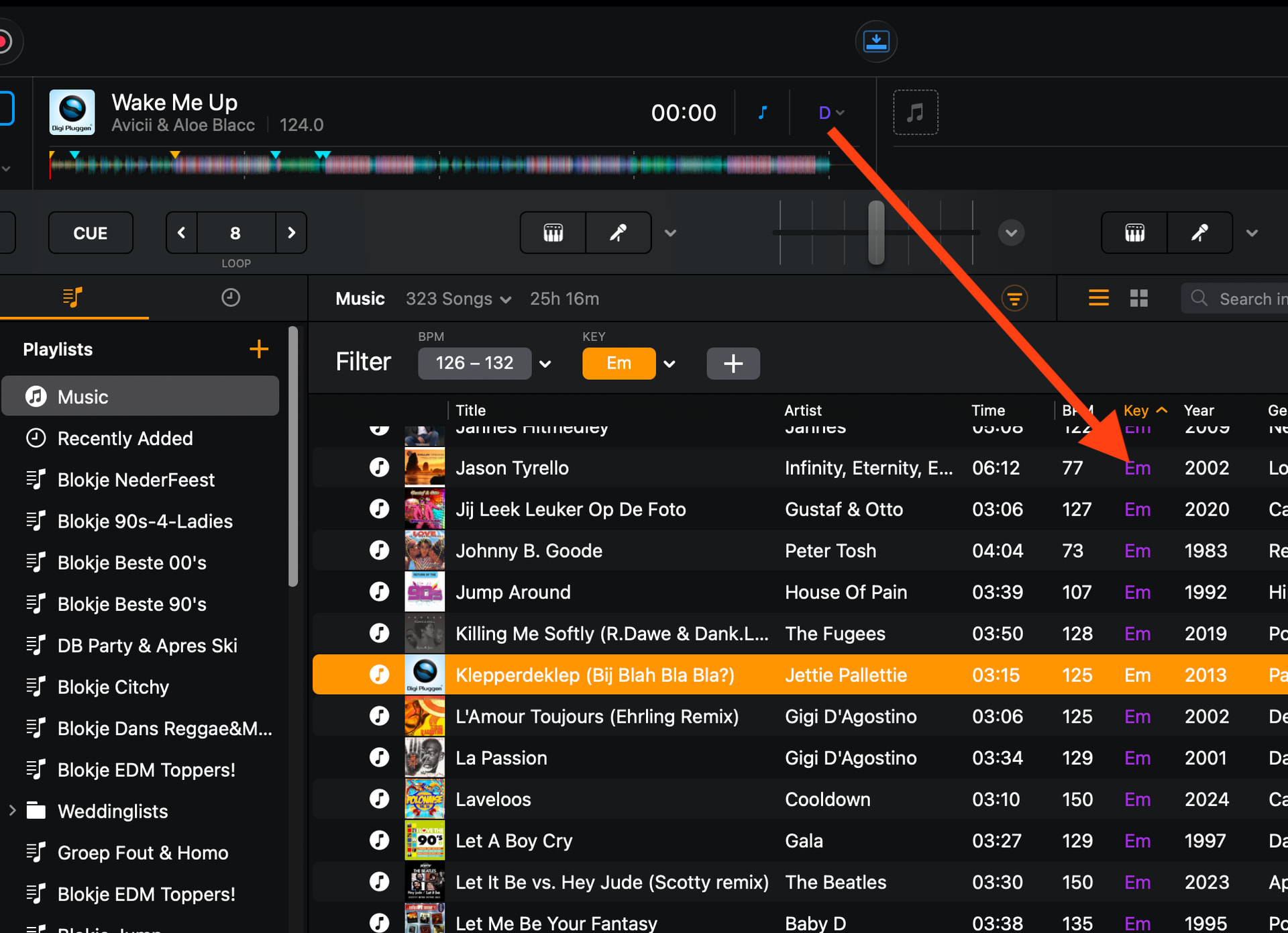

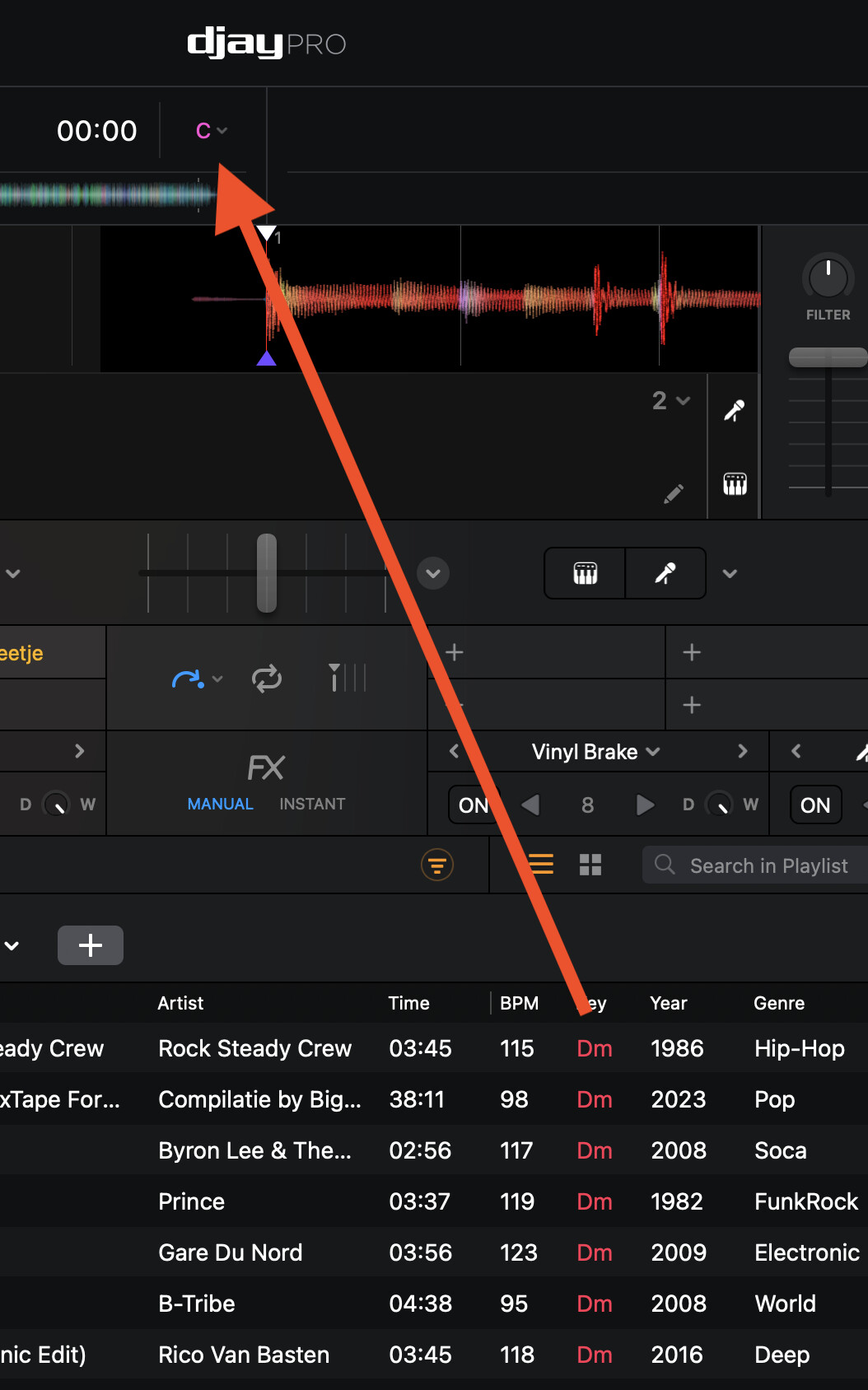

In djay playslist the colored Harmonic Match suggests combinations like:
C major (8B) → D minor (7A)
D major (10B) → E minor (9A)
and so on
I’m trying to understand the reasoning behind these suggestions. I can’t place them within commonly used harmonic mixing theory, and I don’t see similar behavior in other DJ software. Also it doesn’t sound harmonic at all in my opinion..
Is this an intentional design choice based on a specific theoretical model, or could this indicate an issue in the matching logic?
I’m asking because I rely on Harmonic Match in practice and would like to better understand its behavior, or help improve it if needed.

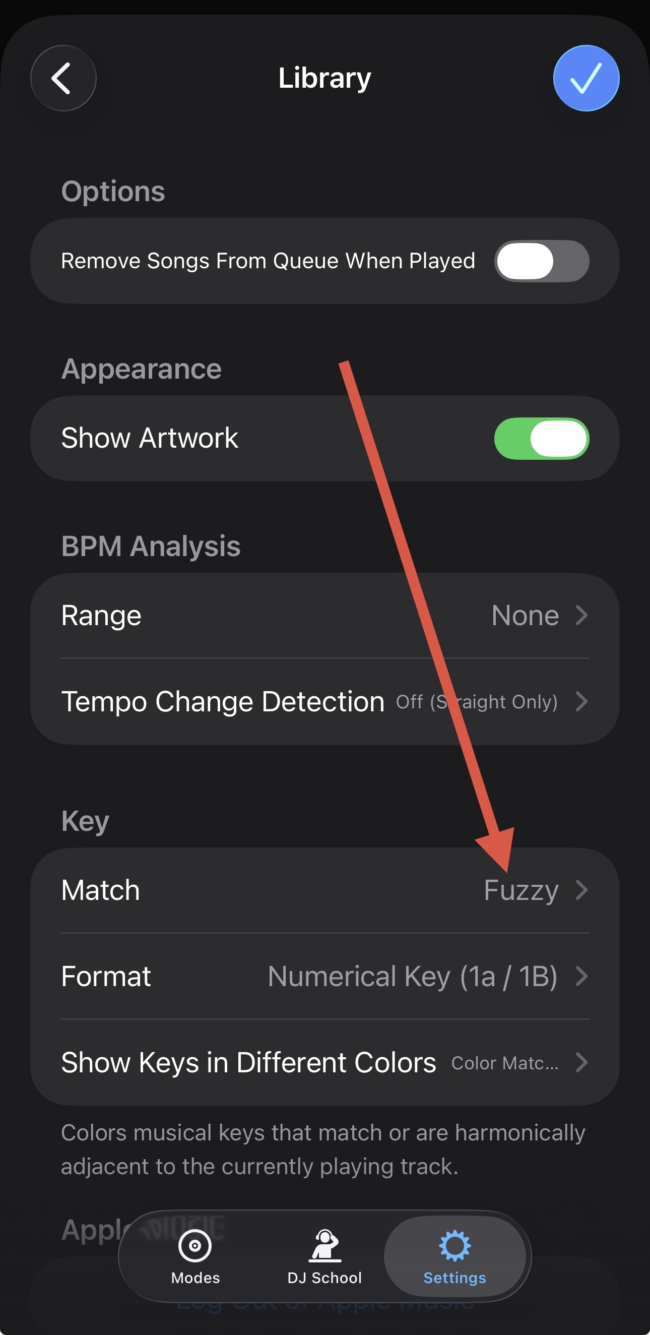

What Match Settings are you using @DJ_Big_Blender?
Hi @Slak_Jaw
No, it’s on ‘Exact’. But in fact changing this setting doesn’t change the result. In both cases D minor (7A) is shown. And also E minor (9A) is shown for C major (8B).

What about the Show Keys in Different Colors setting? Are you using:
  1. Off
  2. Color All Keys
  3. Color Matching Keys
  4. Color Matching/Adjacent Keys
Regarding the Match Setting, sorry, I forgot this is only used when actually Matching the Keys of 2 songs not when showing Matching Keys in the library
