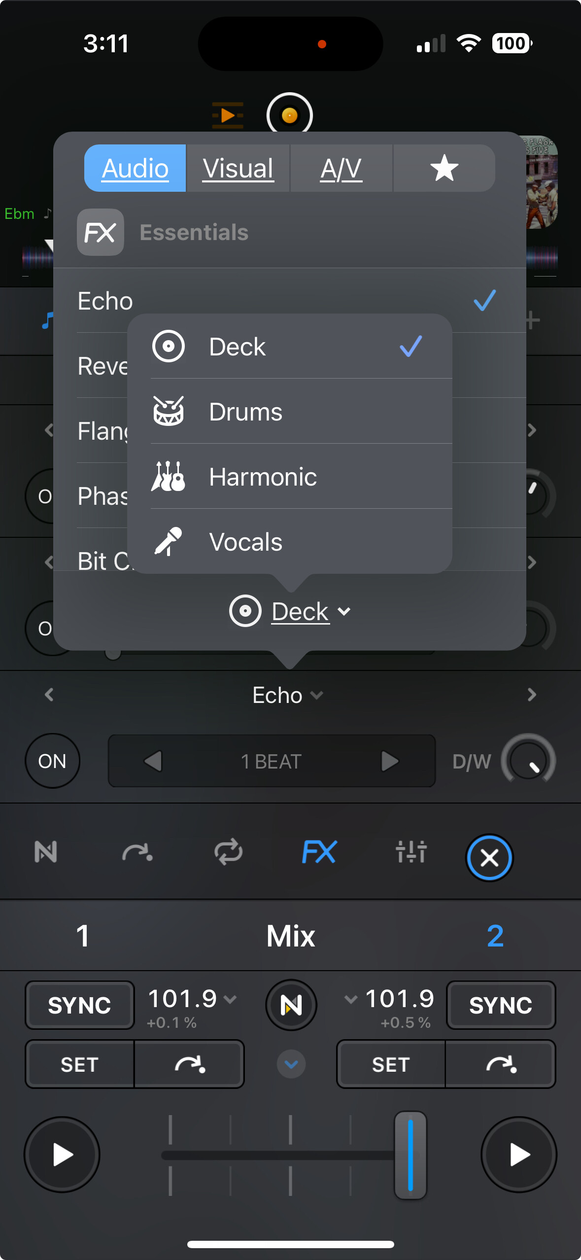

You can apply effects to vocals but I don’t think you can apply to all of the instruments at the same time. So for example you can echo out just the vocals and you will end up with just the instrumentals.
It should be in the neural mix section of the effects for the instant effects and for the manual effects if you click the drop down arrow next to it you’ll see the option to change what stems the effect is applied to.
here are the options.
Deck
Drums
Harmonic
Vocals
Alternatively if you use the neural mix eq you can transition at your own pace by lowering the vocals, harmonics, and drums you could then lower the harmonics and drums gradually and end up with just the vocals just like you would when transitioning with mids and lows.

Go to FX there you can apply multiple FXs to specific areas

Hi @eecy_cee, this should now be possible with djay 5.3.
  • We’ve introduced the new Mute FX that adds echo tails when muting or soloing STEMs.
  • We’ve also revamped Neural Mix FX. You can now select multiple STEMs to apply the FX to instead of just one.
For the full 5.3 release notes, please refer to the topic below. Thanks!
