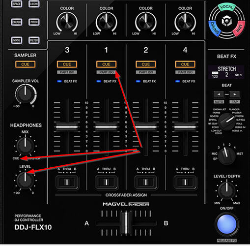

  1. I assume you pressed the CUE button on the hardware, have the Headphones Mix knob set to CUE and the Headphones Level knob turned up and it’s not working?
