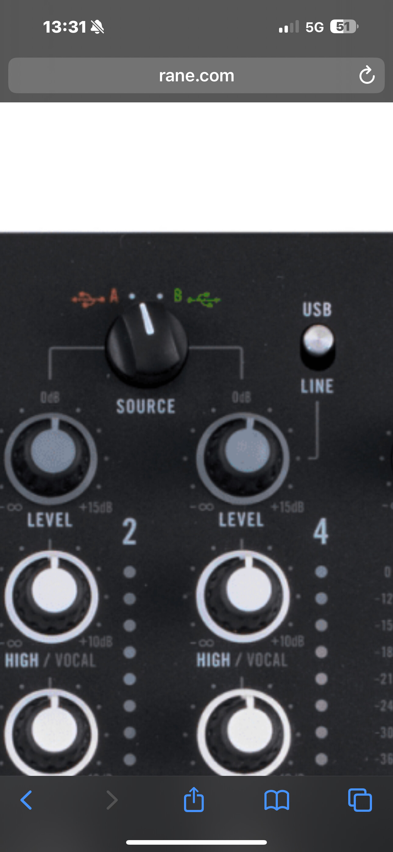

My full setup is as follows: Rane Performer connected to an Apple MacBook Pro M1. I am using USB A to connect to the laptop (USBC) port.
See this picture. Do you have usb and source set correctly?
Yes, I do have them both set as per the photo
I actually use the same setting while using Serato DJ Pro as well, without any issues.
Hmmm interesting. Take it you have latest firmware and software updates? Try USB B just to try.
Yes, I have the latest firmware installed and the software is also updated. I had to send my Rane Performer back for a warranty repairs because my headphone ports were faulty. It is currently on its way to be delivered this afternoon.
I will try to switch from usb A to usb B port and see if it works.
Sounds good. Let us know if works out.
Many thanks Dysfunk_DJ. I appreciate your help and support. Please, did you have to do any MIDI Mapping on Djay pro before your Rane Performer worked seamlessly?
