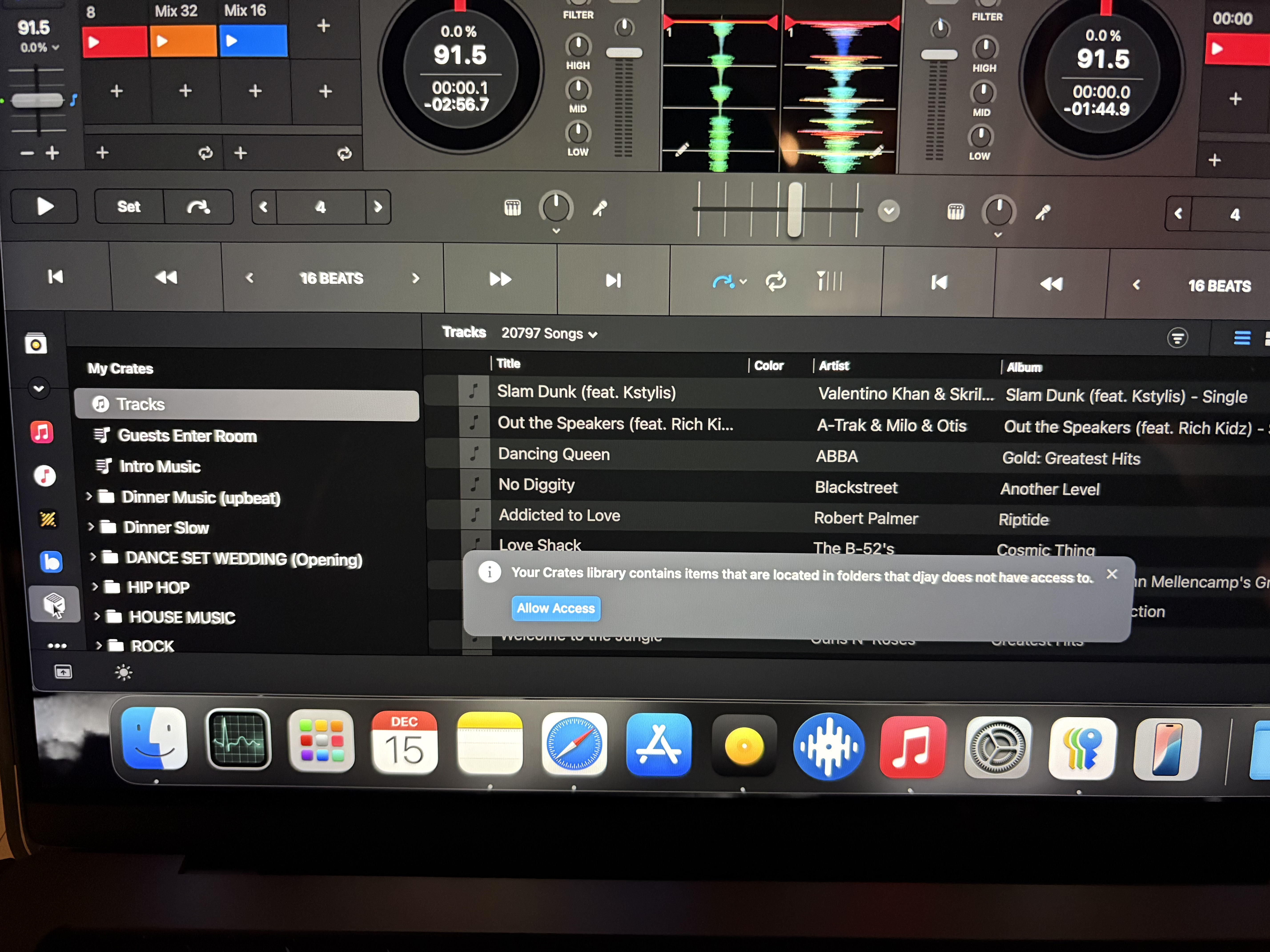

I’m still having this very interesting cue point issue. Do you remember seeing anyone else having this issue?
Hi @jmoak311, you’re the only one that I know of with this issue. Maybe you could try adding these songs to My Collection and rename one of them to see if that works.
All of my serato crates naturally transferred in to the My Collection section. Mostly I use Beatsource, but even updating a Beatsource track can change the meta data in a physically downloaded version. It’s as if the program can’t differentiate the metadata between the two songs but I’m not a software engineer.
I did see other people having issues like I did in the second photo (where it’s not recognizing “my crates”)
But they’ve all propagated in the my collection section so I’m not losing any sleep over it.
But then randomly two similar tracks won’t affect one another.
