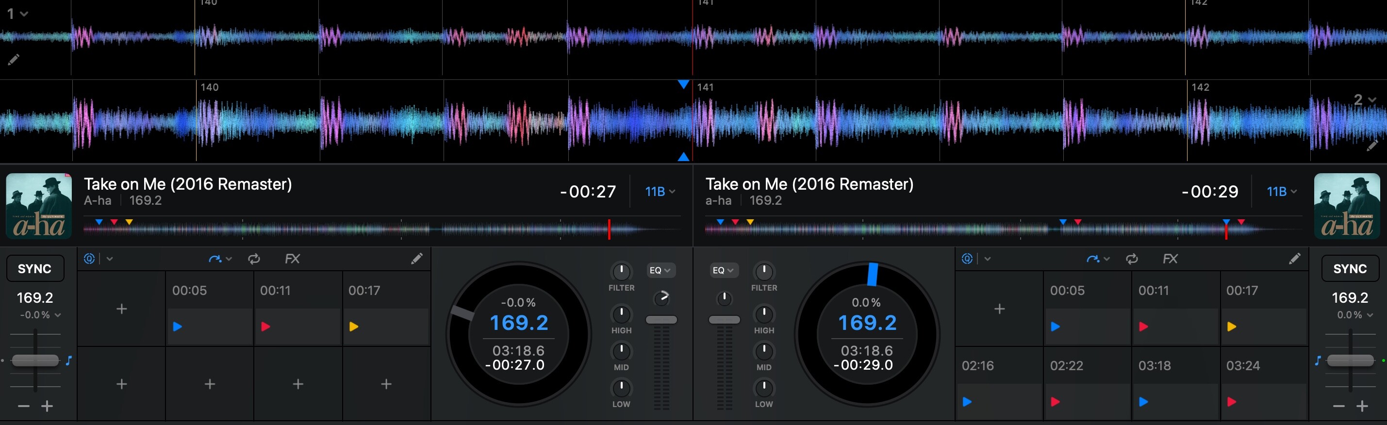

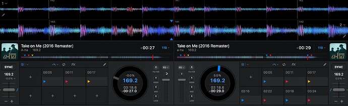

Hi, thanks for the follow up… The thing is that once I fix a “broken” song (I reset the CUEs properly), it stays in place for ever.
Above you see two bad cues in the same song, but if I reset the position (so far) it will never go bad again.

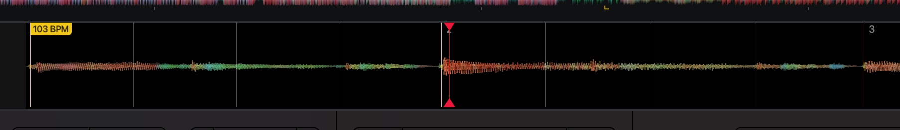

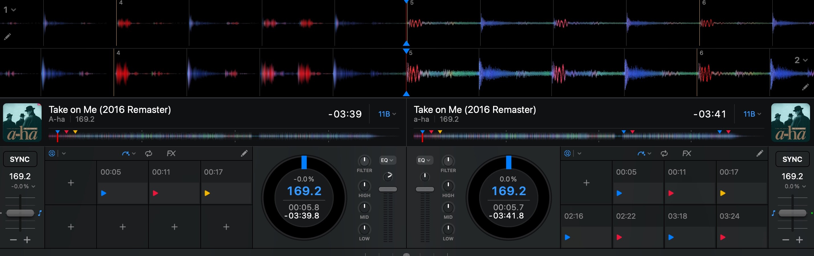

Yes, let me show you same song… On left deck the streaming version (from SoundCloud GO+), on the right Downloaded version in my internal SDD. You can check cues are not the same for both versions (the one on the left only has 3 count in and the one on the right has 4 out cues and the end of the song):

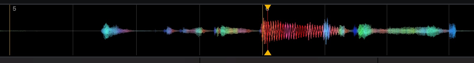

The image below shows that the local (downloaded) version still has the CUES slightly out of place on the end of the song; because I fixed the first 3 cues but I didn’t fixed the last 4 cues (you only see a blue cue as I need to zoom in for you to appreciate it:
If I fix the last wrong cues (which I’ve already done) it will stay in place for ever (hope so!).
