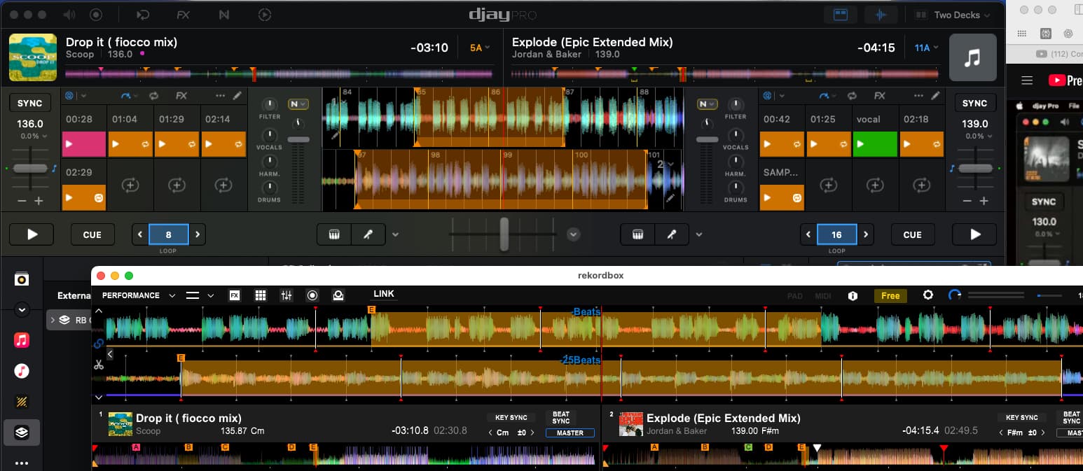

This comparison between djay en recordbox should make it clear.

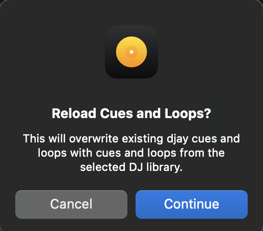

Hi @djbo, sorry for the delayed reply. The engineer that I needed to discuss this with was away on vacation. Did you re-run the “Reload Cues and Loops” option for the effected tracks after updating to djay 5.4.2? Just checking as djay only reads the cue/loops once from Rekordbox on first load of the track, so you would need to reload them via this option to get the offsets updated with the change. Thanks!
No problem for the delay. I was not aware of the option “Reload Cues and Loops”. I just ran it several times on a track (see screenshot) and ik doesn’t make any difference.
Thanks for checking @djbo. I’ll let the team know.

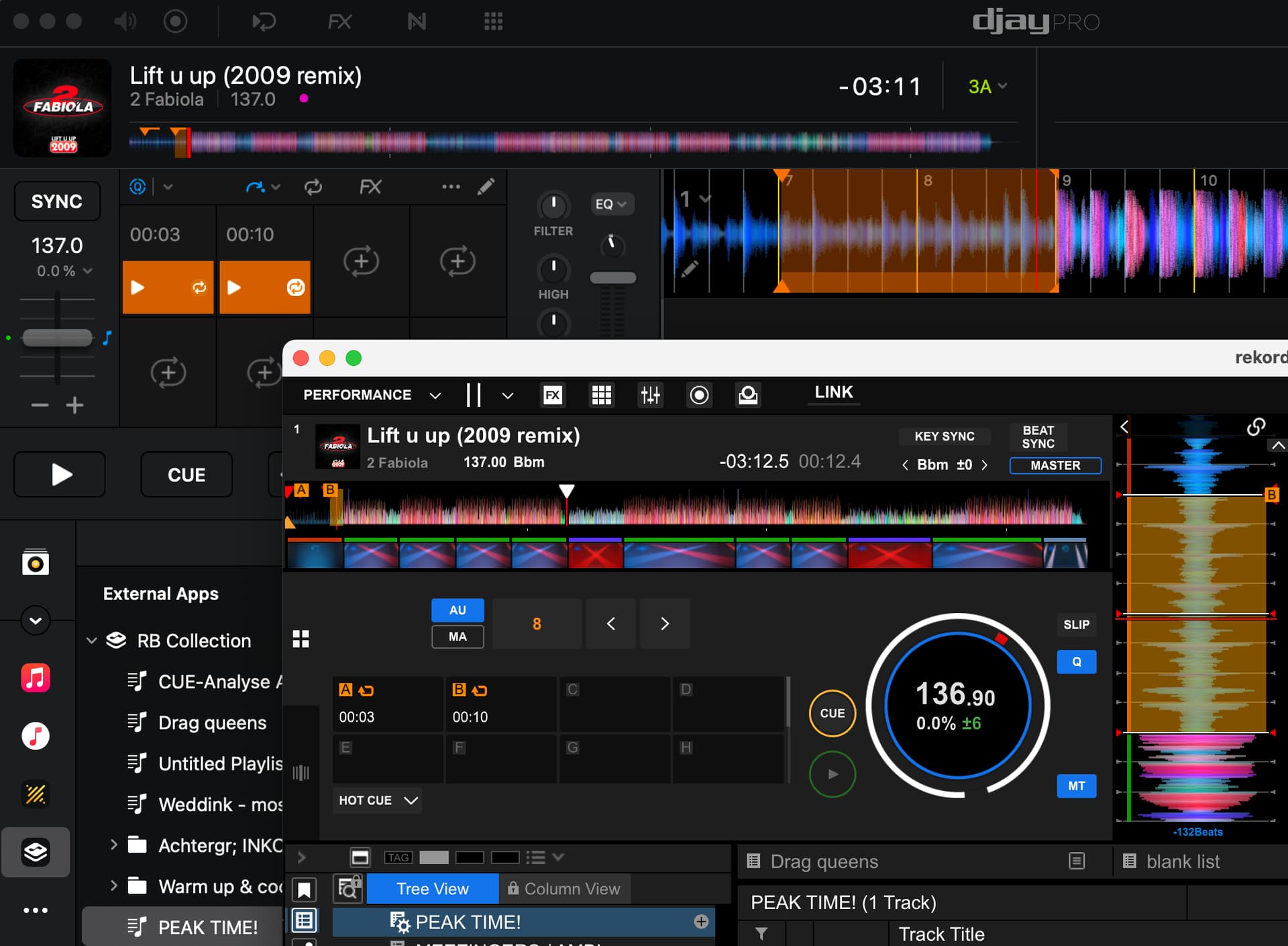

Hi again @djbo, what audio file format are you loading?
Hi. The track “Lift u up (2009 remix)” that I showed you in mij latest example is a song I purchased in the Apple Store. So the format is .m4a
The tracks “Drop it ( fiocco mix)” and “Explode (Epic Extended Mix)” as showed in my earlier examples are also .m4a formats.
Thanks for the info @djbo
Hi again @djbo, that explains it! The fix we introduced previously was only for MP3 files. The team will look into applying this to M4A files as well. Thanks!
