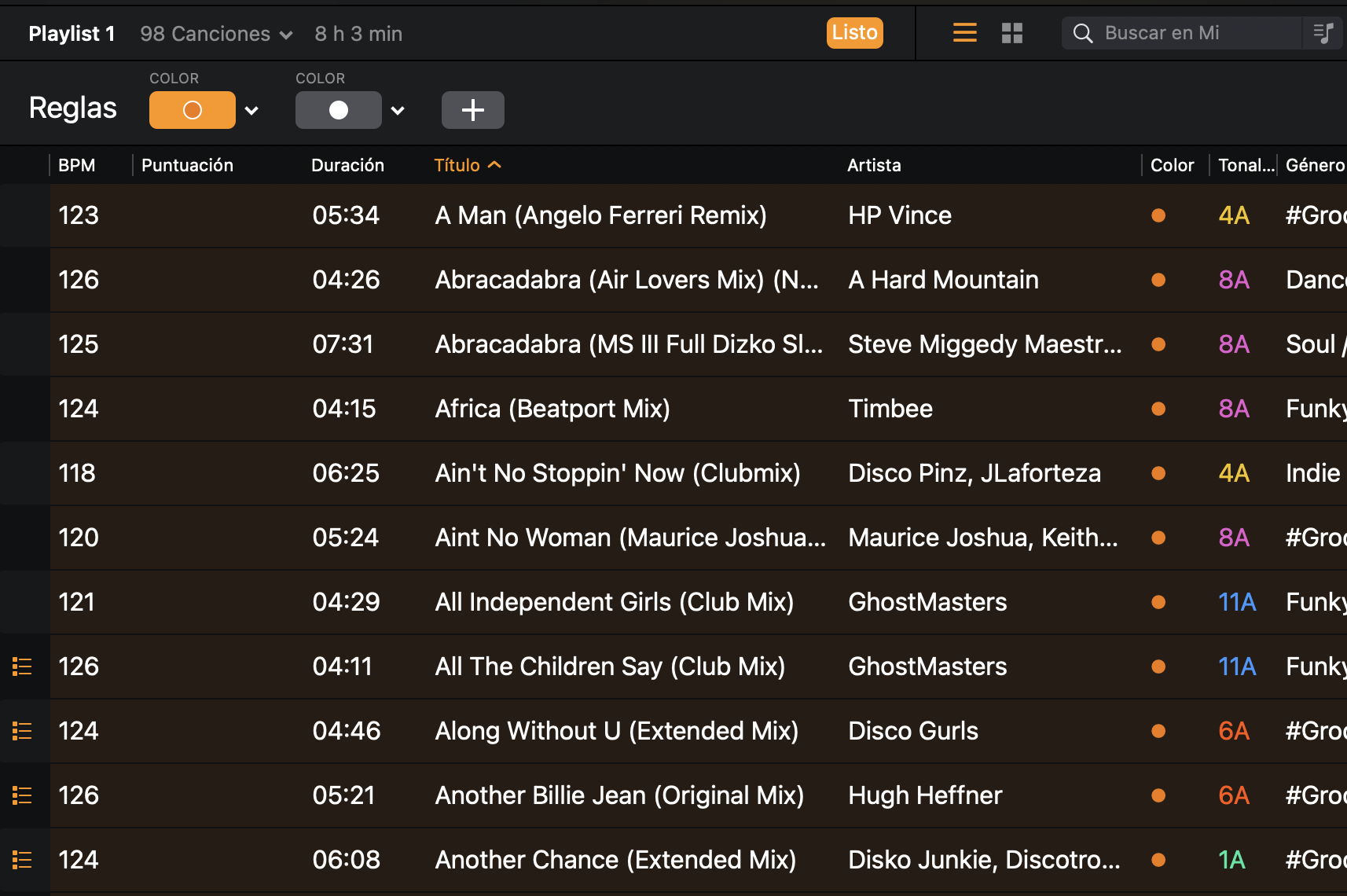

@Mauri_Moore please make sure both criteria are turned ON with the orange background like shown in my previous screenshot, not like the one below.
Both are ON , if i Turn OFF one criteria it works , but not 2 at the same time .

I’ll need to confirm with the engineering team, but it appears what is happening, is that djay is only showing tracks that contain both Groovy and Mixtape in each track. Not tracks that contain Groovy and not Mixtape plus tracks that contain Mixtape, but not Groovy.
BUT : also happens when you try to do a PL with 2 genres as you can see :
Yes, I believe this is expected behaviour. With that criteria, djay is looking for tracks that contain BOTH of the colors. Not tracks that contain one AND/OR the other.
