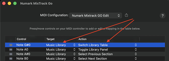

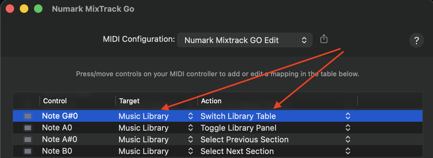

Hi @Ramon_Richie, the MIDI command you are looking for is called Switch Library Table. You need to set the Target → Music Library first. If the Side Panel is already open, you should be able to toggle into the side panel using this command. I just tested this on macOS and it seems to work fine. It’s possible, however, that this isn’t currently supported on iOS. I’ll try to check and test later today to confirm.
This is what it looks like on macOS, but it should be pretty similar on iOS.
