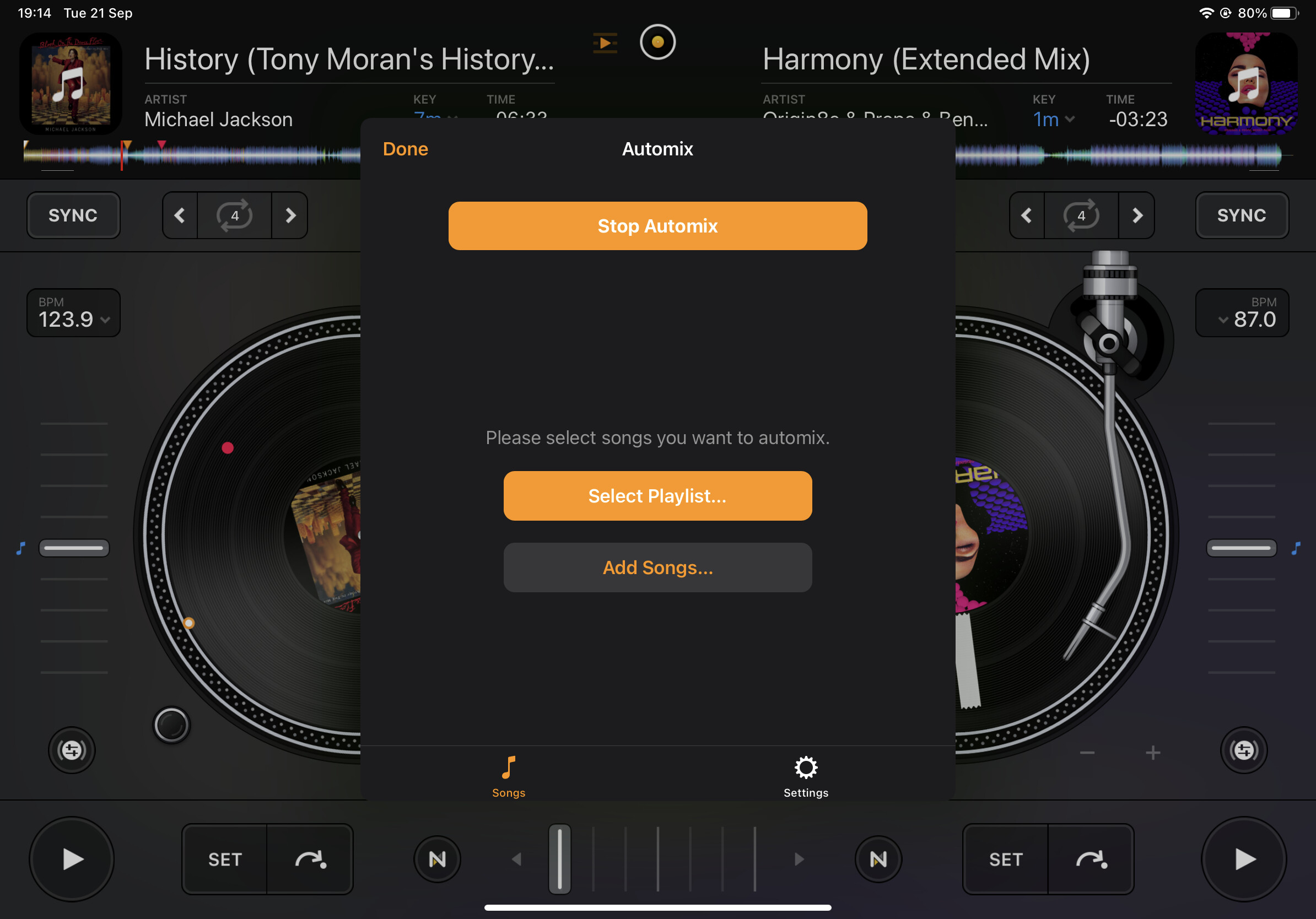

Sussed it… if you use auto mix and add a Playlist, then it does what you say, it adds the songs back to the bottom of the list. But if you don’t select a playlist and instead, do Add Song, then you can select a playlist and click select all. This will play all the songs and after each song It will remove the songs providing you have selected remove songs played in the library section. Once it gets through all the songs, it stops.
Where is “Add Song” once you have the Automix window open?
I appreciate your input but this all sounds very convoluted doesn’t it.
Click on the circle that has 3 lines. The attached screen will come up. Select Add Songs. Then a new screen will appear, find the songs you want to play, if you want everyone, do select all but alternatively, select just a few.
Hi.
I appreciate the effort but this “Add Songs” option isn’t in the OTHER AutoMix that uses the actual decks (The one below the orange AutoMix option) (To the left is REC and to the right is Settings)
It is on mine, this is what I get when I select the orange button between record and settings.
Maybe it’s because I have the taken up the option for the annual subscription. So I have the pro version.
