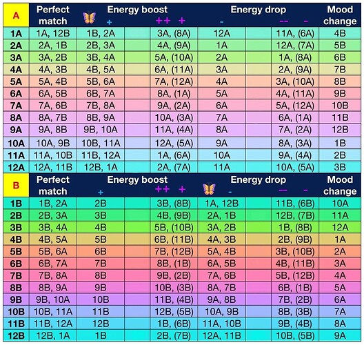

There is so much room for improvement in the Related Tracks and Match features. Key matching is currently very basic and limited to adjacent keys. Having other options would also be welcome. I am attaching a table listing the possibilities offered by harmonic mixing. It would be great to have these suggestions directly in Djay.
This is great, @Chapalo!
I use a similar kind of cheat sheet myself, it’s super helpful, and honestly, this kind of thing should really be built into the software (like RB, VDJ, Traktor, or Serato already do).
It’s such an easy feature to automate, and there’s clearly a lot of demand for it. Yet here we as djay users are, still relying on something as analog as a cheat sheet to get by :thinking:?
Hopefully one day we’ll laugh about this :joy:.
If the day comes that djay implements this, I’d personally recommend using different colors to distinguish between the types of matches (perfect match, energy boost, energy drop, mood/scale change, diagonal.)

Here you find the official match-criteria right now that @Slak_Jaw once did post me:
:folded_hands:

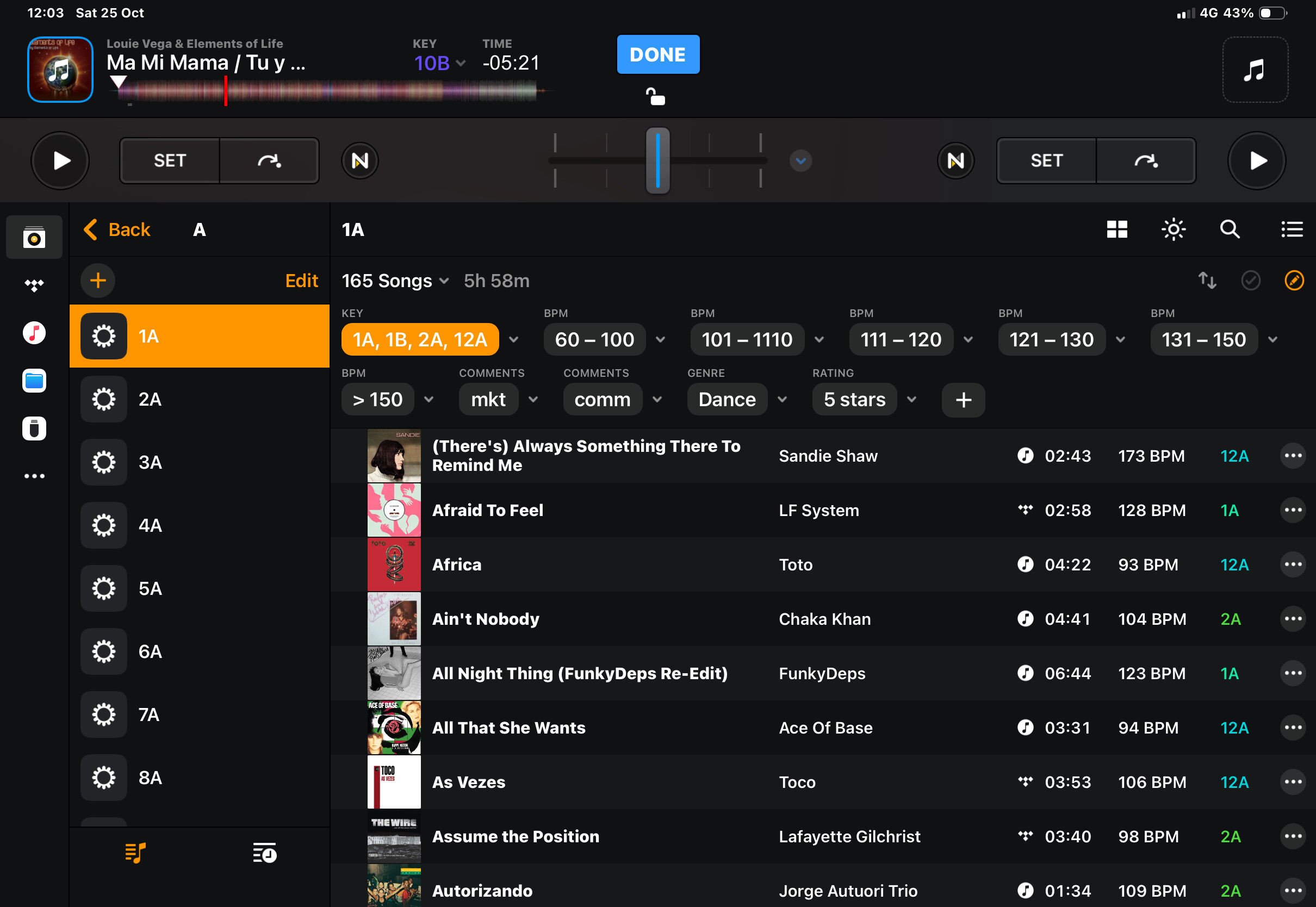

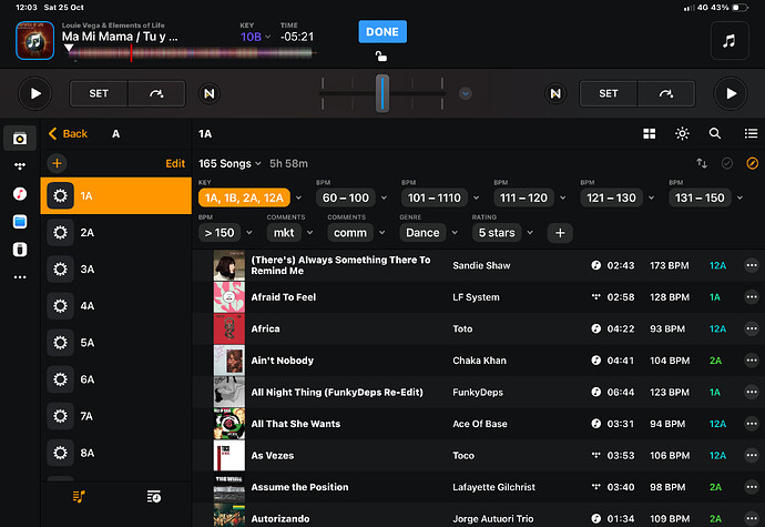

With algoriddim not being the most responsive to requests and suggestions I decided to created my own match playlists using djay’s filters. It takes about half an hour to make.
Not a solution I know but it is usable and helpful and works better than the current match feature.
Thanks for the chart @Chapalo. Think I’ll make an energy boost folder too.
