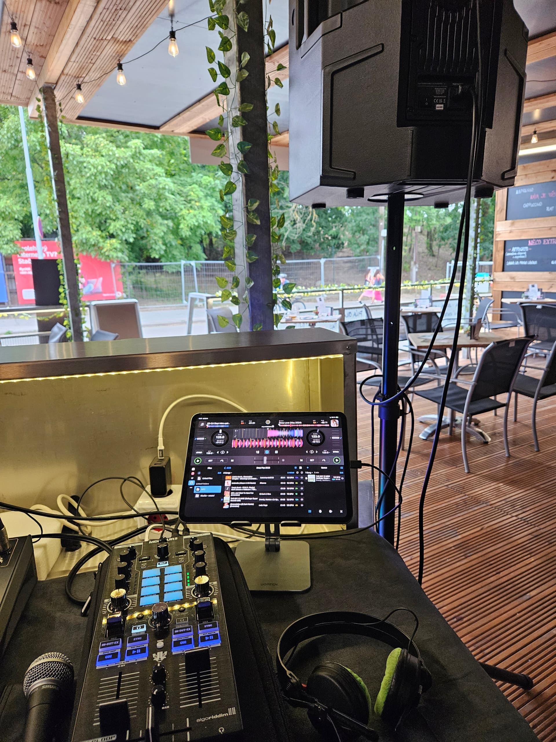

  1. Please confirm exactly how you connected everything to your iPad and Mixtour Pro (some photos would be great).
  • give me a email pls - i will send to you photo

It’s hard to tell from the photo, but that USB-C cable from the iPad to the Mixtour looks pretty thin and low quality. I would definitely try testing with a properly shielded cable.
I will try another cable. But personally i dont think cable is problem because 3 hours djay works without any issue and than start slow and lag until djay is unable to use.
But thank you so much for help! :slight_smile:

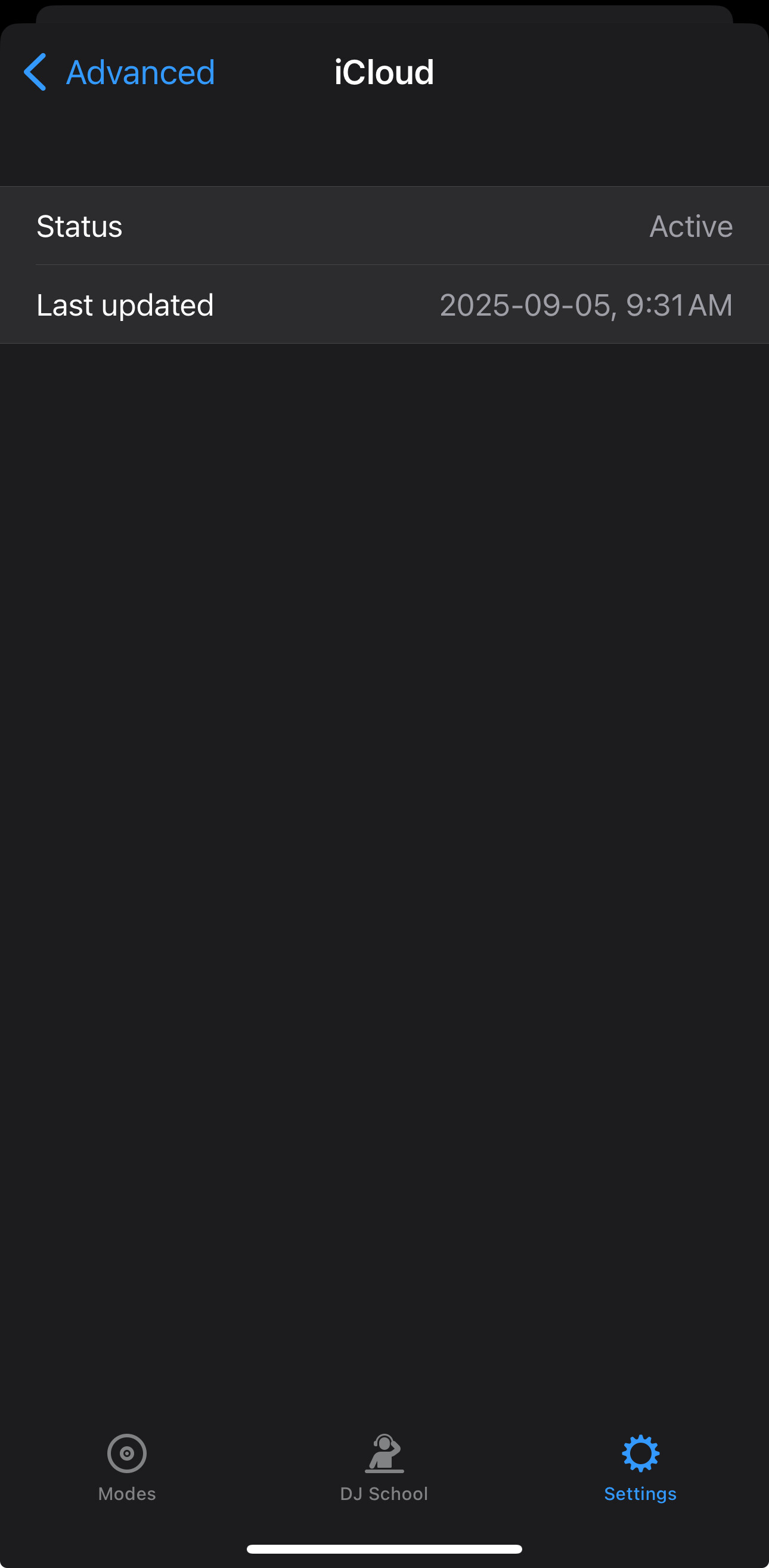

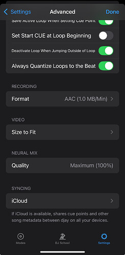

You’re welcome @Djslepi. Can you please also confirm if you have iCloud Syncing enabled in the djay settings?
I just used the same hardware (iPad Pro M4, Mixtour Pro) to provide sound for a private birthday party over the weekend, with a Wi-Fi connection, local music, and streaming. There were no problems whatsoever during the entire 10 hours. So I don’t have any good ideas about what your problem might be, but I think it’s due to the individual setup and not the iPad in general.
