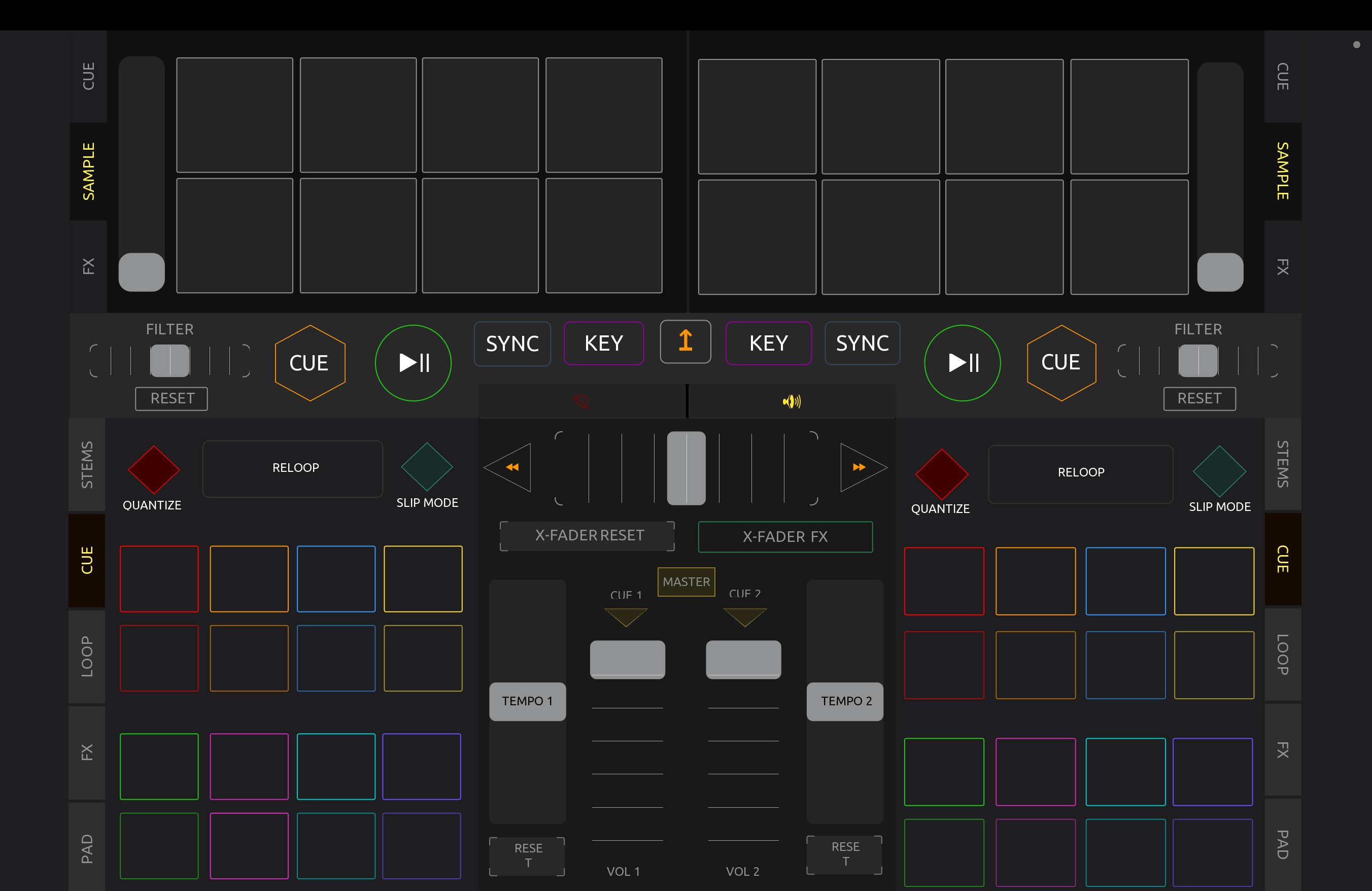

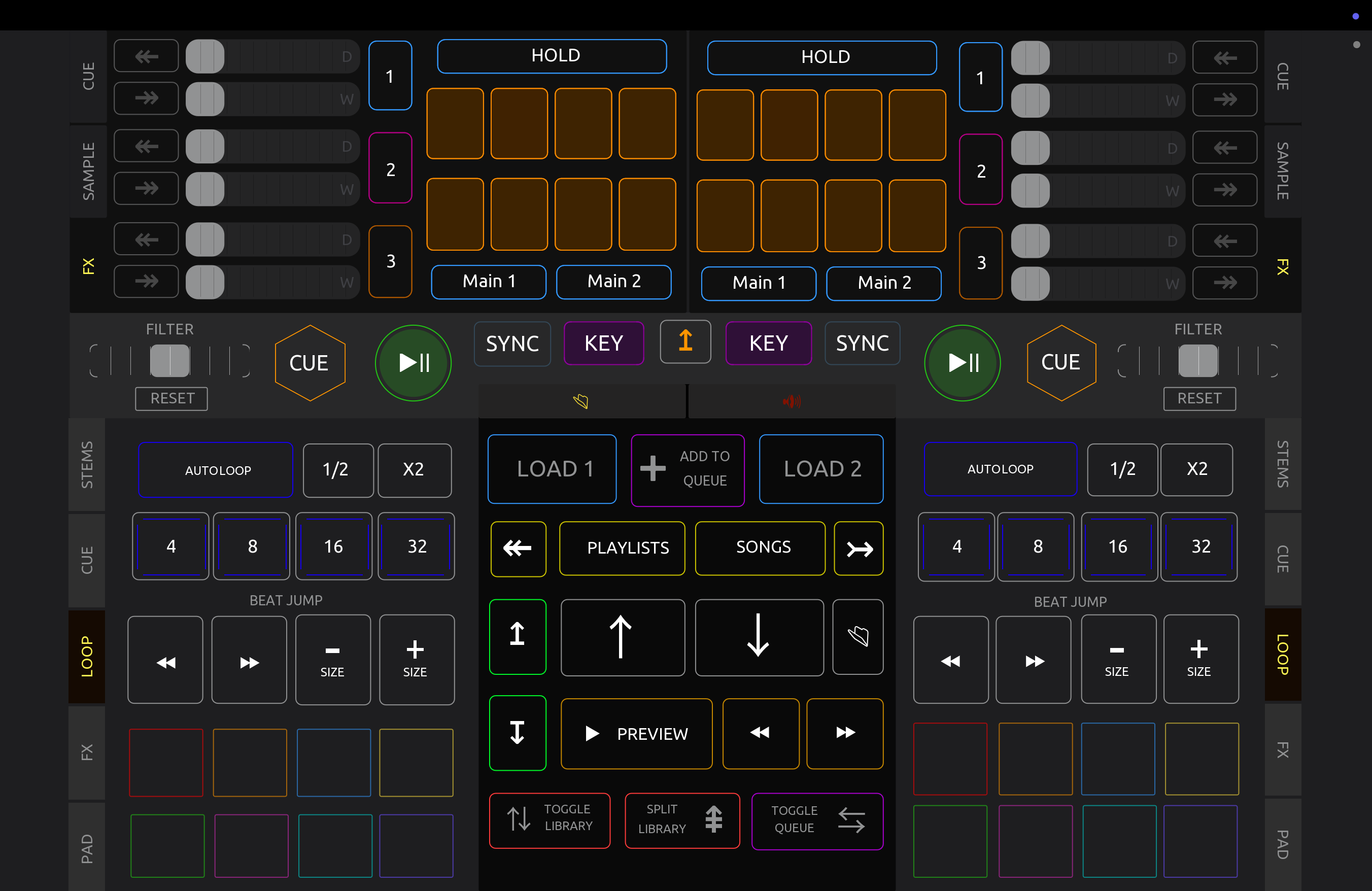

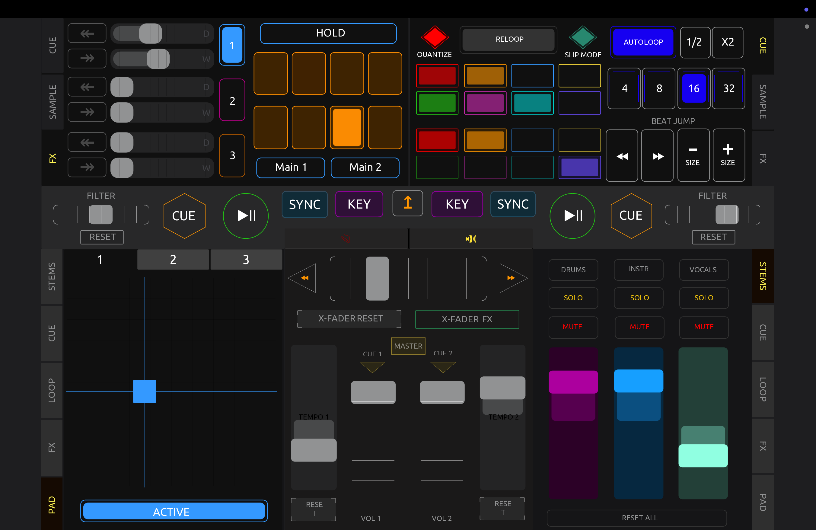

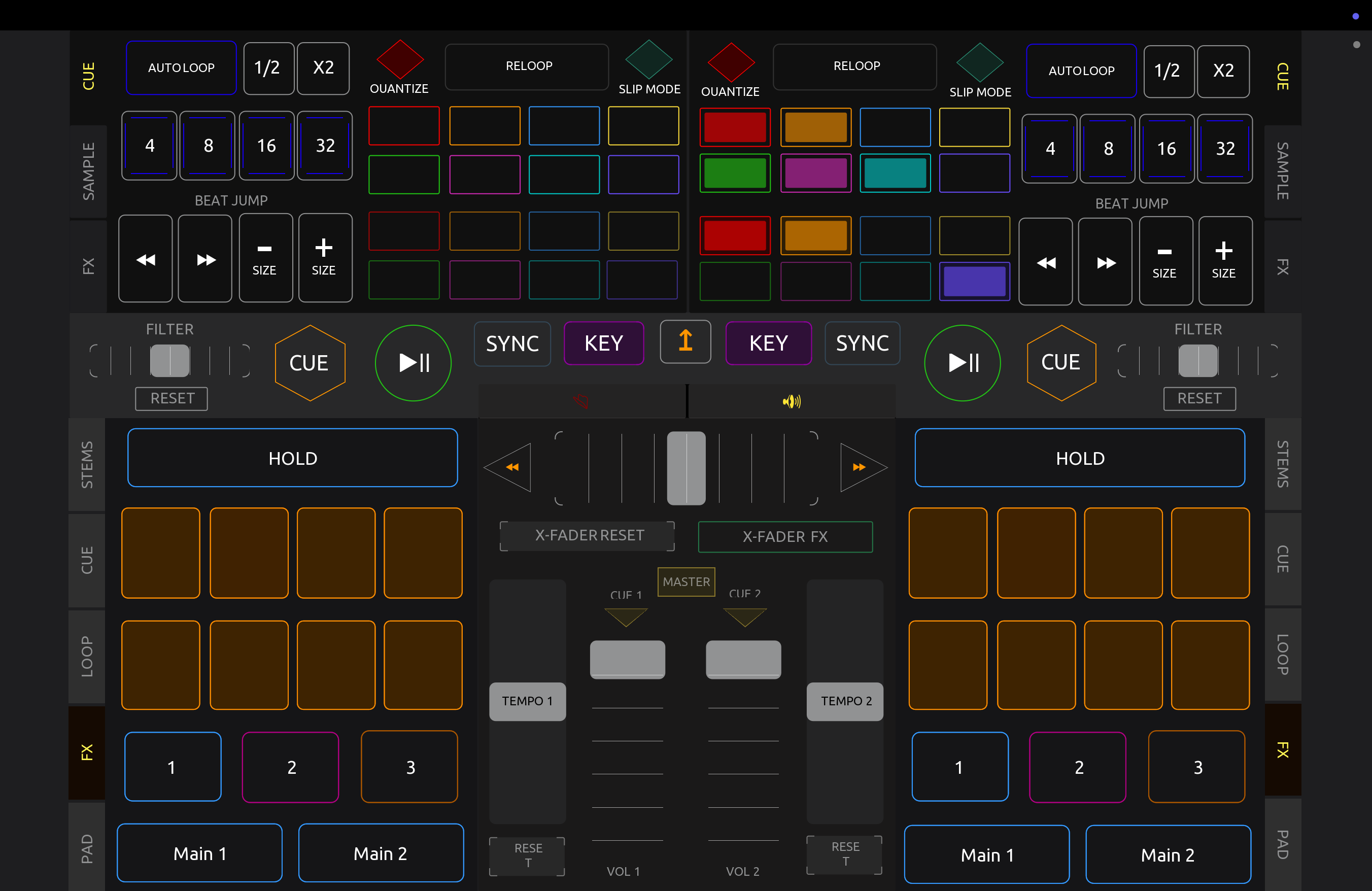

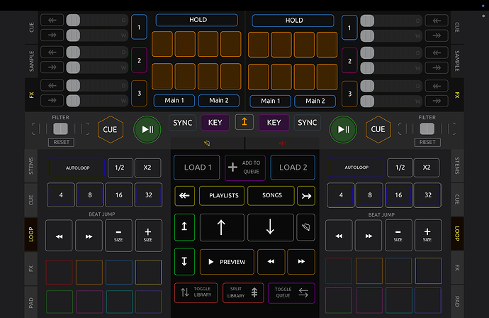

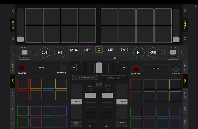

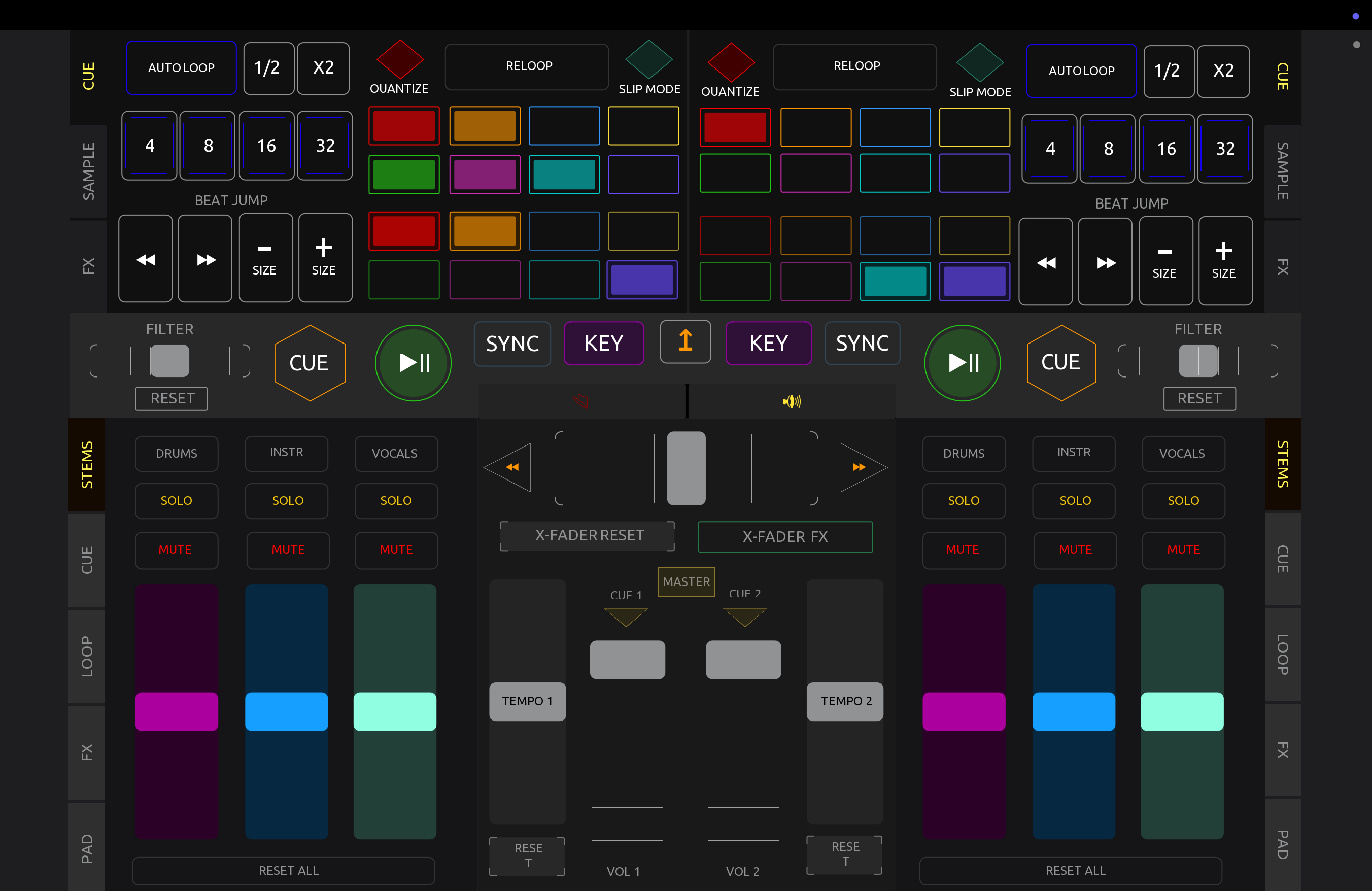

Here’s an updated controller for most functionality for the MACOS version of DJay Pro - see the screenshots below the post…
This works in Touch OSC by Hexler LLC - the paid version (not the MK1 app - I am unsure if it works in MK1, not tested)

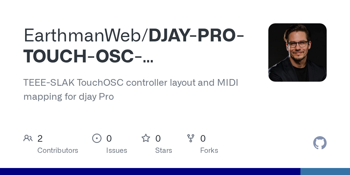

You can download the latest version of the .tosc and the midi mapping file from Github at this link:
Note: The /scripts folder (and .gitignore) file are not required for using this, they are there for visibility purposes only
No warranty intended or implied - this is provided for educational purposes only

There are a few things that I had to introduce as workarounds, for getting all of the color feedback to work properly, I think it turned out well.

I can use this now as a standalone, but I also have been using this along with my DDJ-Flex2 and DDJ-XP2, as it gives me Touchpad FX which the others don’t have, and quick access to Library functions. I have those mapped elsewhere in the XP2, but the visible buttons are nice!
