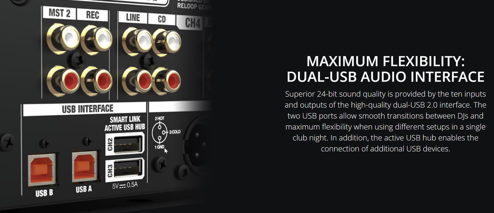

Hi @Edg1983, welcome to the Community! My main recommendation is that you use high quality USB cables with dual ferrites on either end and a high quality, powered USB-C Hub from a reputable brand.
How many USB C ports will I need on the hub? Thanks
You will need at least 3 USB ports to connect the RMX95, and 2x LC6000’s to your iPad. You might be able to connect the LC6000’s to built-in USB hub on the RMX95, but I suspect everything will work better with a powered USB-C Hub. Either way, I don’t think the RMX95 will charge your iPad when connected via the RMX95 USB-B ports, so you’ll want the powered USB-C hub for iPad charging. I recommend you reach out to Reloop Support and ask first if you want to be sure before buying the hub. I hope that helps!
