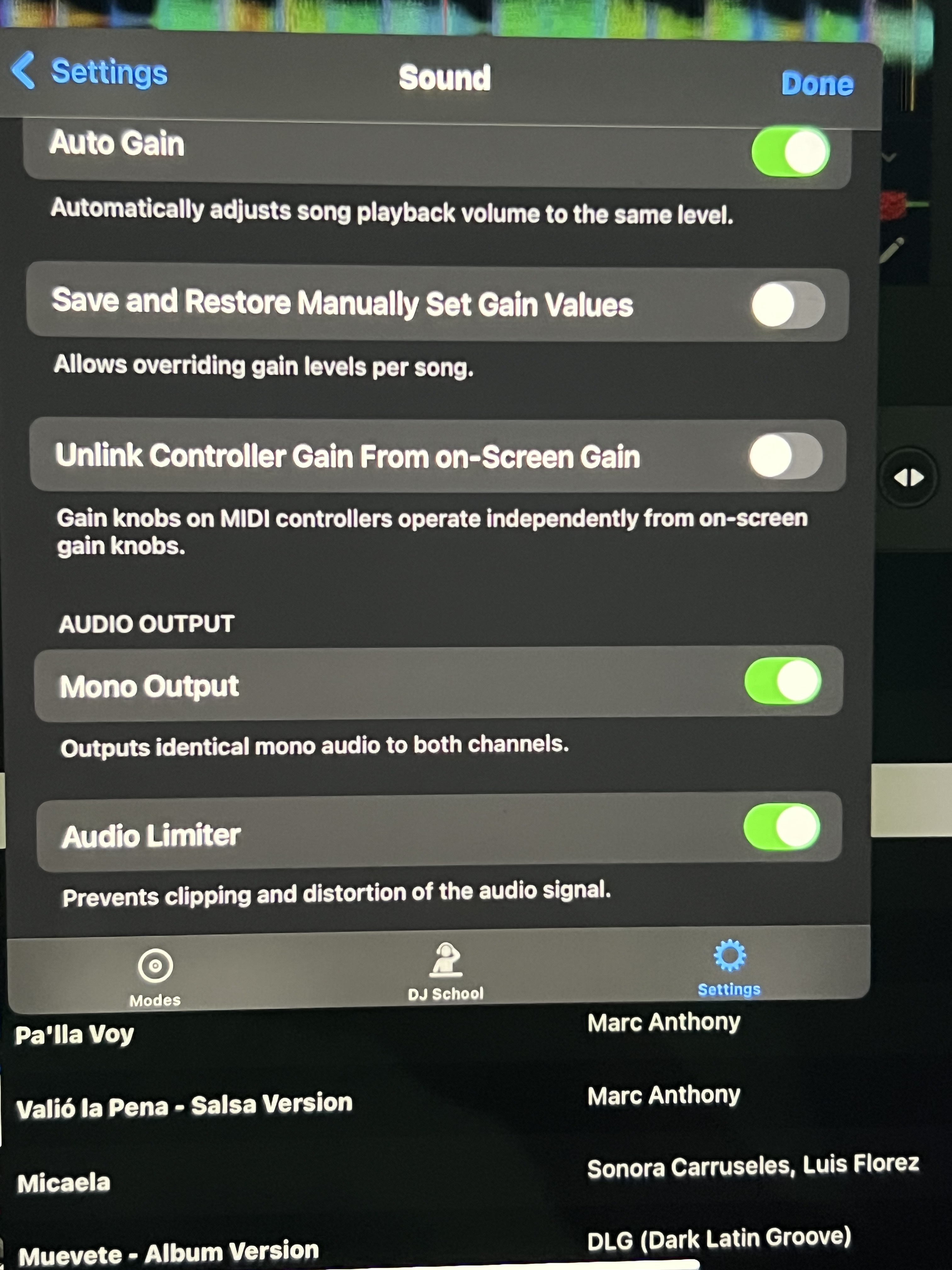

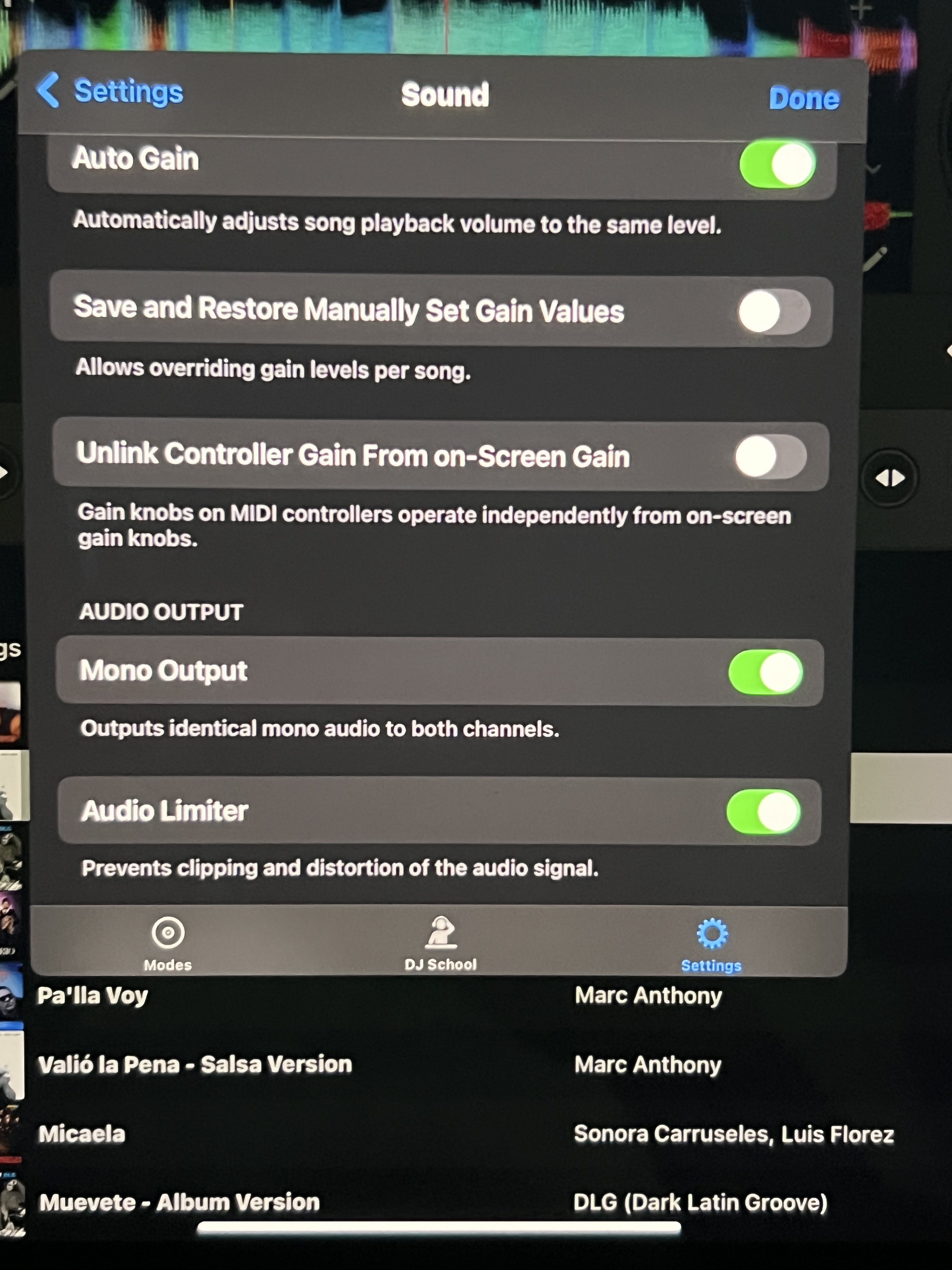

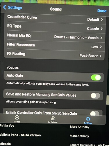

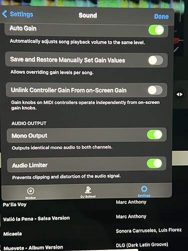

Thanks @illya_kroon, can you please share another screenshot of your Auto Gain settings?
Hi Slack Jaw.
Thank you @illya_kroon
