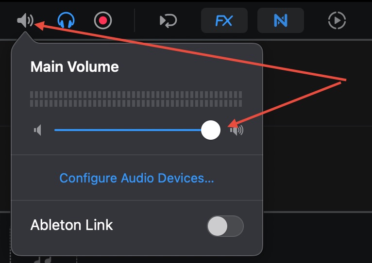

  1. Can you please confirm that the Main Volume slider in djay is also set to maximum when your hardware is connected?

  1. The volume slider disappear when connecting to djm a9 on external mode
