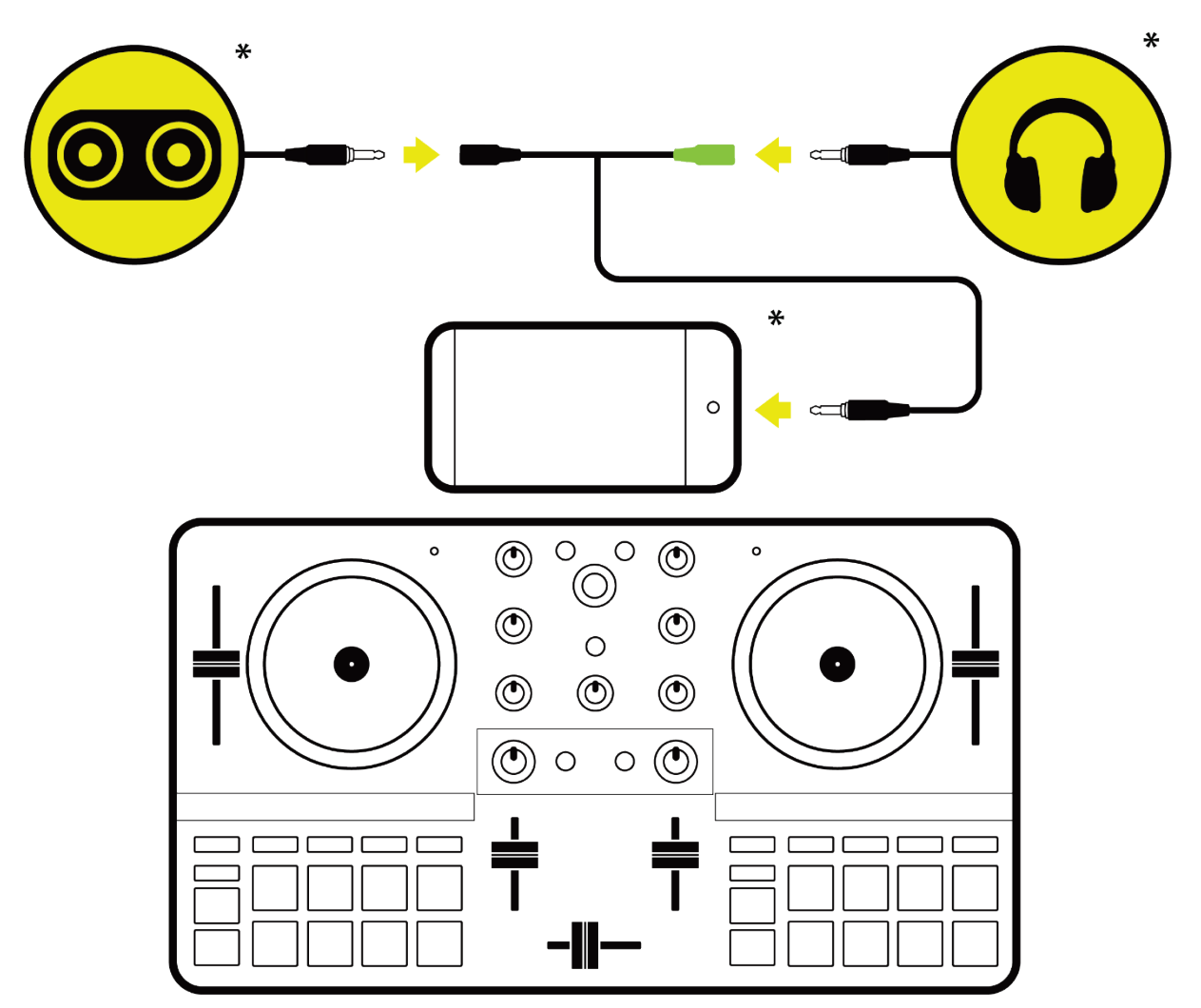

  1. My setup:
    • Controller: Hercules DJControl Mix Ultra (Bluetooth connection)
    • App: djay by Algoriddim (using the Spotify library)
    • Tablet: Lenovo Tab M11 (Android)
    • Speaker: JBL PartyBox Encore
    • Audio connection: tablet jack output with a split cable (master to the speaker / cue to headphones)
    Since the controller is Bluetooth-only and doesn’t have a built-in sound card, the audio comes directly from the tablet. To be able to pre-listen in headphones, I’m using a split cable on the tablet’s jack output.

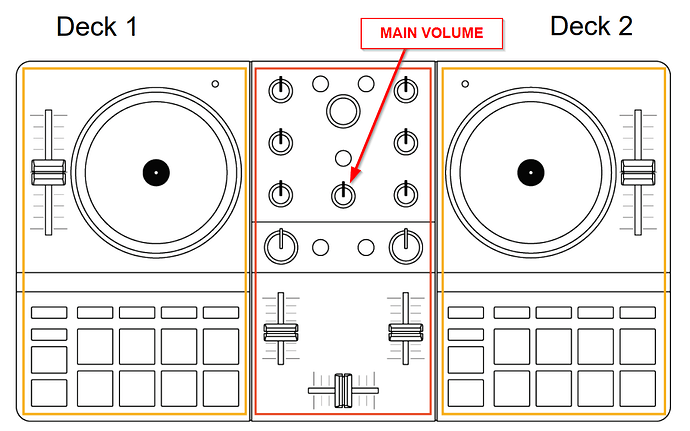

  3. Is the Mix Ultra Main Volume knob turned up?

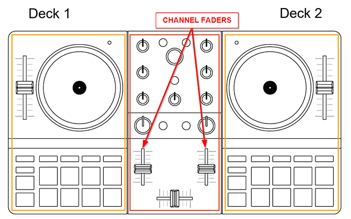

  4. Are the channel faders for Deck 1 and Deck 2 on the Mix Ultra both set to maximum?

  6. Are your headphones connected to the green end of the splitter cable and your speaker to the black end?
Yes of course, because the split cable is taking half the signal (one channel) and feeding it to your headphones. A direct connection is feeding both channels (left and right) into the speaker.

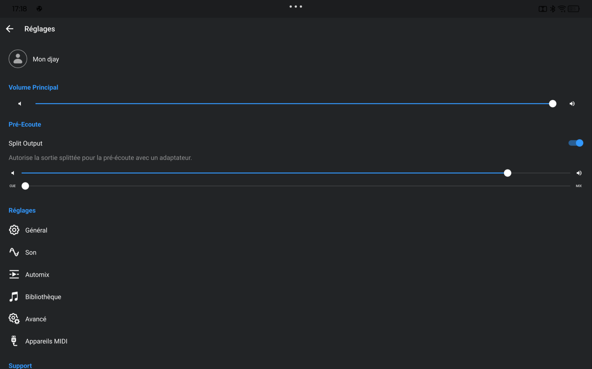

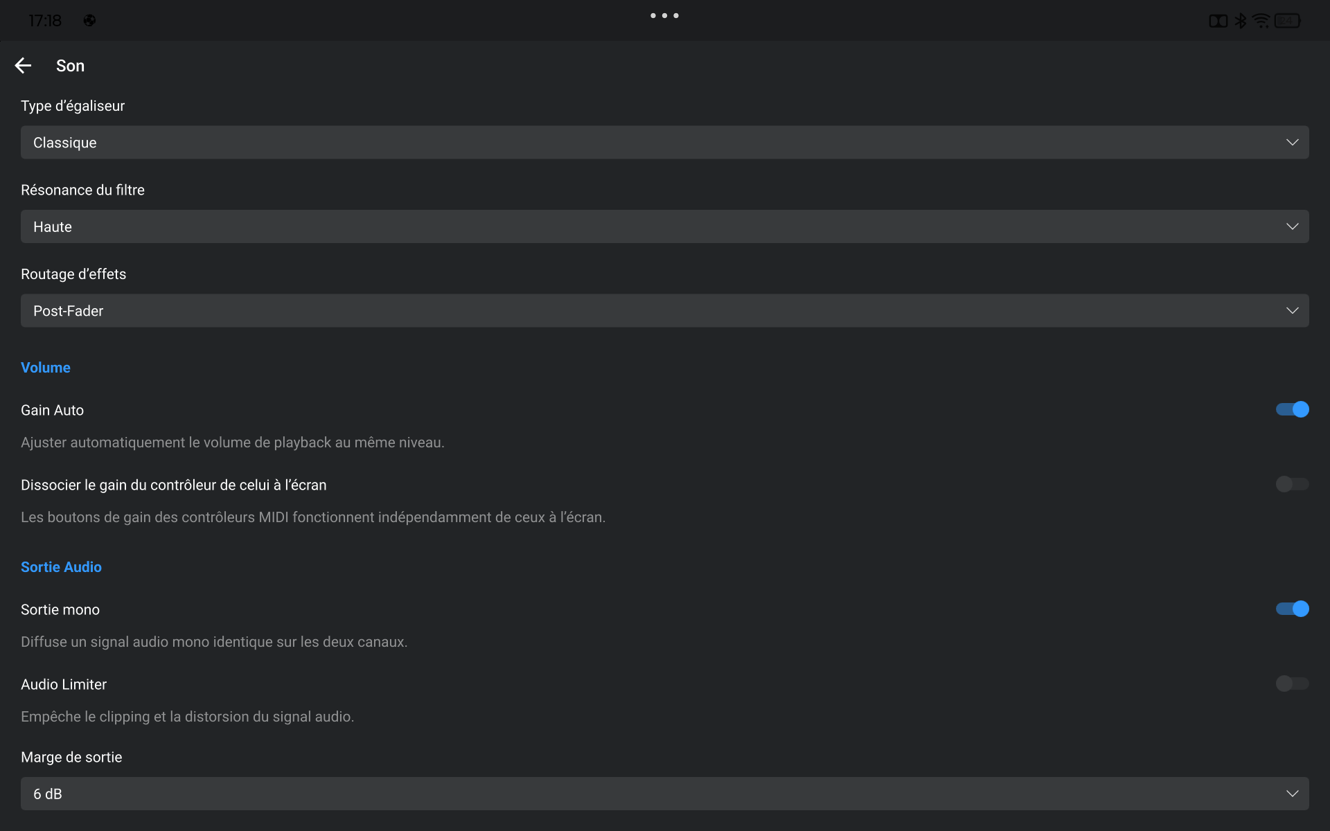

It would be really helpful to see what your Audio Output settings are. In particular your Audio Limiter and Output headroom settings.
Hello, thanks for the idea, i Tried but there was ni sound at all in the guitar input…

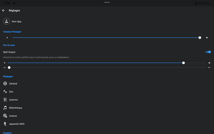

Hello sorry for the delay … This is the set up of Djay. Sorry its in french
Version of os: android 15
Version of djay : 5.6.3
Idk for the hardware
firmware version
From your points 1 to 6 , the answer is yes
Your settings look good @LowProfile_59. I can’t think of anything to suggest other than trying a different splitter cable and different audio cable.
