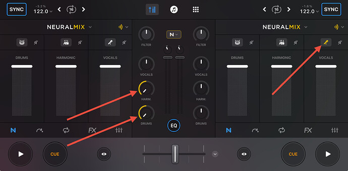

Hi @boing, I think you could definitely do this with djay. Personally,
  1. I’d load your house track on Deck 1 and the first of your 40 songs on Deck 2. Manually beat match or sync your Deck 2 song with Deck 1.
  2. Turn your Deck 2 song into an acapella using Neural Mix EQs or the Vocal Solo button
  3. Create a Saved Loop for the 10 seconds (I recommend 32-64 beats to maintain phrasing) of the track you want to use in your mix.
  4. Create Saved Loops for the rest of the 40 songs.
  5. Then with your house track playing, start experimenting with different orders for the songs to figure out what works and sounds best.
  6. For best results, try to keep in mind the underlying structure of your house track and mix your acapellas in at appropriate points. If you’re not familiar with musical phrasing, do a bit of research on this. At a bare minimum, align your 32-64 beat acapella loops up with the start of the 32 beat sections in your house track.
  7. Also experiment with different FX like Echo, Reverb and Filters to smooth out the incoming and outgoing transitions for each acapella. I hope that helps!

You’re welcome @boing,
  1. Yes, you will need to load and play each song / saved loop one at a time and essentially back to back while the House track is playing on the left deck. This will likely take a fair bit of planning and practice to get everything to flow together properly, especially with 40 different songs. Challenging, but not impossible.
  2. You will need to engage the Vocal Solo each time you load the next song on Deck 2 to put it into an acapella. Or use the Neural Mix EQs to remove the Harmony and Drums.
