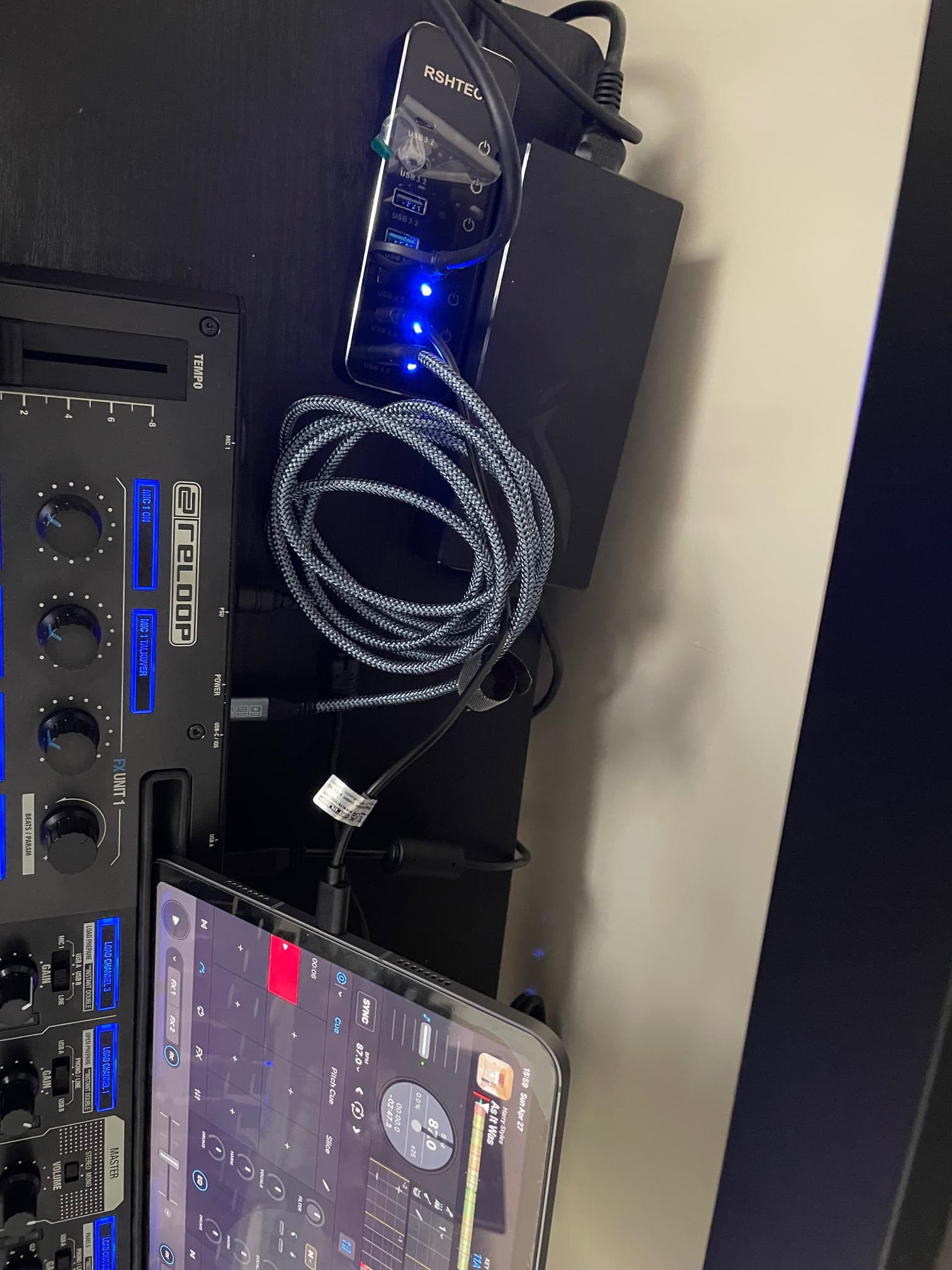

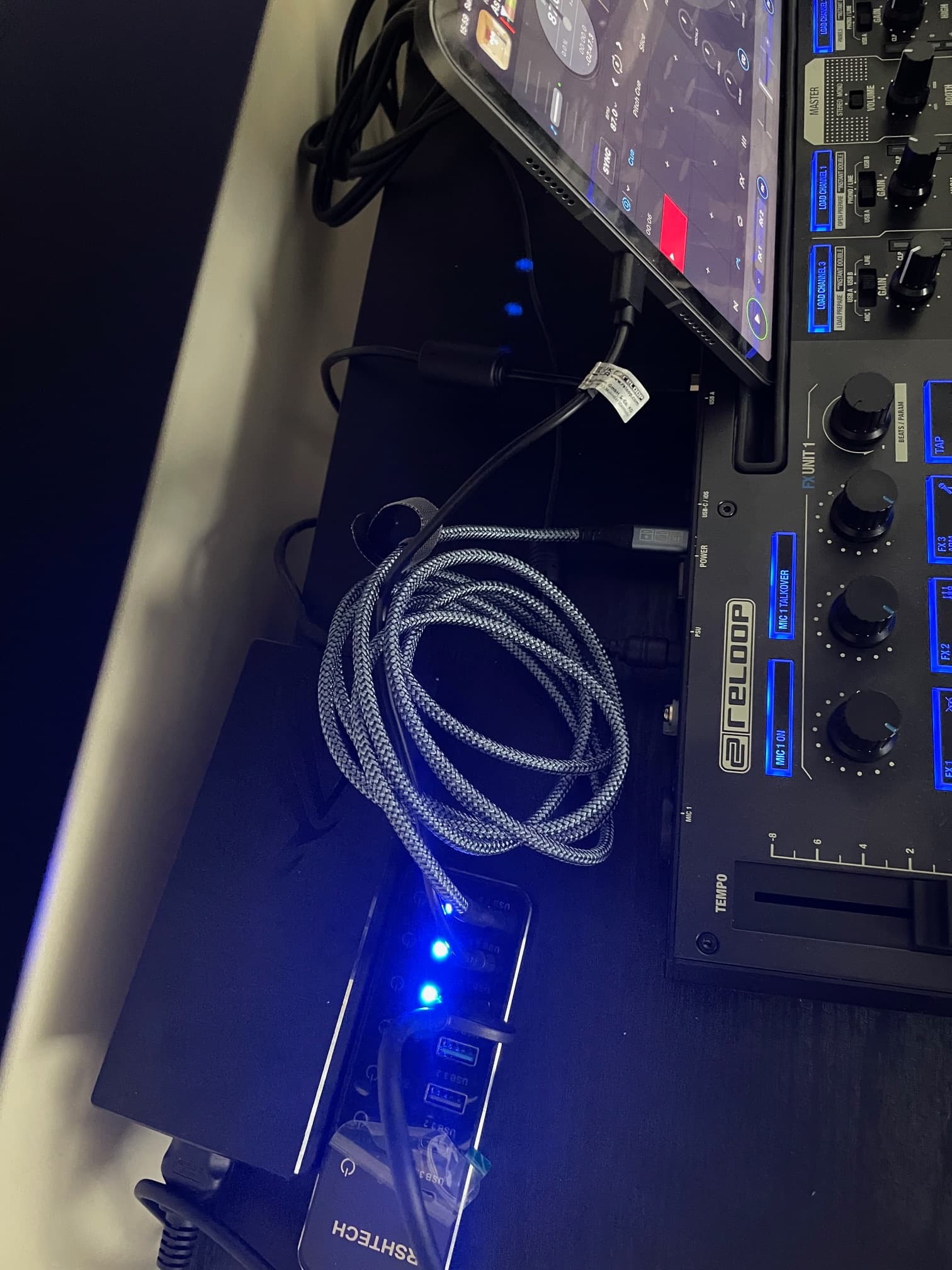

Does it have to be USB A for this to work? Some pictures below you can see I’ve connected the HUB to the Mixon and the iPad to the Hub but the controller is not recognising the iPad/Software is connected in any capactiy

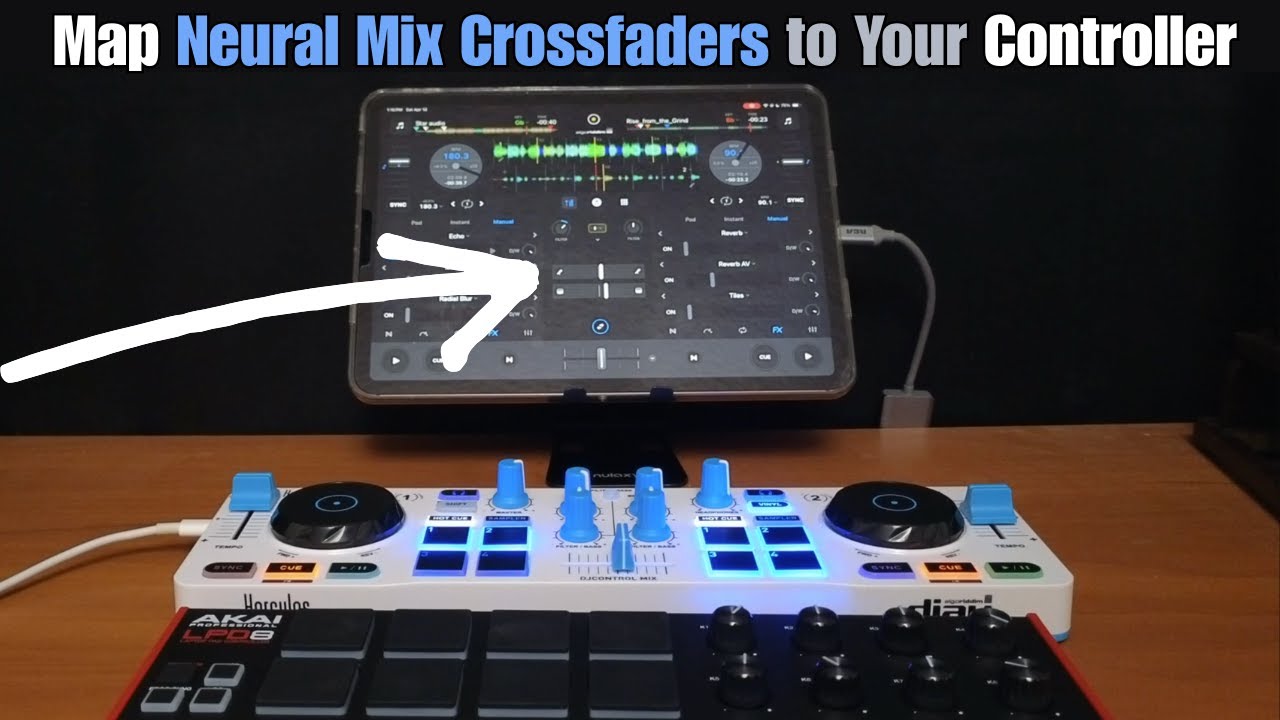

@Slak_Jaw this video for example shows what I’m trying to achieve, just two wired controllers (MIDI controller and Mixon8) rather than the Hercules Bluetooth, is this possible?
Thanks

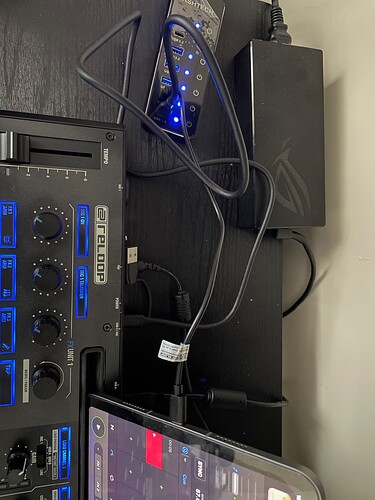

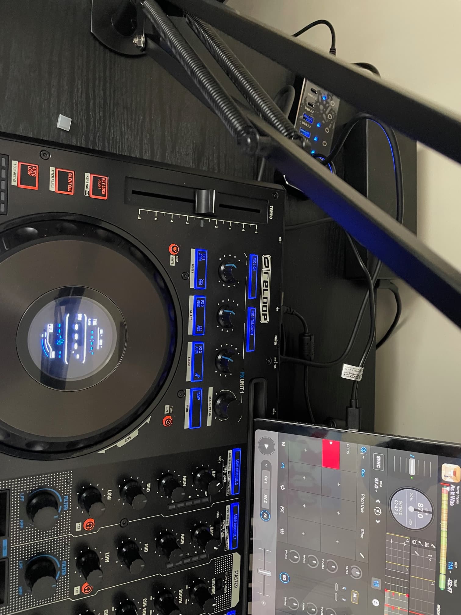

Hi @Cuzer, I would go back to the previous UGreen USB-C hub that you had. That new RSHTECH hub does not look like a good choice to me. Please refer to my photos below.
  1. You need to connect the UGreen Hub directly to your iPad.
  2. Connect your iPad charger and USB-C cable to the USB-C socket on the UGreen Hub marked with PD or a Lightning Bolt. The Blue cable in my picture. Confirm that your iPad is charging before doing anything else.
  3. Now connect your Mixon 8 to the Hub using a USB-B to A cable. The White cable in my picture.
  4. Now connect your second MIDI Controller (in my case the Midi Fighter Twister) to the Hub using another USB-B to A cable. The Black cable in my picture.
EDIT: Also, I am suspicious of those cables you are using. Please note that some USB cables are only for charging and do not transmit data. I highly recommend you use high quality USB cables specifically designed for DJ use. I’m using DJ TechTools Chroma Cables in the pictures above.
