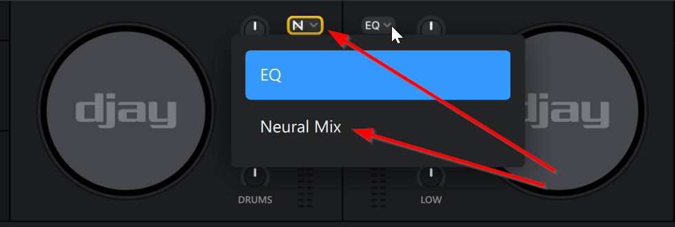

  1. However, you can switch the EQs in djay from normal to Neural Mix and use these to remove Vocals, Instruments or Drums.

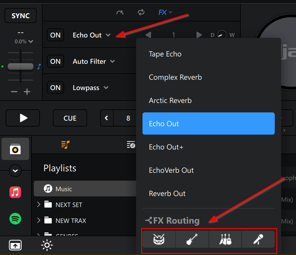

  2. Also, the Manual FX can be Routed to any of the Neural Mix Parts

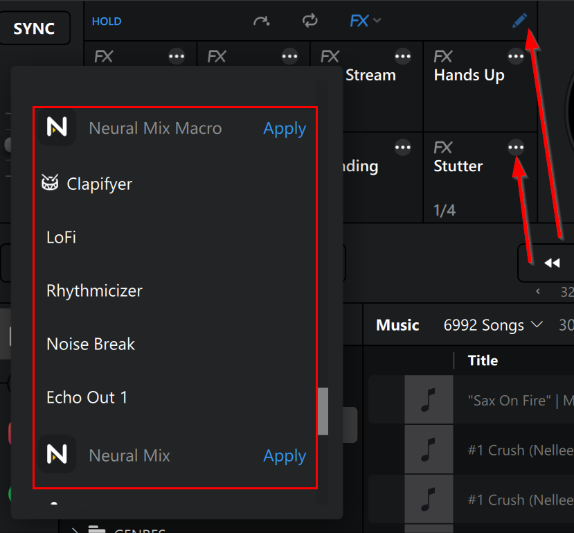

  3. We also have a wide selection of Neural Mix Instant FX located near the bottom of the list.

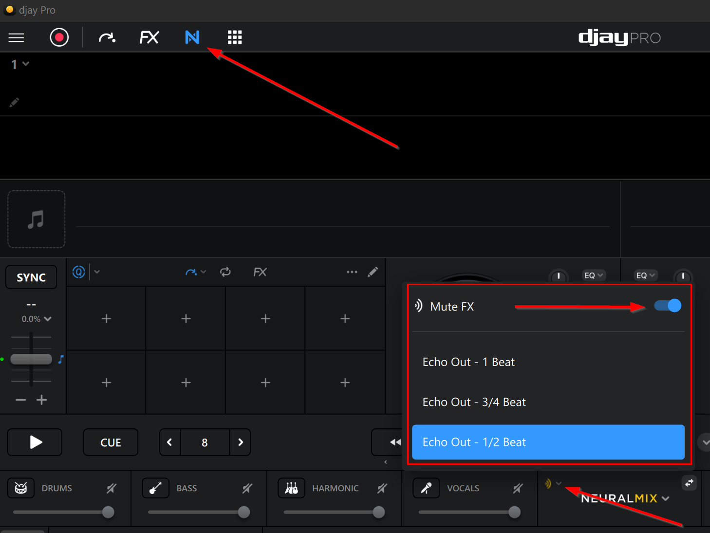

  5. Finally, if you enable the Neural Mix panel in Windows, we also have a selection of Neural Mix Mute FX.
